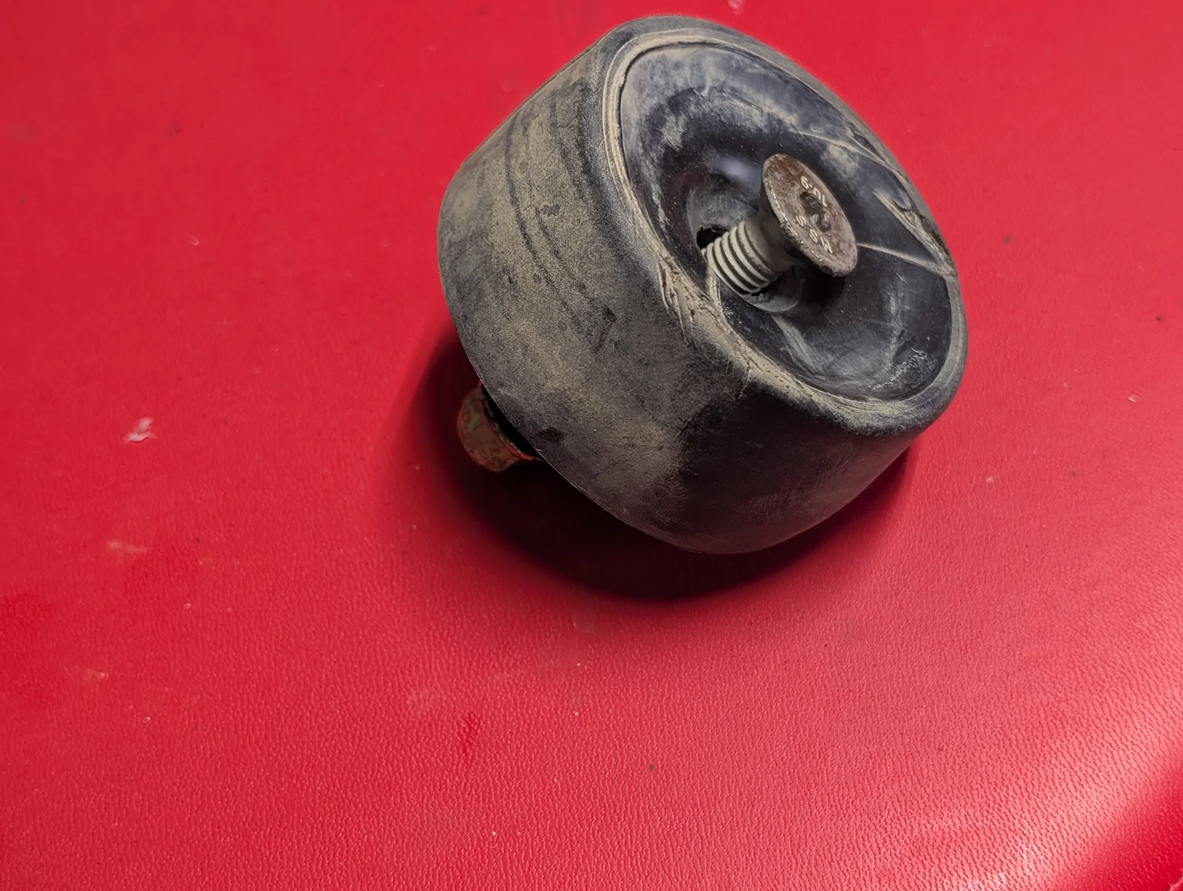

Wondering if the poly terra flex bump stops are a progressive type and what is their total crush height. I want to stop the hard stop that I have with factory bumpstops. .

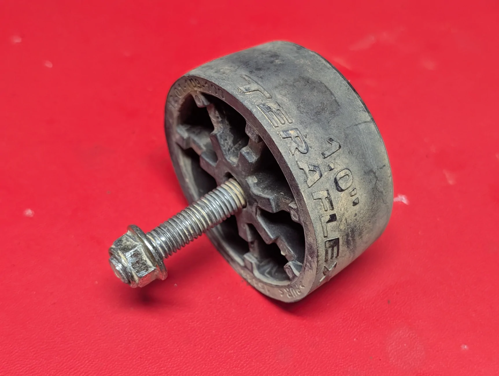

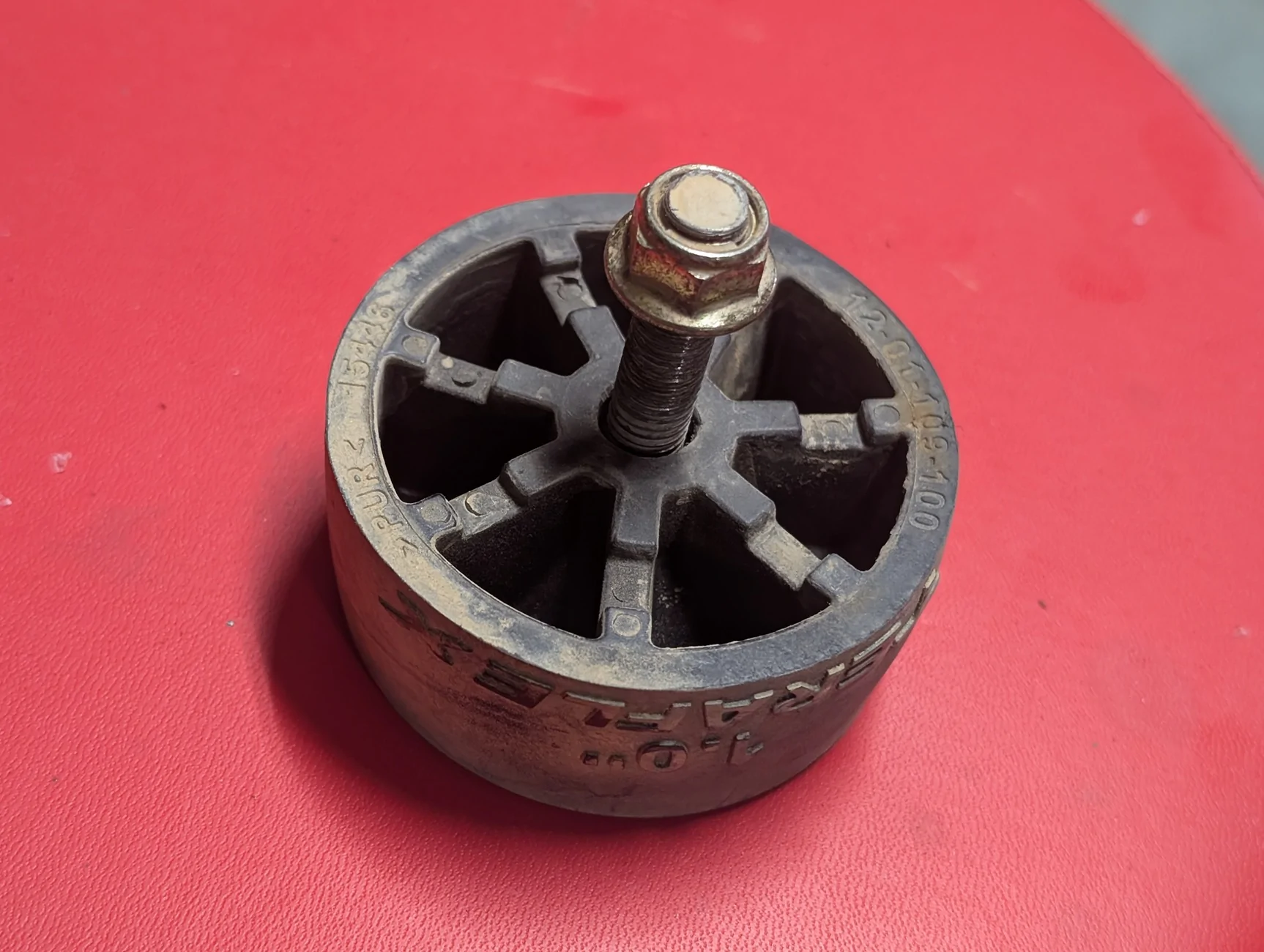

The Teraflex leveler kit that I installed included bump stops. Assuming these are the same bump stops you're looking at, I think they do have some give under pressure. The bump stops that came with that kit were hard rubber (or similar) cups with center bolts. The bolts will allow movement under pressure should the stops compress.

FWIIW, Teraflex does make progressive bump stops that are more robust than these I posted: https://teraflex.com/jt-progressive-bump-stop-kit-front-rear-0-4-5-lift.html , priced at less then half of the hydro style. They also have hydro bump stop kits. Ultimately, you'll need to decide just how much buffering you want and how often you'll bottom out to choose the level of shock absorption at the extreme travel you'll need
