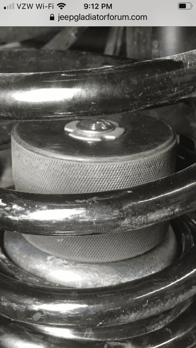

I used carriage bolts with torque washers on them. This locks the carriage bolt into the top puck. I then used an oil filter wrench to tighten them while just holding a wrench on the nut on the bottom.
