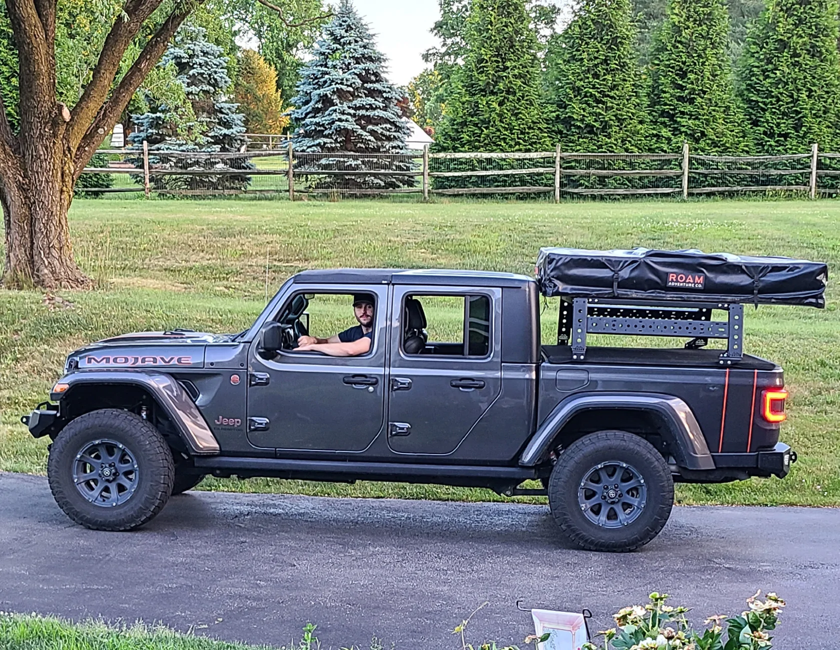

Responding, Airlift bags in rear on the 21 Mojave; Voodoo Rack and Roof top tent (200lbs).. Run at 5-10 psi to level out and not have to re-adjust headlights. Ride is great. Level too.

We have no other lift items.. all stock except for the Airlift bags in the rear. With 5-10 psi the goal was to keep the headlight aim at the same as before the tent is on.. IT stays on now year round, here is a photo with the Roam Adventurer 2 person tent for 1 year -- heading out.

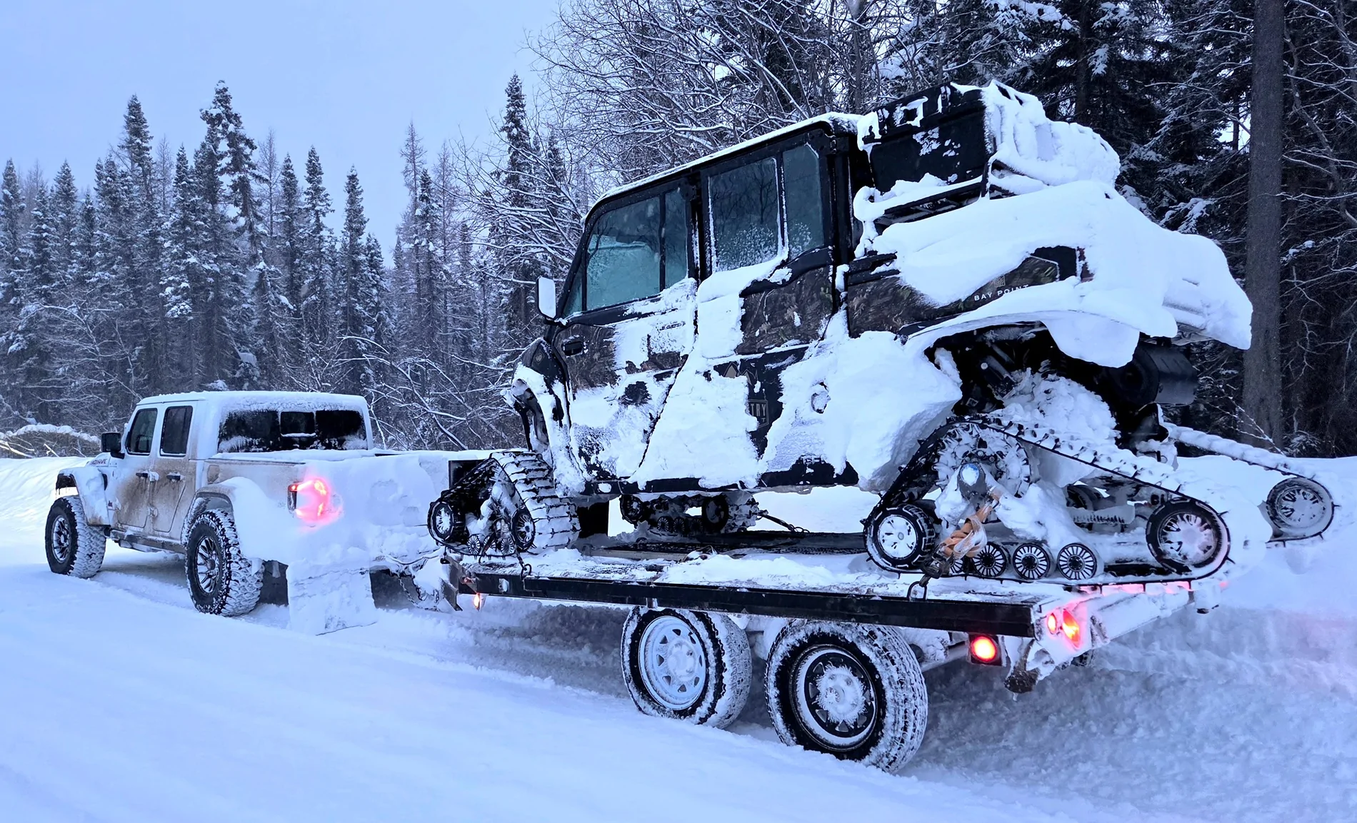

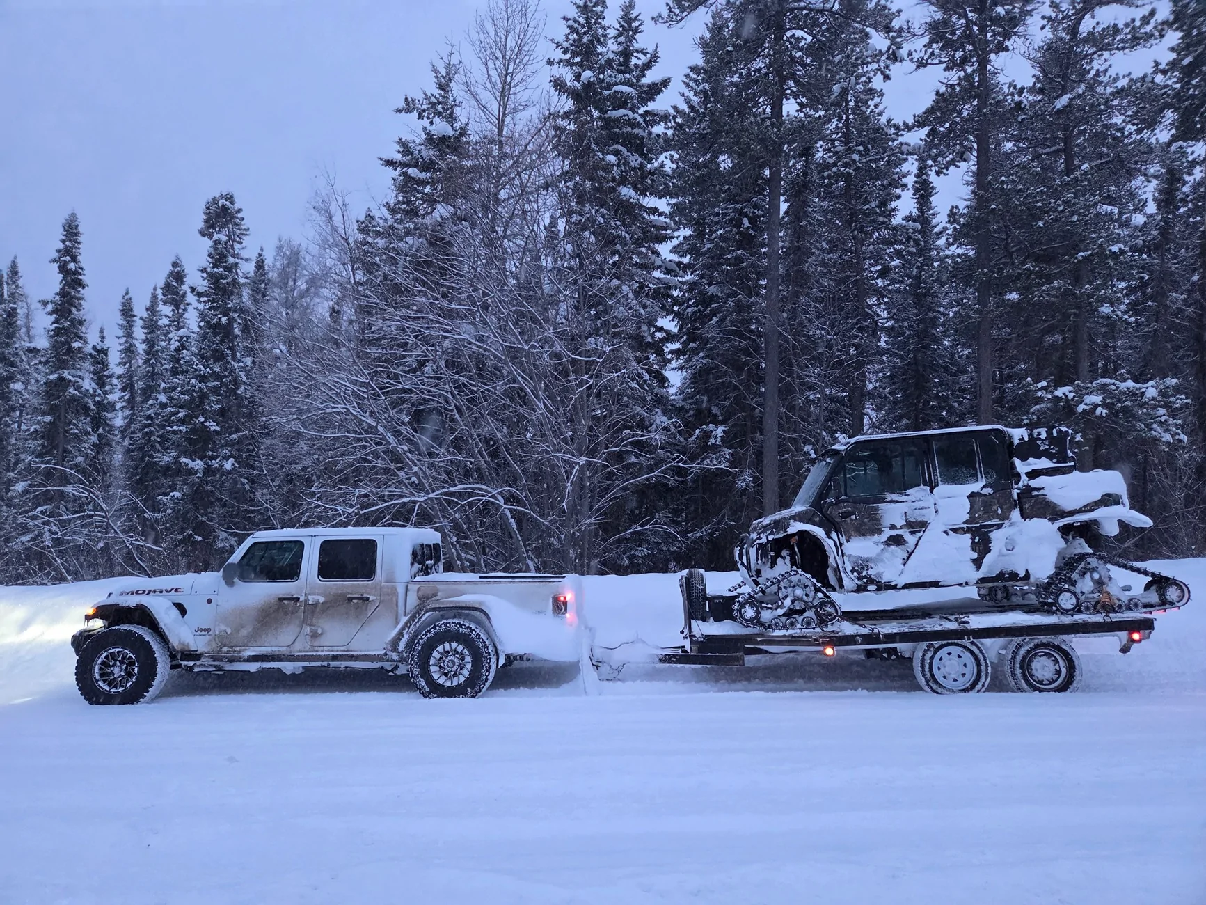

I tow my sxs in the winter, quite a bit so need the air bags. They go on next week. Gonna need them and quick... haha. This was yesterday.
