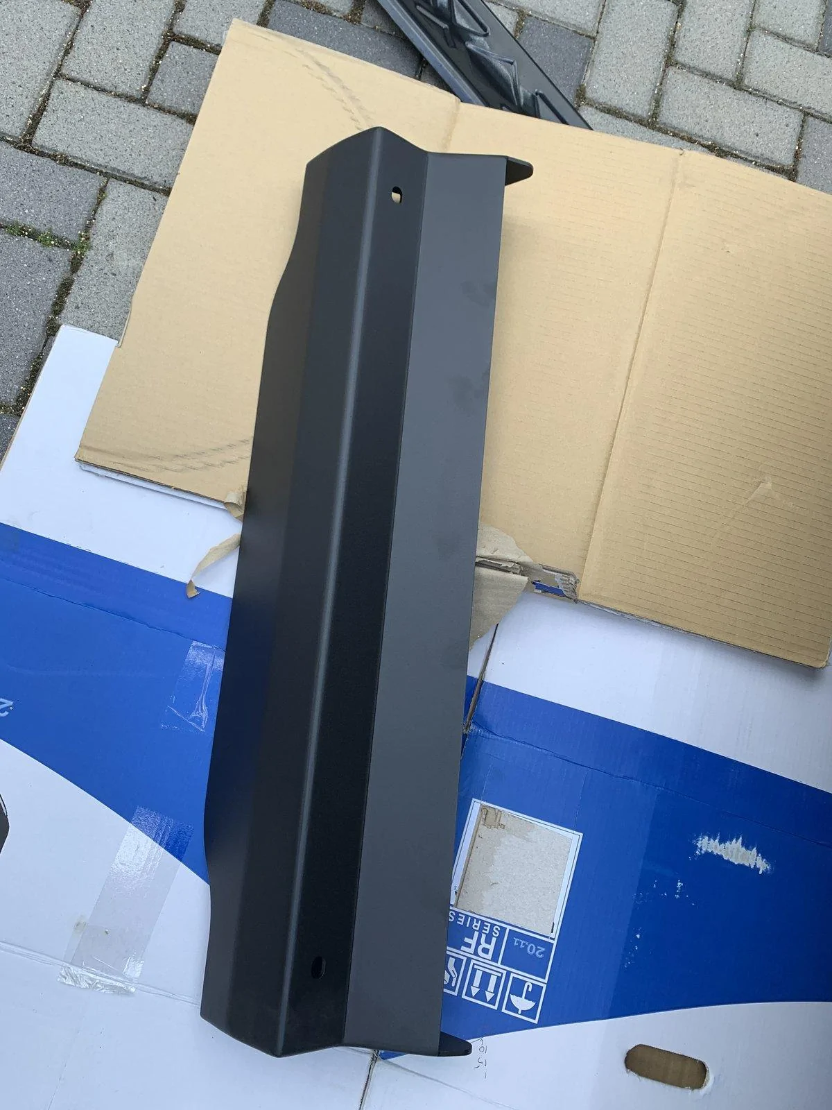

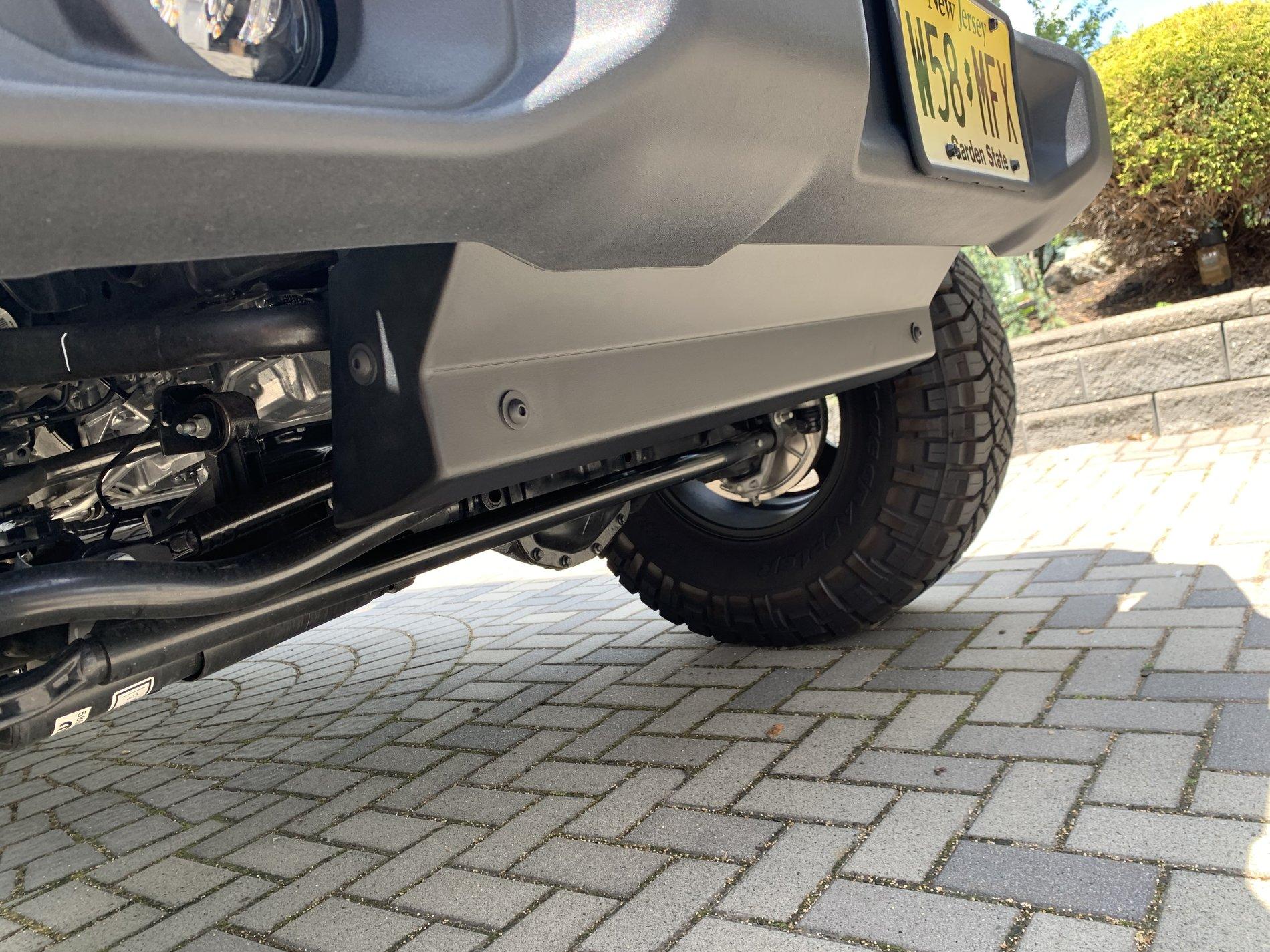

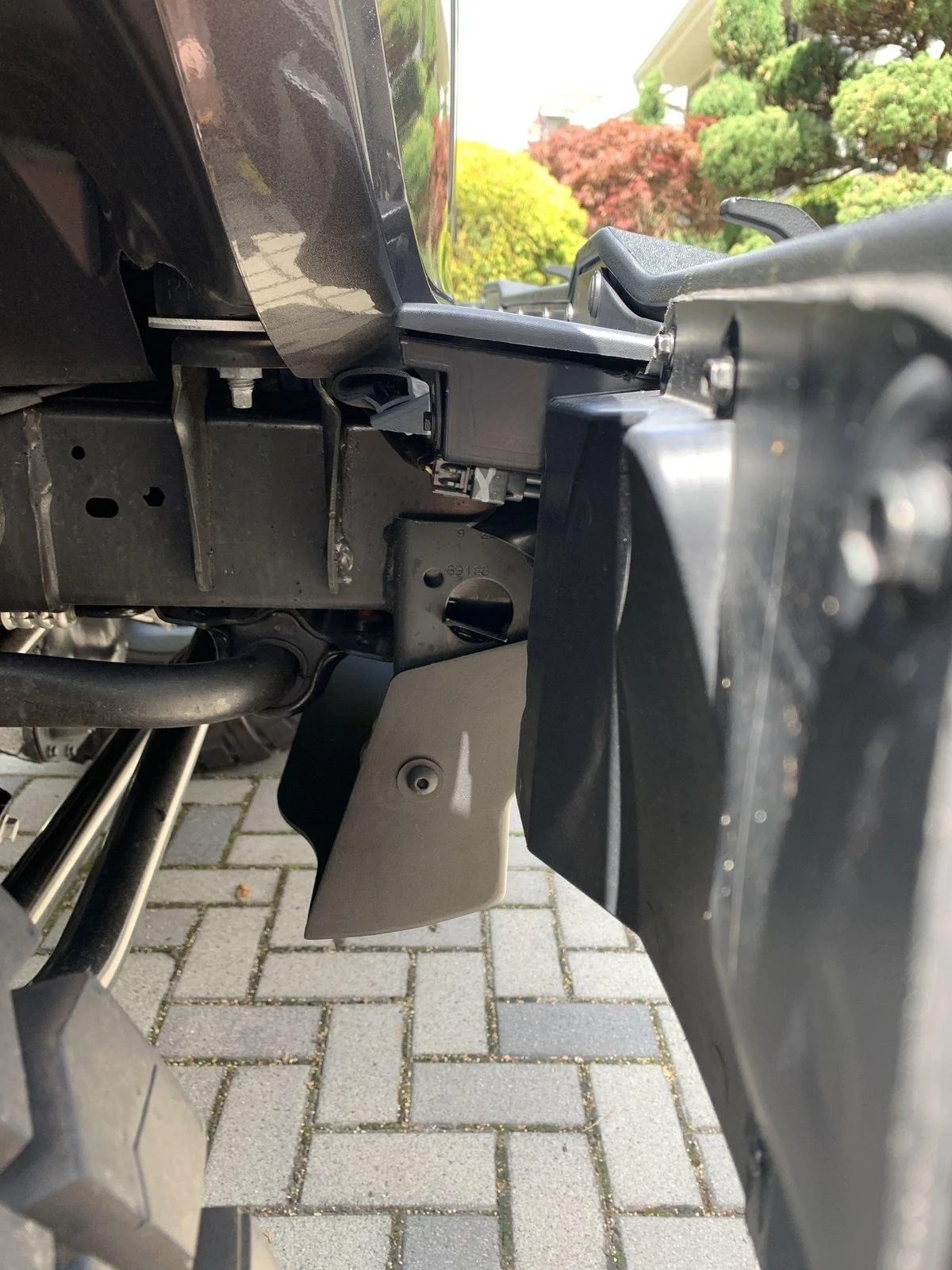

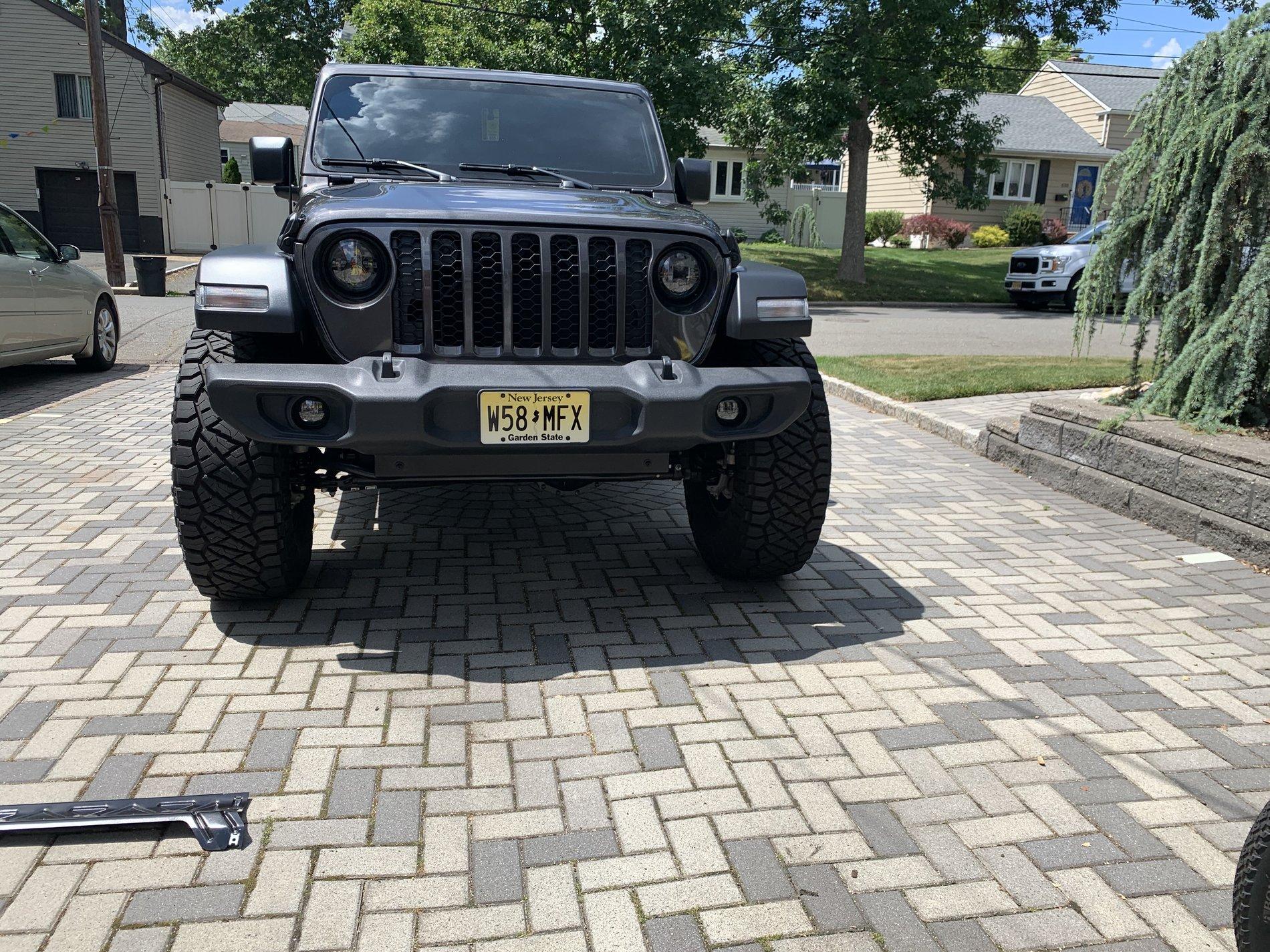

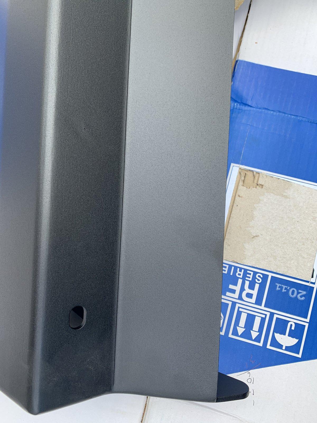

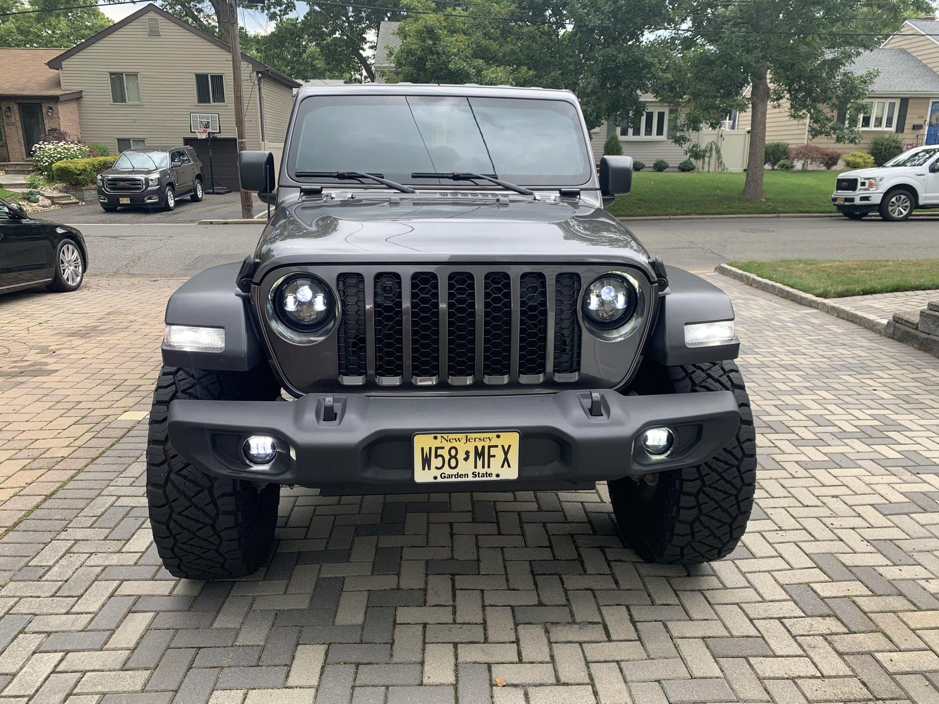

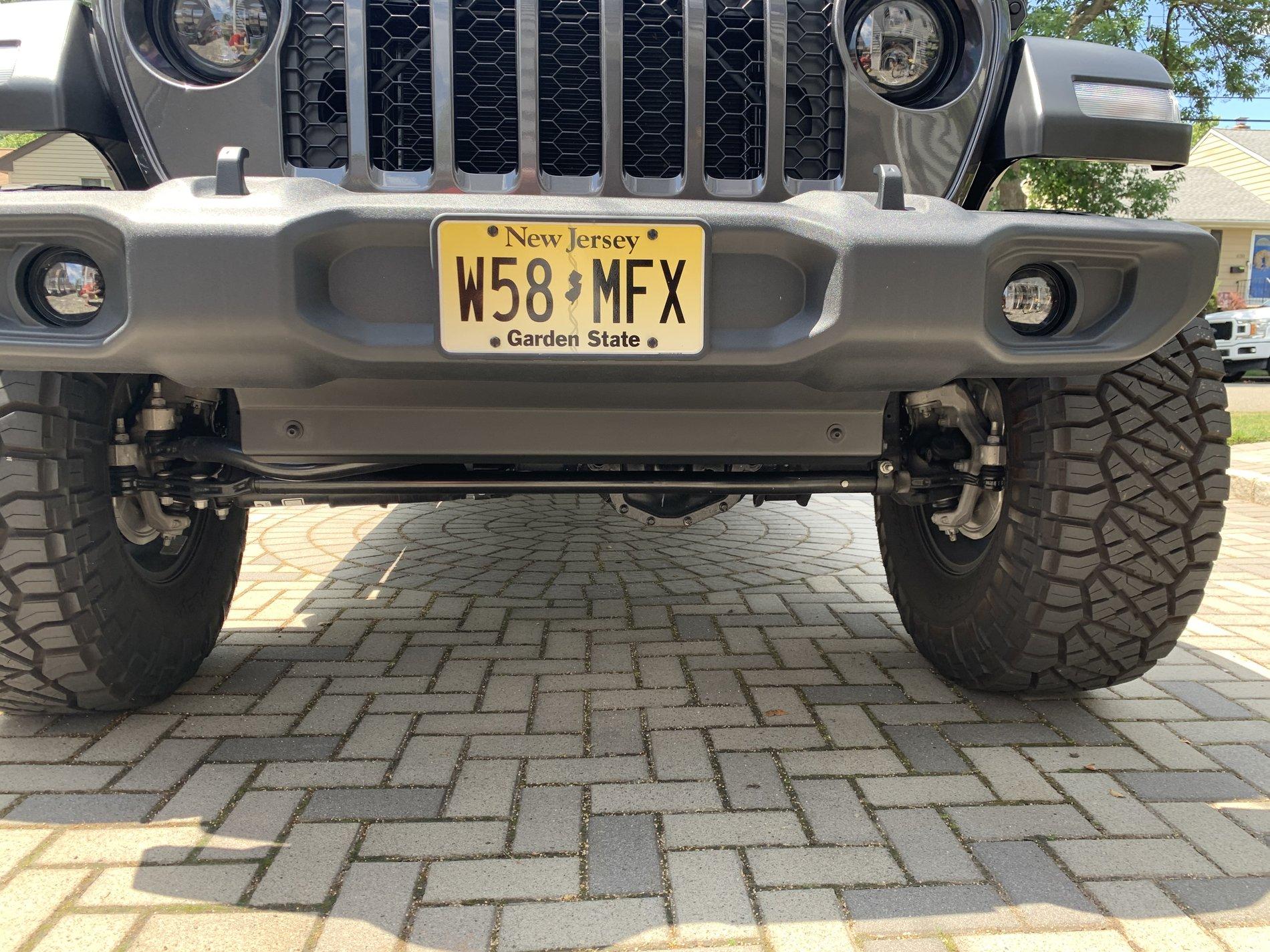

Just installed my Rusty’s Off Road JL Skid Plate on my JT that I had repowdered to match my bumpers since I took off the plastic lower air dam that left me with an unfinished look and I am in love with the fit and new finish. I also added my own black oxide button head cap screws and washers to clean it up even more. I think one of the best things about this skid plate that I like the most is how it wraps around the sides and hides the unsightly bumper brackets. #rustysoffroad #quickstrip

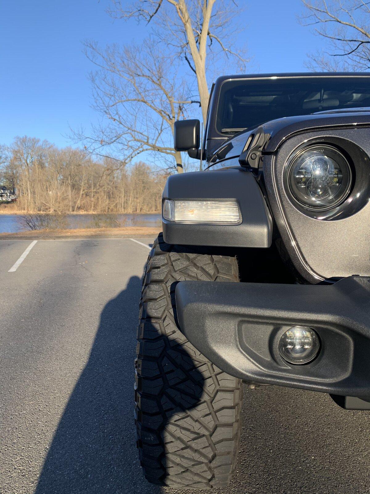

Installed a set of Diode Dynamics switchback white/amber turn signal bulbs to my front fenders that I bought locally along with a pair of 6 ohm resistors at Road Runners in Woodbridge, NJ. #shoplocal #nocode #errorfree #diodedynamics #roadrunnersperformance

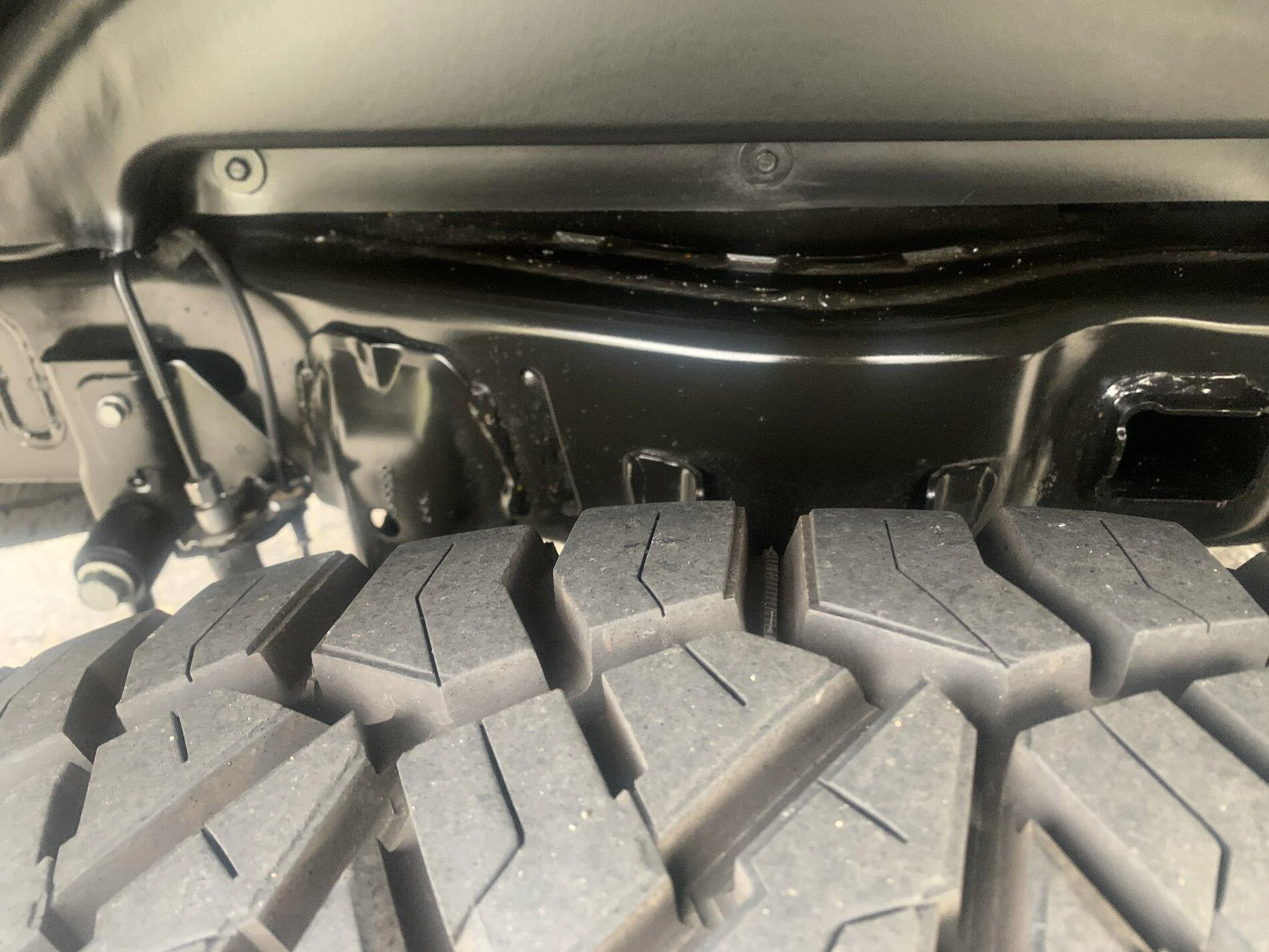

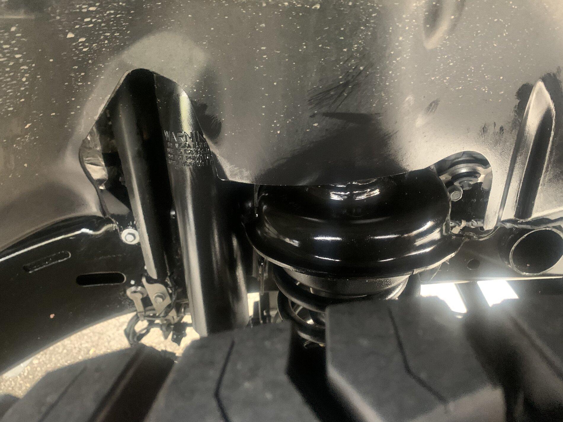

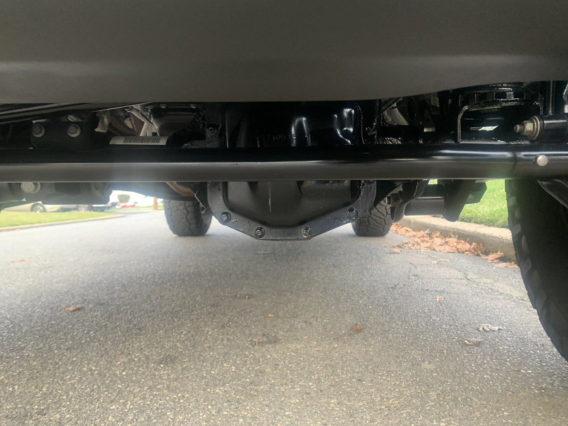

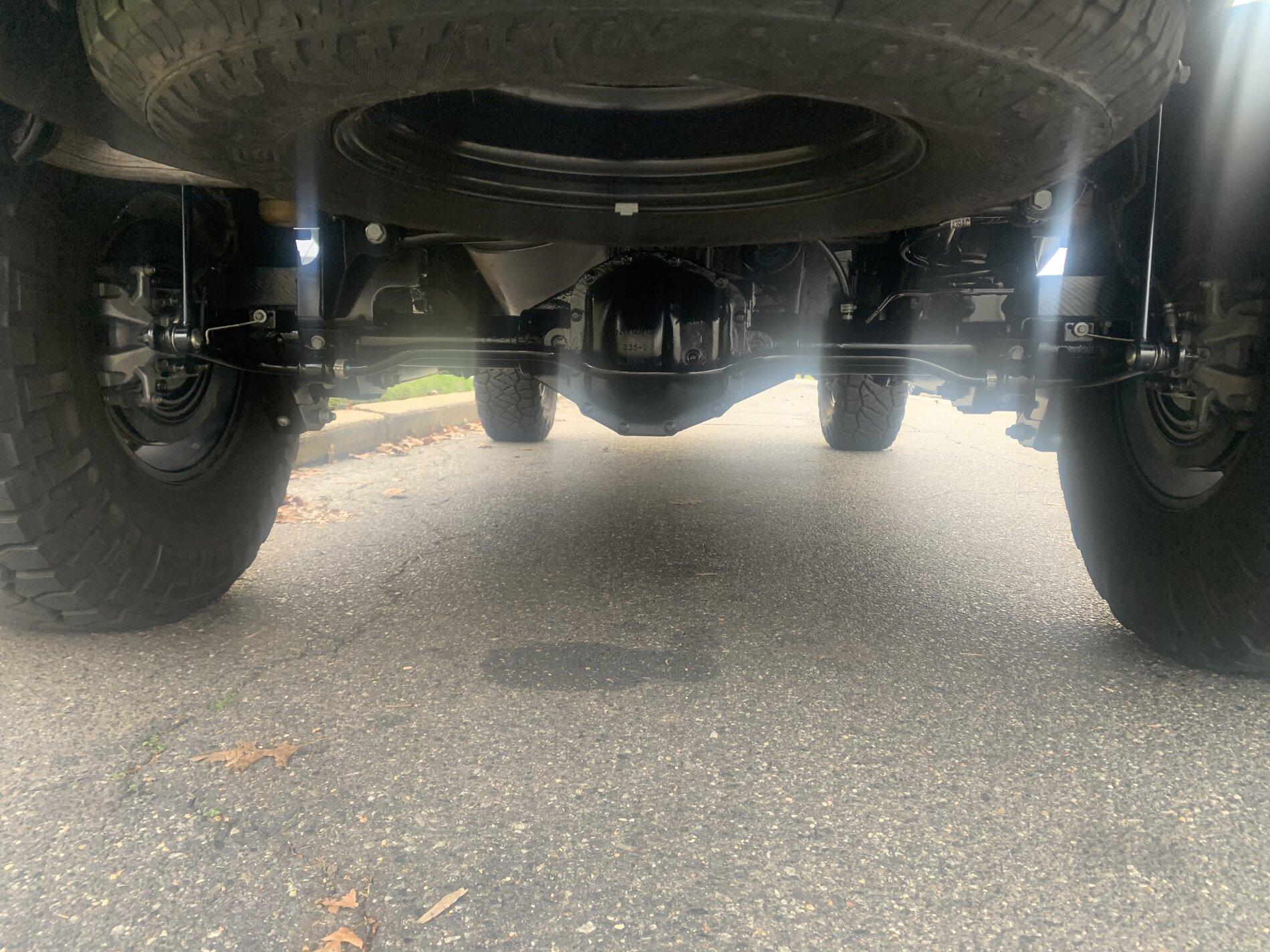

Snows a. comin so I spent some tike applying Fluid Film to the undercarriage today.

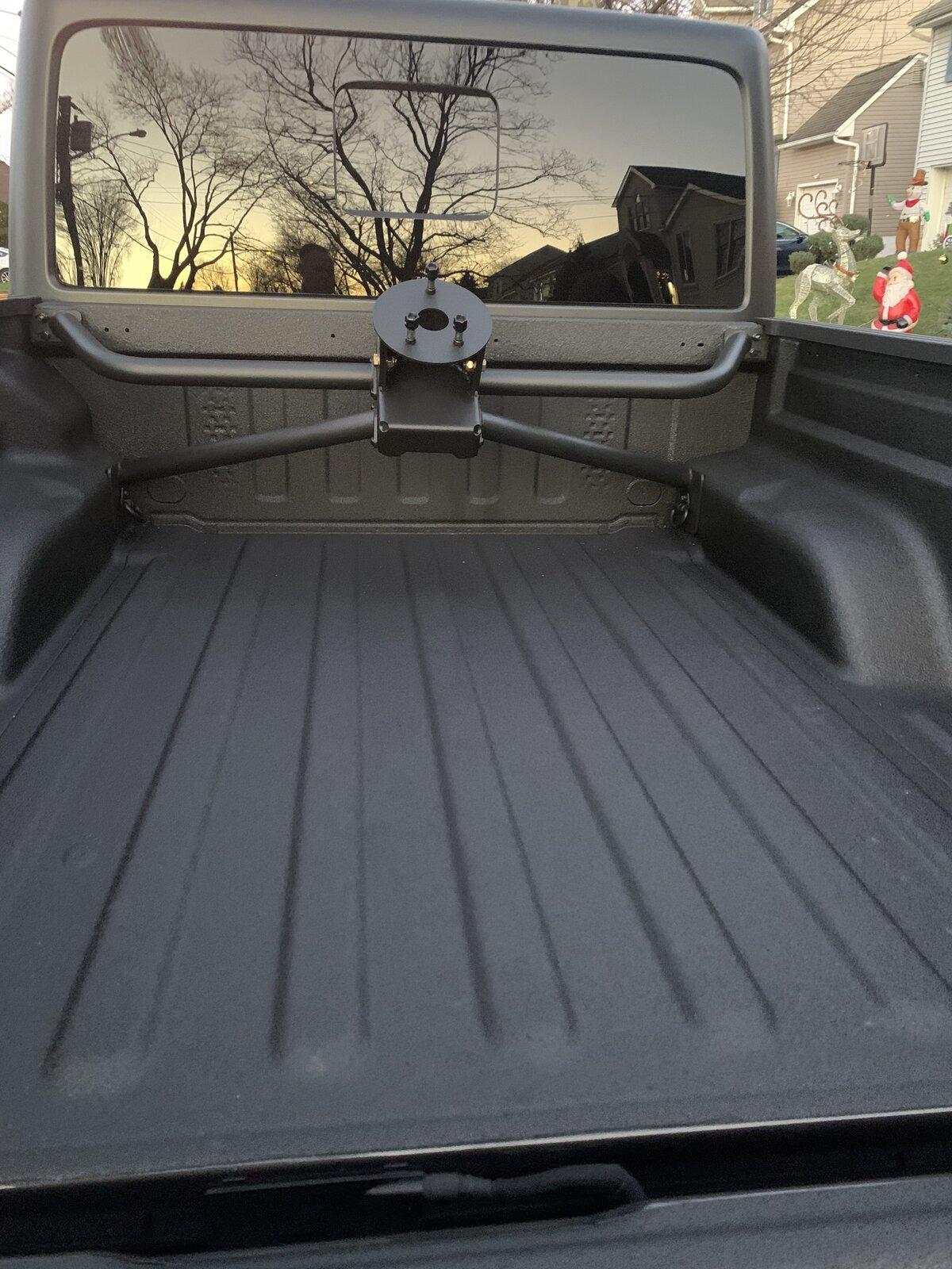

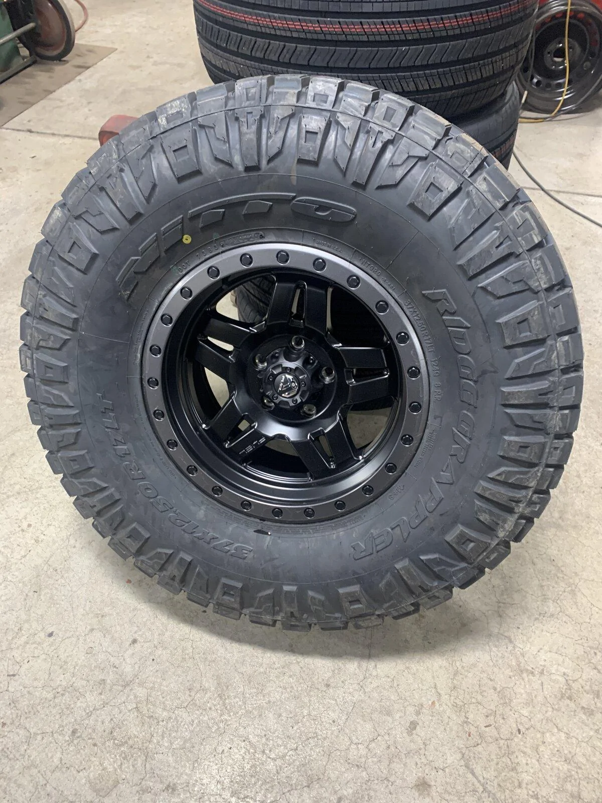

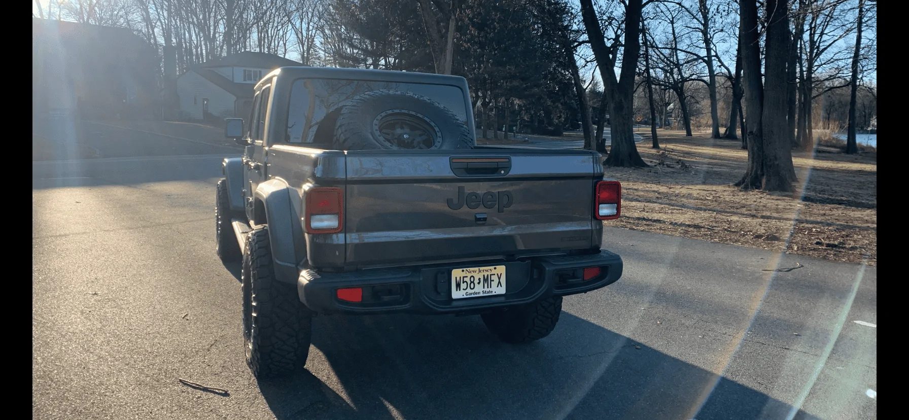

I think I scored the last 37x12.50-17 Ridge Grappler in North America yesterday that should be here on Monday so I can mount it up on my new Rugged Ridge bed mounted spare tire carrier. #staytuned

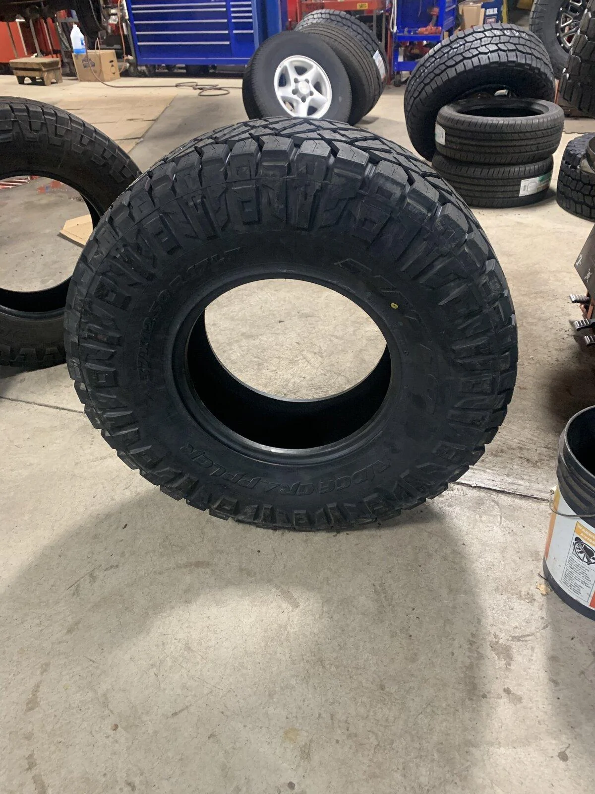

Shout Out to 4 Wheel Parts that had what is possibly the only 37x12.5-17 Nitto Ridge Grappler left in America in stock and shipped to me in only 2 business days. #nitto #ridgegrappler #4wp

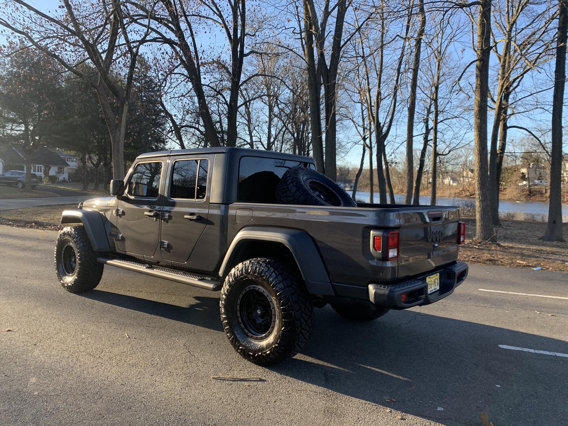

Did you change from the Savegre to the Fuels, or is this just a mismatched wheel on the spare?
I’ve got 5 Fuels now. Just waiting for some better lighting to take some pictures.

What prompted the change? Just mixing it up?

I loved everything about the AEV wheels except for the fact if you run a 37” Nitto Ridge Grappler on a non max tow Sport Gladiator they will rub in the front on the lower control arms. I then added spacers to remedy this problem, but the poke I was getting after the spacers were installed was too much for my liking. I purchased one of the first Gladiator spacer lift kits directly from AEV when they first became available and after notifying them that I was getting rub they actually added a disclaimer in their website the next day stating they you had to use BFG’s and only up to 35’s in a Sport. At this point new wheels are cheaper than new tires to achieve the stance I’ve been looking for since day 1. That’s why I orders the +6 Fuels because the ¾” inch difference that they give me over the +25 AEV’s mimics the max tow wide axel perfectly with it’s slightly over 5” backspace to works good so far.
Not sure if it’s just my Anza’s or what, but the +6 wheels I ordered actually say +7.4 on the box and Custom Offsets is clueless as to how this happened. If I had a chance to do it all over again I would have ordered elsewhere because everything from their tracking tool to customer service is horrendous.

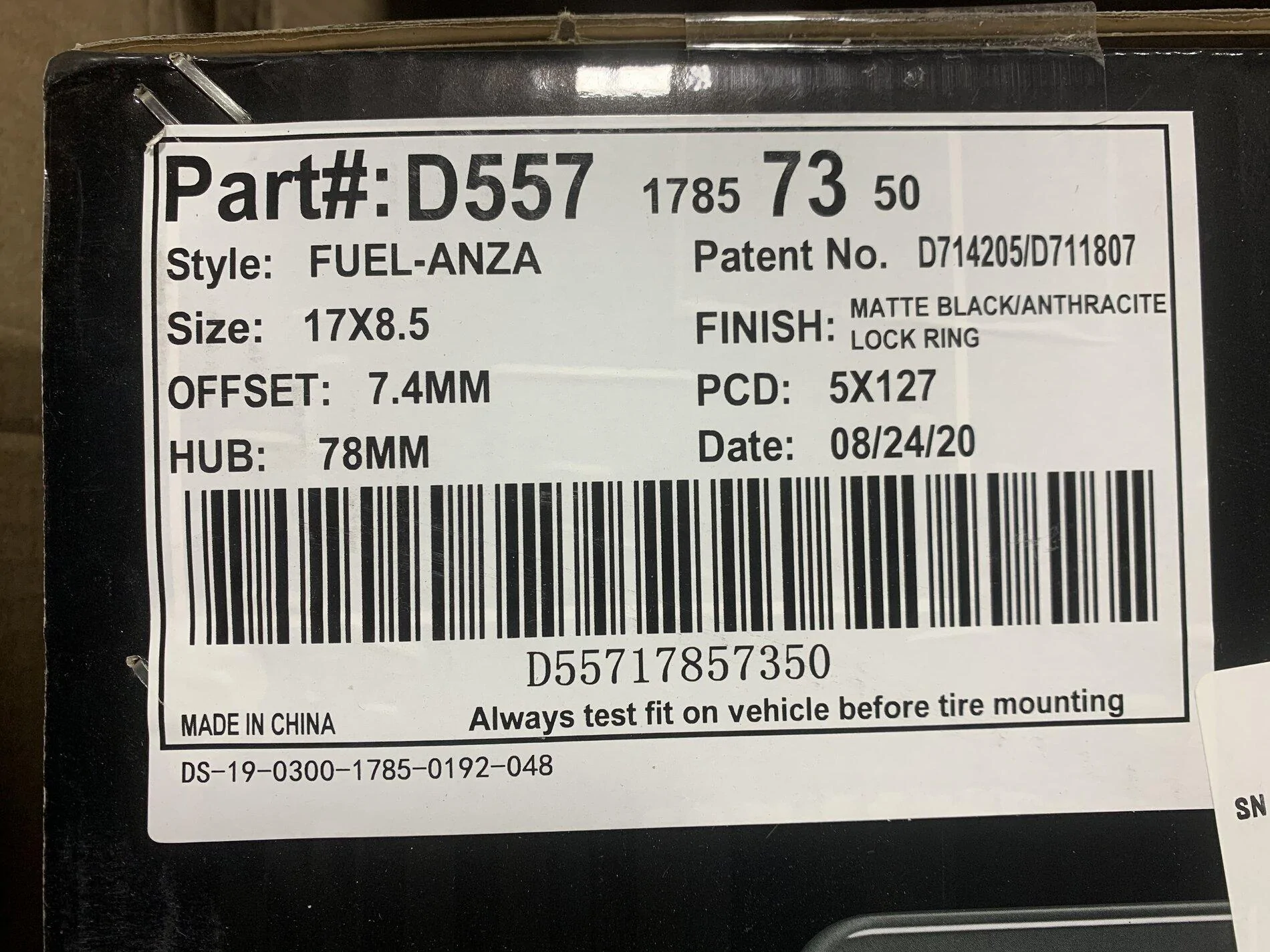

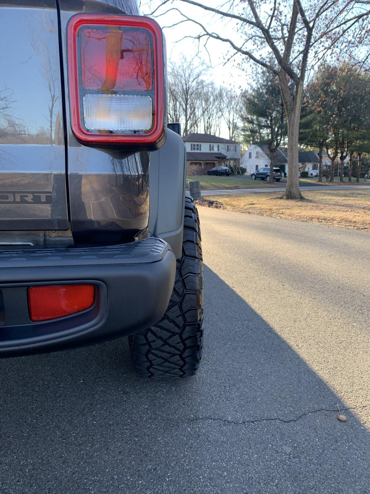

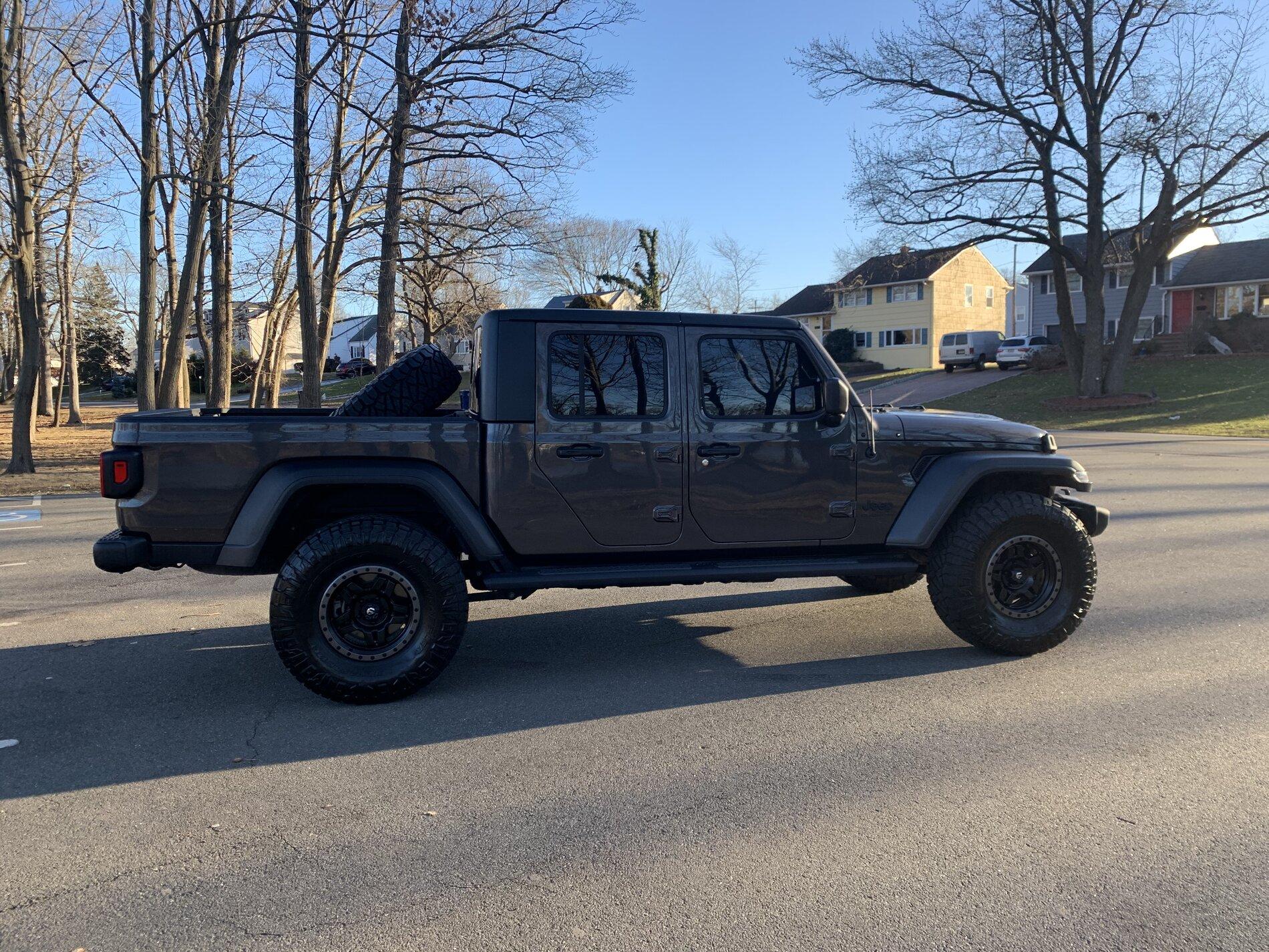

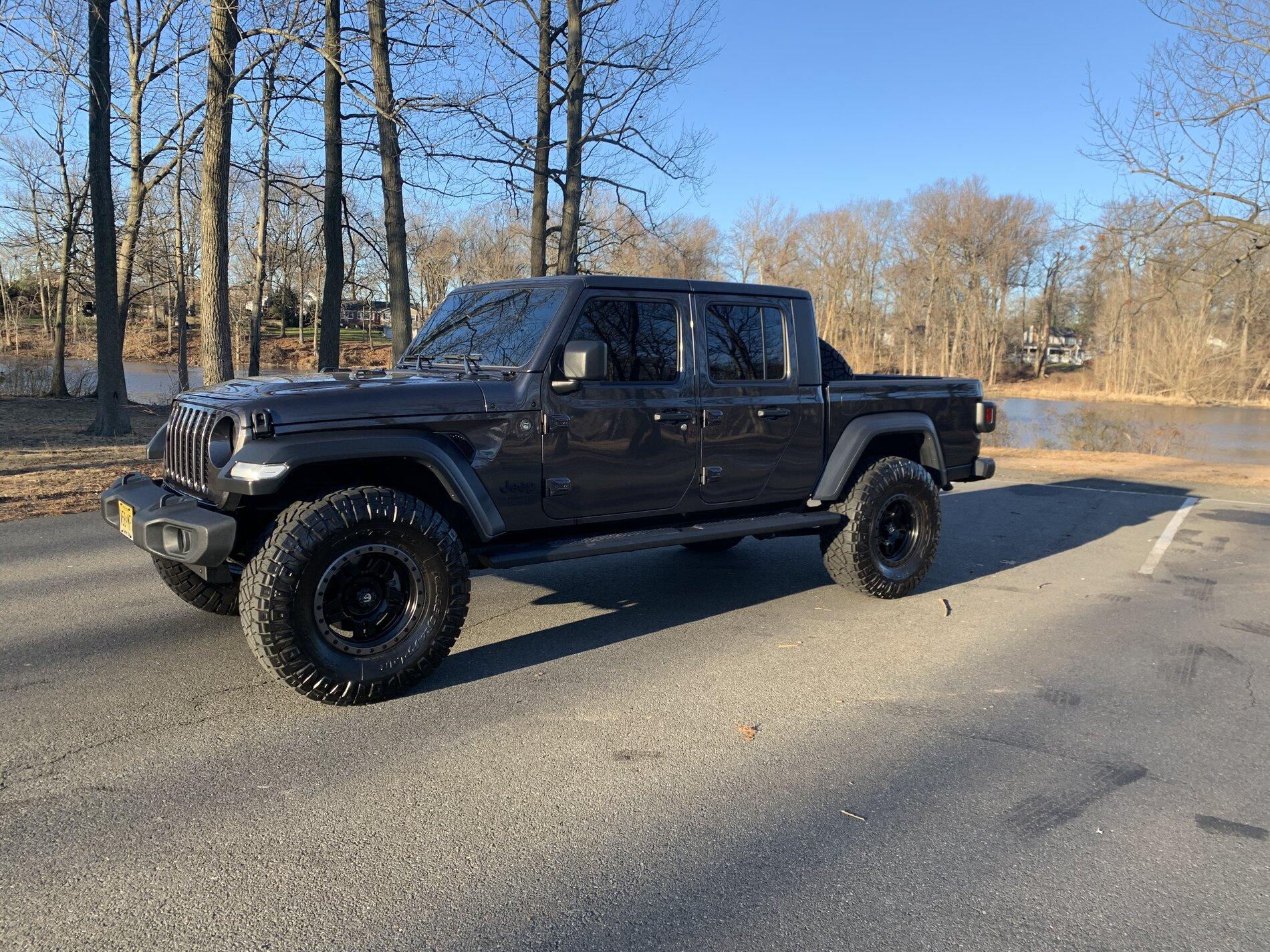

Please excuse the power of the morning Jersey sun, but I just wanted to snap a few pics of my new wheels and bed mounted spare that I took this morning after having my track bars installed.
I am absolutely in love with my new Fuel Anza Set up. They are 17x8.5 +6 with 5” of backspacing with 37x12.5-17 Nitto Ridge Grapplers mounted all around including the bed mounted spare on it Rugged Ridge carrier and provide me with the almost flush look I was searching for.
***FYI the box on my Fuel Wheels said +7.4 offset. Not sure if that’s normal or just mine as the measure a hair over 5” of back space.
I also had Clayton from and rear adjustable JT track bars installed to center my axels that were off ½” up front and ¼” in the rear since installing my lift back in March. They center the axels perfectly, the front fit with no issues, but the rear Johnnie Bolt had to be cut a little because it would not screw all the way into the track bar. I probably should have just left the factory one on so unless you’re over 2.5” it’s probably overkill but it was on the lift and taken apart already so I didn’t want to turn back.
#fuel #fuelwheels #anza #nitto #ridgegrappler #37 #ruggedridge #claytonoffroad #roadrunnersperformace

Looks awesome!
BTW, a hair over 5” means a 7.4mm offset.
7.4 mm = 0.291”
6 mm = 0.236”
Backspace = wheel width divided by 2 plus offset plus 1/2”
So:
7.4 mm offset = 5.04”
6 mm offset = 4.99”

I really like the tire carrier but wonder about visibility out the rear window. I even thought about purchasing a rear view mirror camera but have no found on that is “always on”

I know that, but apparently Fuel doesn’t as they market it as a +6 and are insistent that it will measure 5” exactly. ??‍♂
