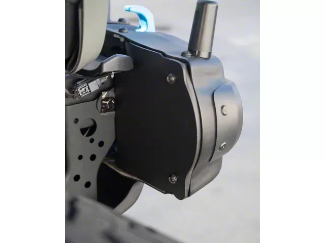

I have only seen ads and pictures of them with the extension ends off used in the stubby bumper configuration. They look good a lot more of a finished appearance. i wonder if debris would get in front of them, in and behind the bumper. I always had issues on previous jeeps with debris getting inside the bumpers, fuel tank skid plates, transfer case skid and frame sections requiring blasting out with water after almost any run.

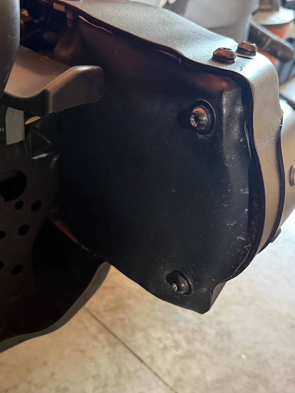

One of my favorites mods - I really hated the unfinished look of the backside of my bumper. I made closeout covers for my OEM steel stubby bumper for about $10 and an hour of my time. I purchased 1/16” thick 12”x16” moldable black ABS sheets from Amazon. Used some cardboard to make a rough cut out a 1/4 larger than the size needed to cover the back bumper. Drilled holes to use the existing bolts, attached the bolts and then molded the plastic using a heat gun and heat resistant gloves. Molded the edges back towards the bumper. I did this 8 months ago and have been on the beach and on muddy back roads many times. I even took one of the covers off to see if there was an accumulation of gunk - looked fairly clean.
