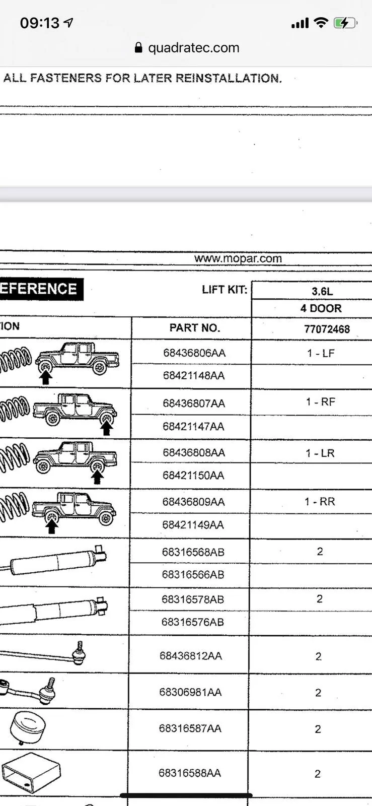

I’ve been thinking about this and internally debating this for a few weeks now. I think I want the height of the Mopar lift but as many have pointed out it is lacking. I’m thinking of putting together my own components, but I want the Mopar coil springs from the kit without unnecessarily purchasing the entire kit. Does anyone know the code numbers to the front and rear coil springs in the Mopar lift kit?

If you look up the mopar 2 inch lift kit install instructions. You will see a pdf which has all of the part numbers in it.

Why are there 8 part numbers for just the springs themselves??

thank you, I’m sure this can help someone. I actually Went with the Metalcloak GameChanger 3.5” lift.
