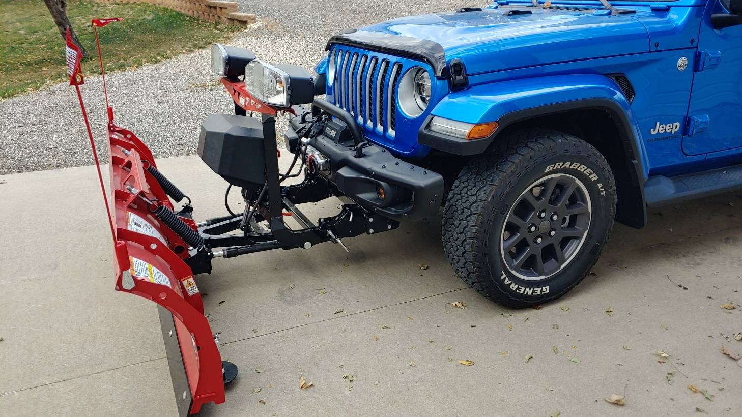

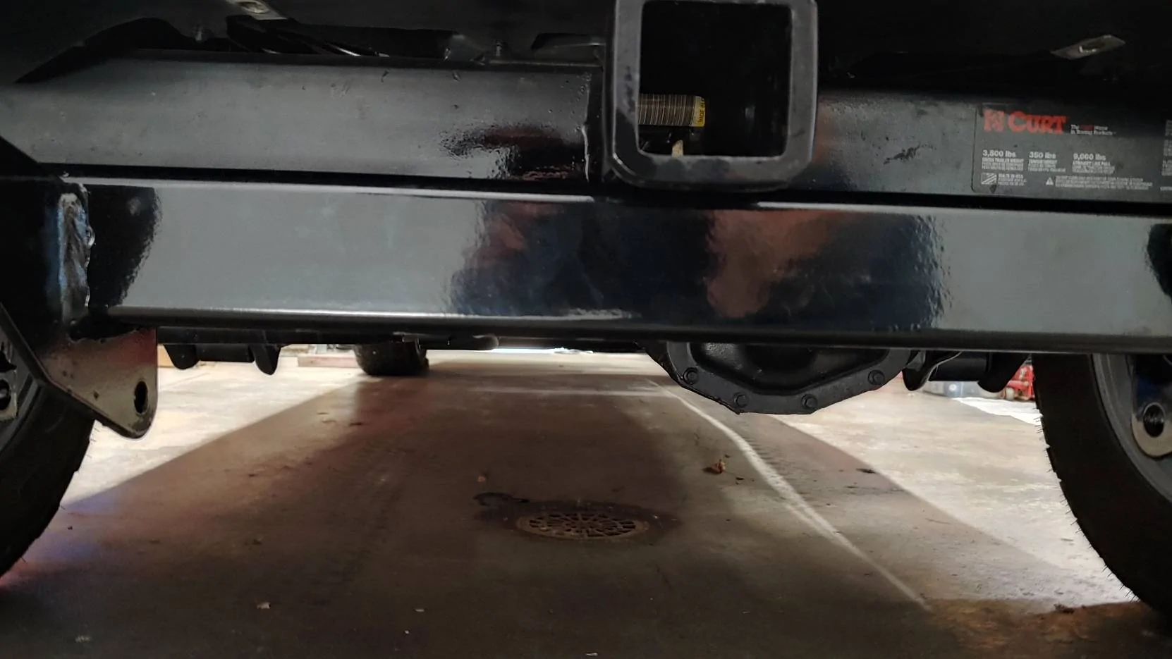

I see you have a front receiver hitch as well as the Western snowplow hitch and a winch too boot. With the snowplow attached, thats a fair amount of weight to drive around with. I imagine you try to drop the plow off for most trips?
What I would really like to know is if you were able to mount both of these hitches with provided parts or did you have to fabricate some plates to accomplish this?
Yeah, it's a bit of weight. I have dual-rate Synergy springs up front. They handle it very well.
I do now try to take the plow off for most driving.

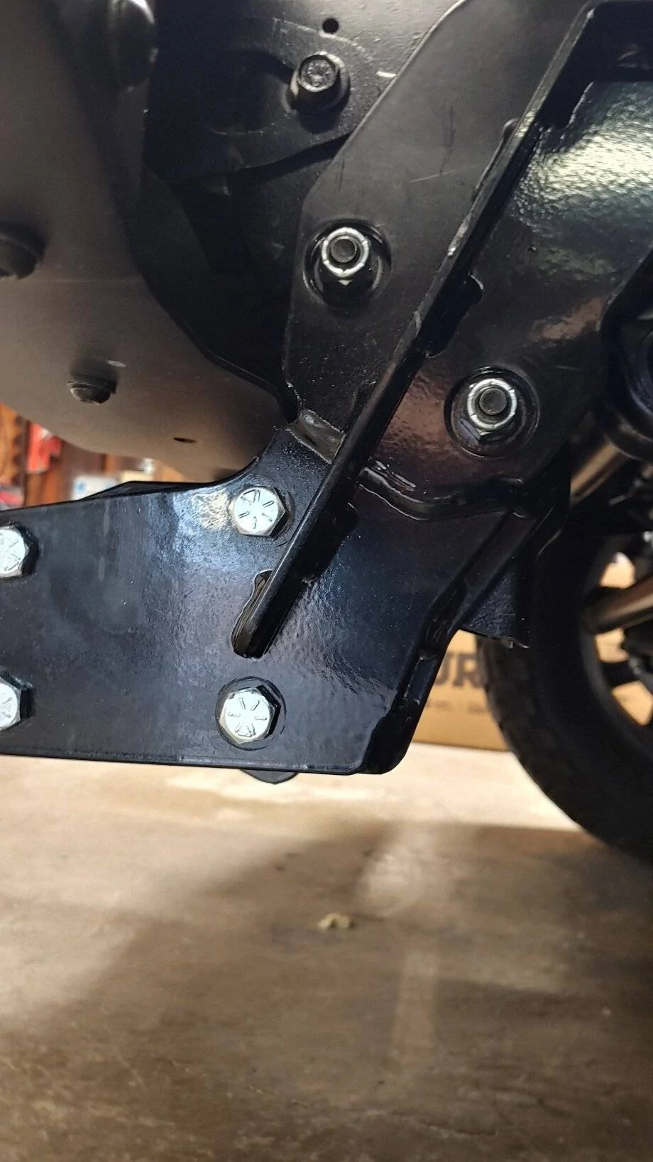

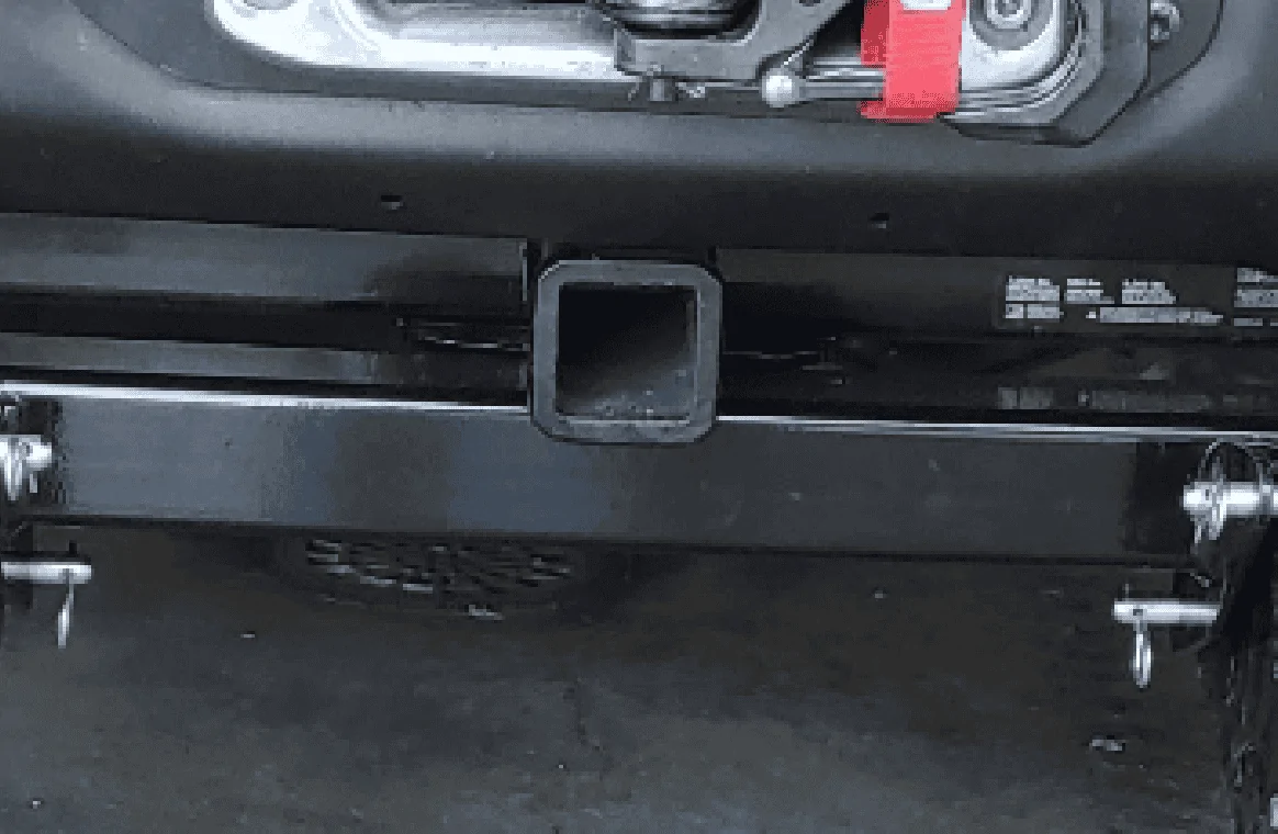

The Bulldog winch plate sits so that part of it is right where two of the receiver bolts need to be. So I reversed those receiver bolts - instead of head in the frame, nut outside, I have head outside and nut inside the frame and used carriage bolts. I also had to grind a bit on the winch plate.
For the plow bar vs. receiver I had to trim a bit on the receiver's tube brace to clear the plow mounting bar. Didn't impact strength at all because they could have used the same brace with the pointed part cut short but they made it easier for manufacturing by leaving the extra bulk in place.
Sometimes you get creative....... and have to think it through.

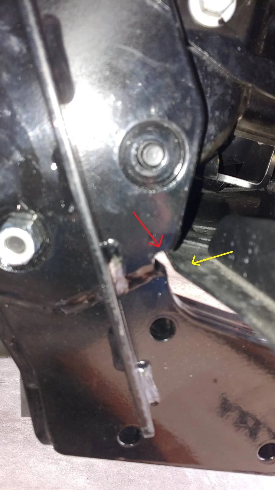

The plow's frame side brackets that bolt to the Jeep's frame and between which the plow's mounting bar bolts doesn't quite clear a steel bumper. So I had to put small notches in the plow's brackets.

Outstanding information Shadowspapa. I have pondered attempting what you have done. Your detailed description and excellent photography will help me when I get into this project. I was worried I might have to give up the front receiver hitch. Rarely used but sometimes very useful.

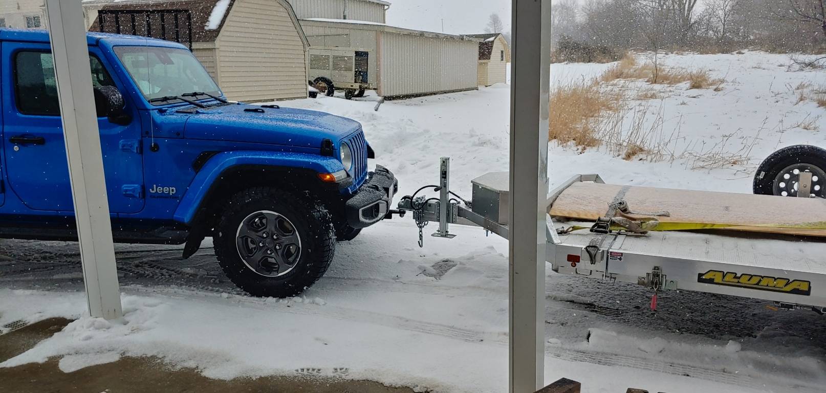

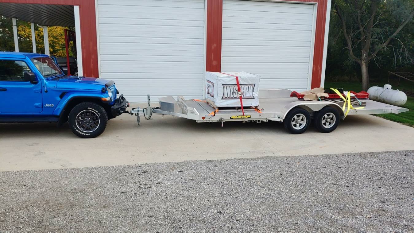

Handy for maneuvering a trailer in tight spots...
