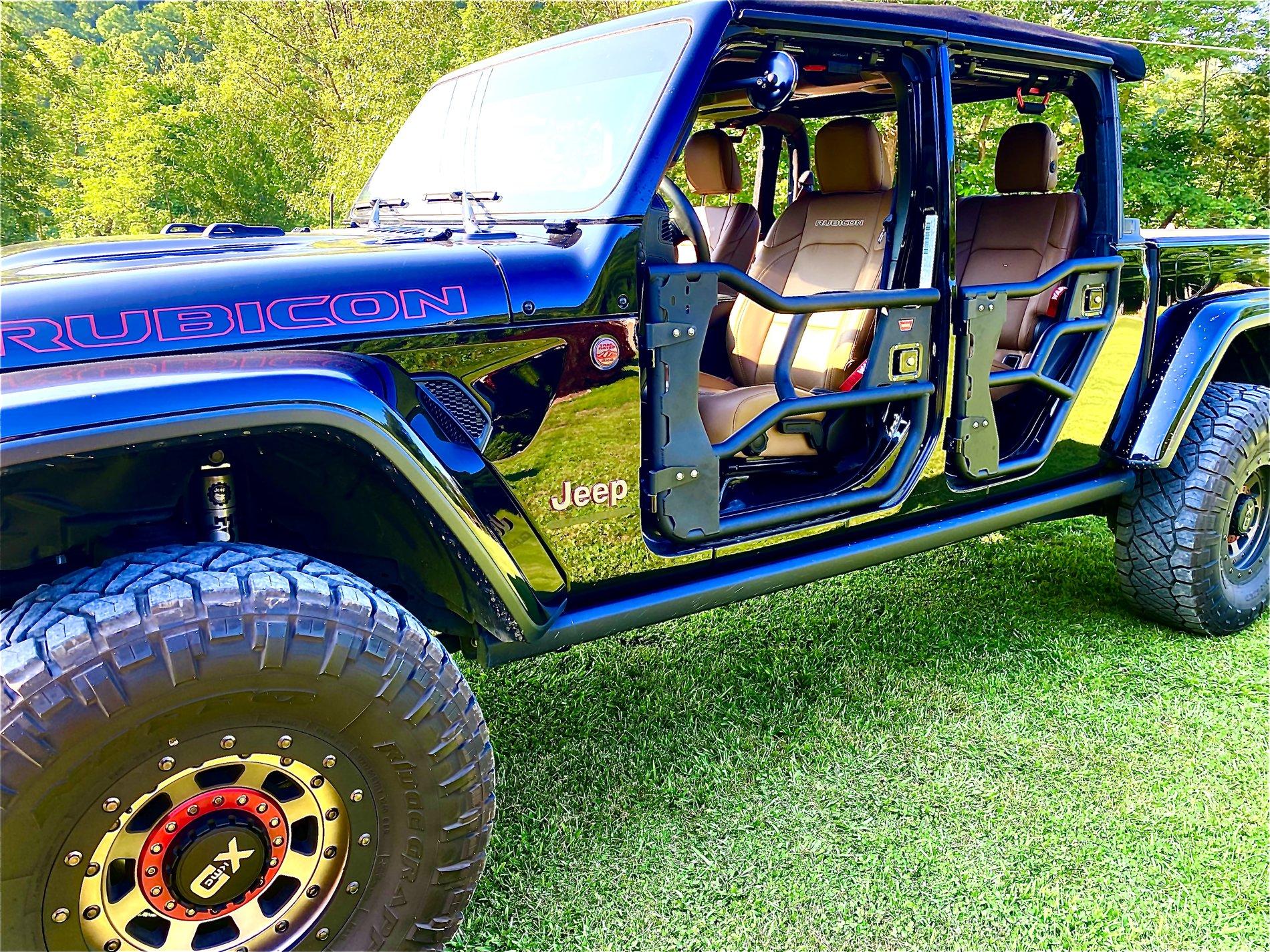

I just got my front Warn tube doors in this past weekend and just had to install. I was wondering if any previous owners had any trouble with the fitment on the hinge pieces?? I had one that almost seemed bent a little and extremely hard to force into and out of my JT hinges. Also, on a side note, I feel like the rubber door stop is the key to the locking mechanism not rattling. If you can adjust it correctly, it will put enough pressure on the door so that there is no rattling (in my limited experience so far). Still waiting on rear set to arrive.

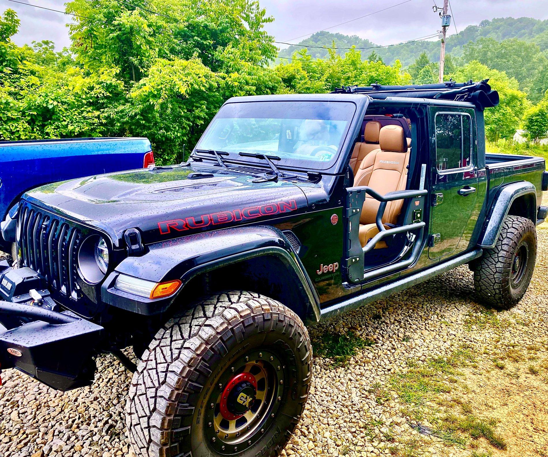

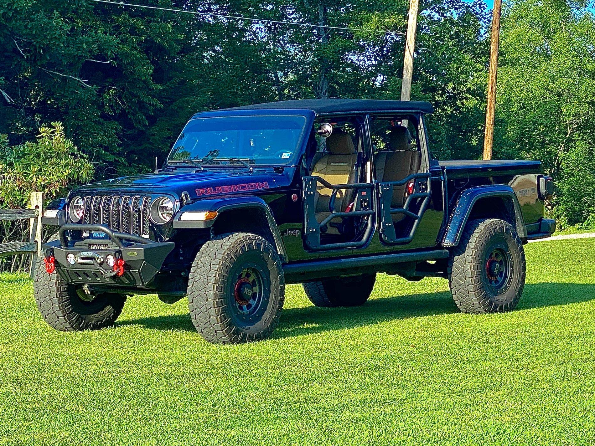

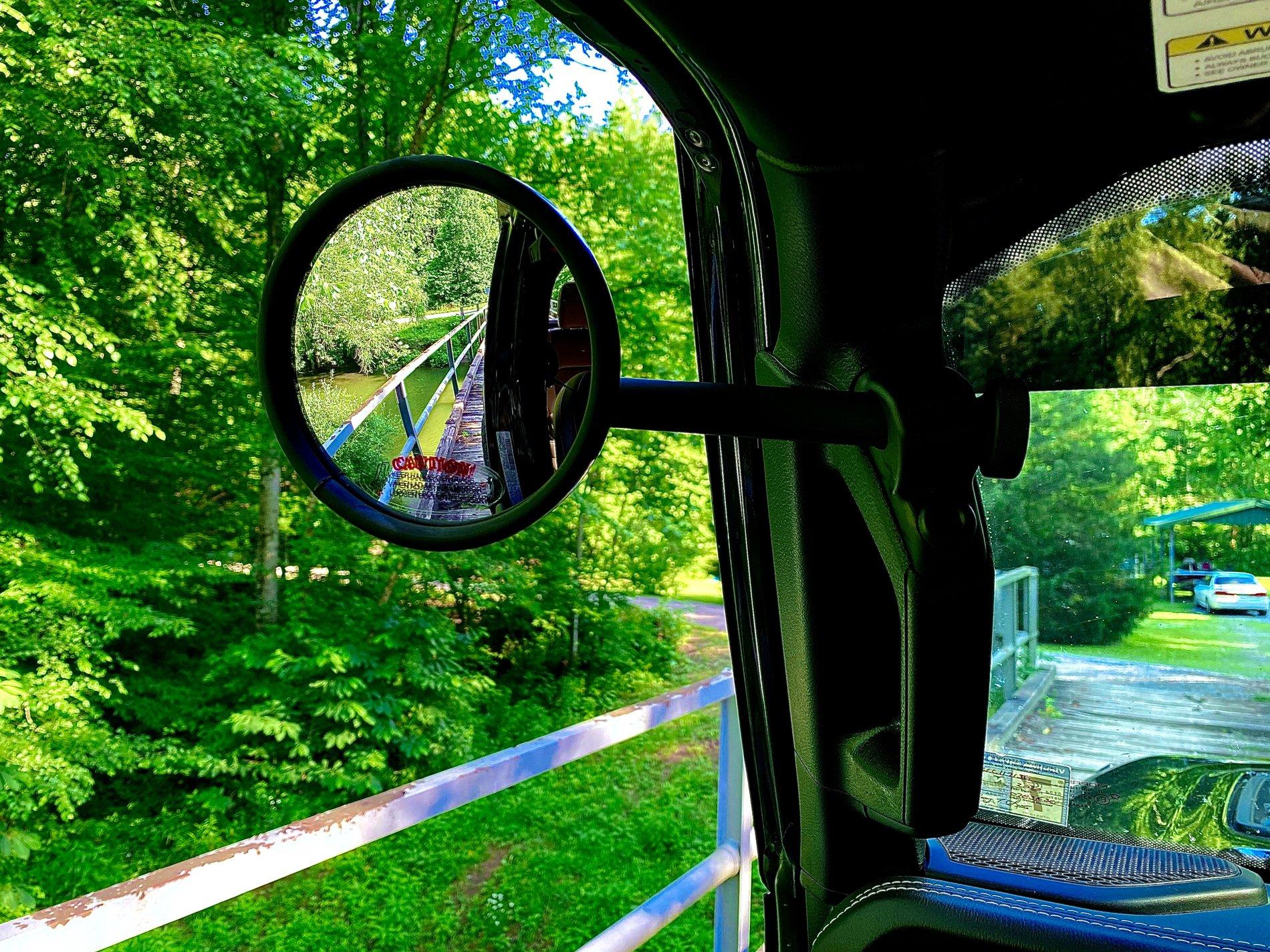

All four doors installed! Also, on a side note, went with Carolina Metal Masters side mirrors! Actually love the look and quality of these!
