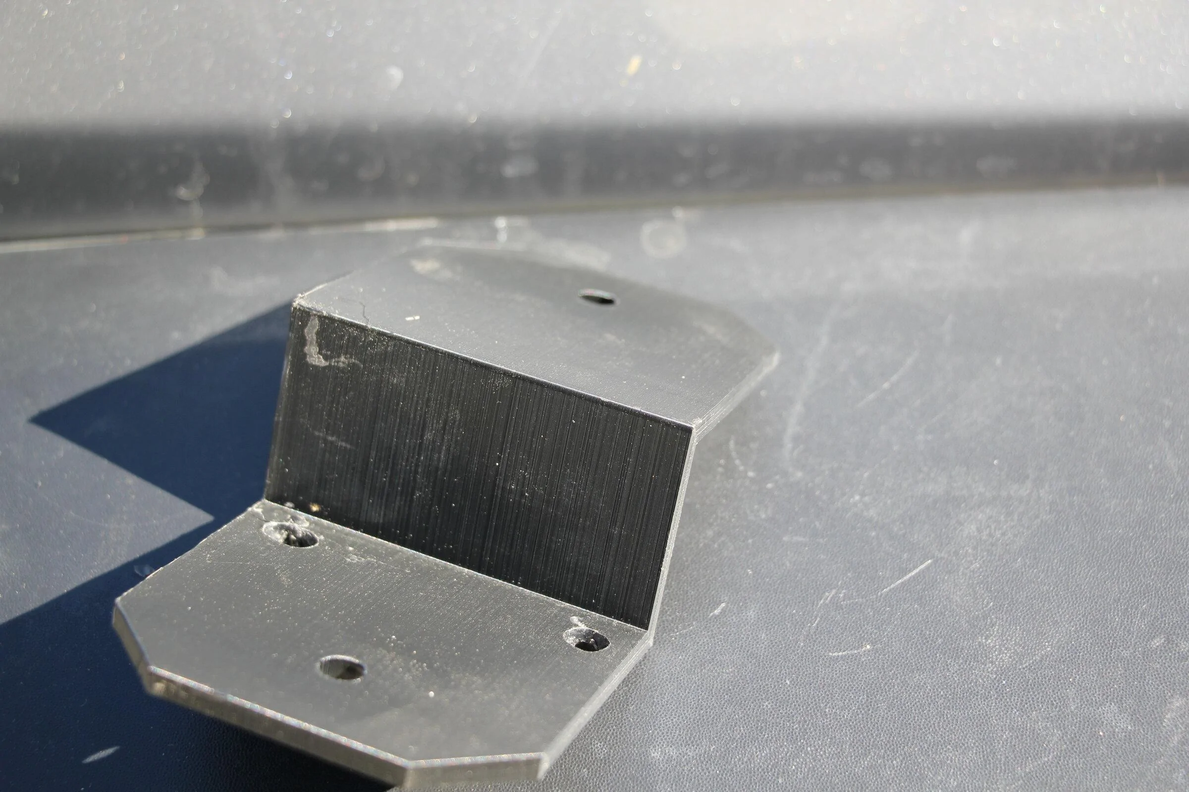

Several forum members have done metal brackets.. but I don't have scrap metal laying around. I DO, however, have a number of 3d printers.. so I opted to produce a bracket for it.
Couple of things to note.. it's designed to be mounted near the hex rivnut hole on the passenger side of our engine bays. If you want to mount it someplace else, feel free.. but it was designed with that spot in mind.
Jeep Gladiator Necessity, the mother of invention.. and all that. PXL_20211018_210411108
Jeep Gladiator Necessity, the mother of invention.. and all that. PXL_20211018_211648941
(Yes, I'm well aware, I'm missing the bolt in the photo... gotta go grab a M6 bolt for it)
It's not a 'perfect fit' by any means, but it does provide a non-conductive mount, that you can print out in about an hour. I also angled the corners, because my wife pointed out, any time you have sharp corners, someone will somehow injure themselves. Meh.. I don't know if I buy that, but it reduces the material needed to print it.
Anyway, the STL is available on Thingiverse, (though it's taking it own sweet time: https://www.thingiverse.com/thing:5024564 ) but if anyone wants it, and can't find it there, let me know, and I'll create a drive link and DM ya with it.
Sure, it's not going to change the world, but if it helps 1 person, I'm happy. :)

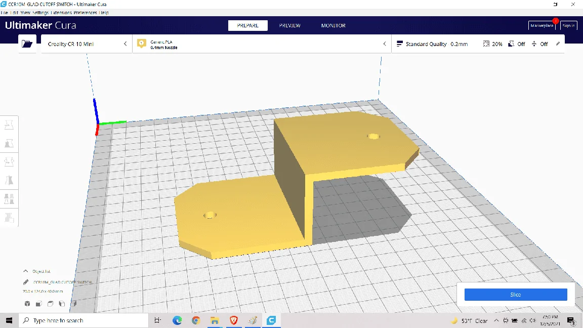

So, after reading all of the various posts and such, I finally pulled the trigger and purchased the OEM Rubicon steel bumper, and added a winch to it.
To prevent a 'hot bumper' in the event of an accident, I added the Warn Power interrupt kit, though I imagine a generic solenoid would do the trick, too.
Anyway, everything installed ok, but I was struggling to find a place to mount the solenoid. I don't like drilling into my cars, or my car parts, so if I could find a better spot for it.. so be it.
~ Casp

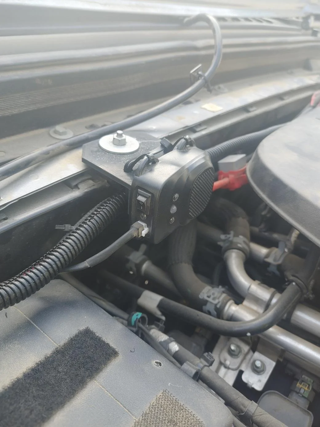

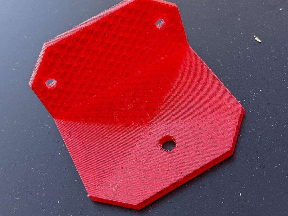

Well, you motivated me. I rigged up a vent system and bought some ABS. This was my first test print. Then when I went to test-fit, my manual disconnect switch has a different bolt pattern than your solenoid. So it will be back to the drawing board for me.
All was not lost, however. The mount now proudly holds my rodent-zapper, and helped clean up some of my wire runs. So thanks!
Jeep Gladiator Necessity, the mother of invention.. and all that. 1118211023_HDR
If you want the file, in a different format to modify the bolt pattern, let me know :)

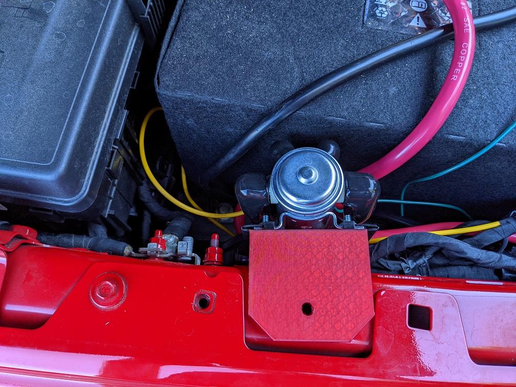

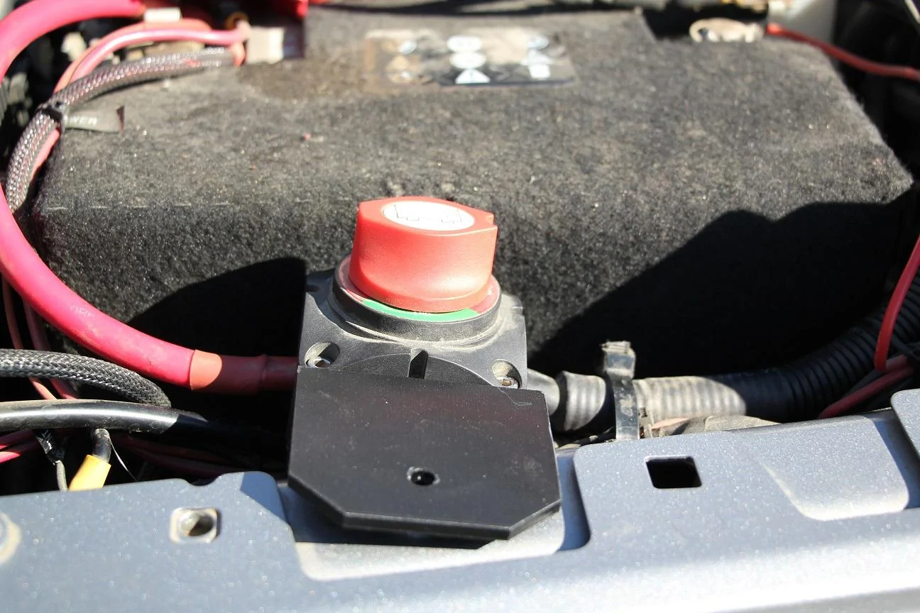

Okay, I'm almost there. I copied the file, duplicated it, rotated it, and printed in ABS. I then manually measured the holes and drilled them. Switch sits fine, but I didn't have a rivnut. I thought I could use some clip fasteners, but nope. So the final assembly is waiting on a rivnut. I can post the file if you think it is worth it.

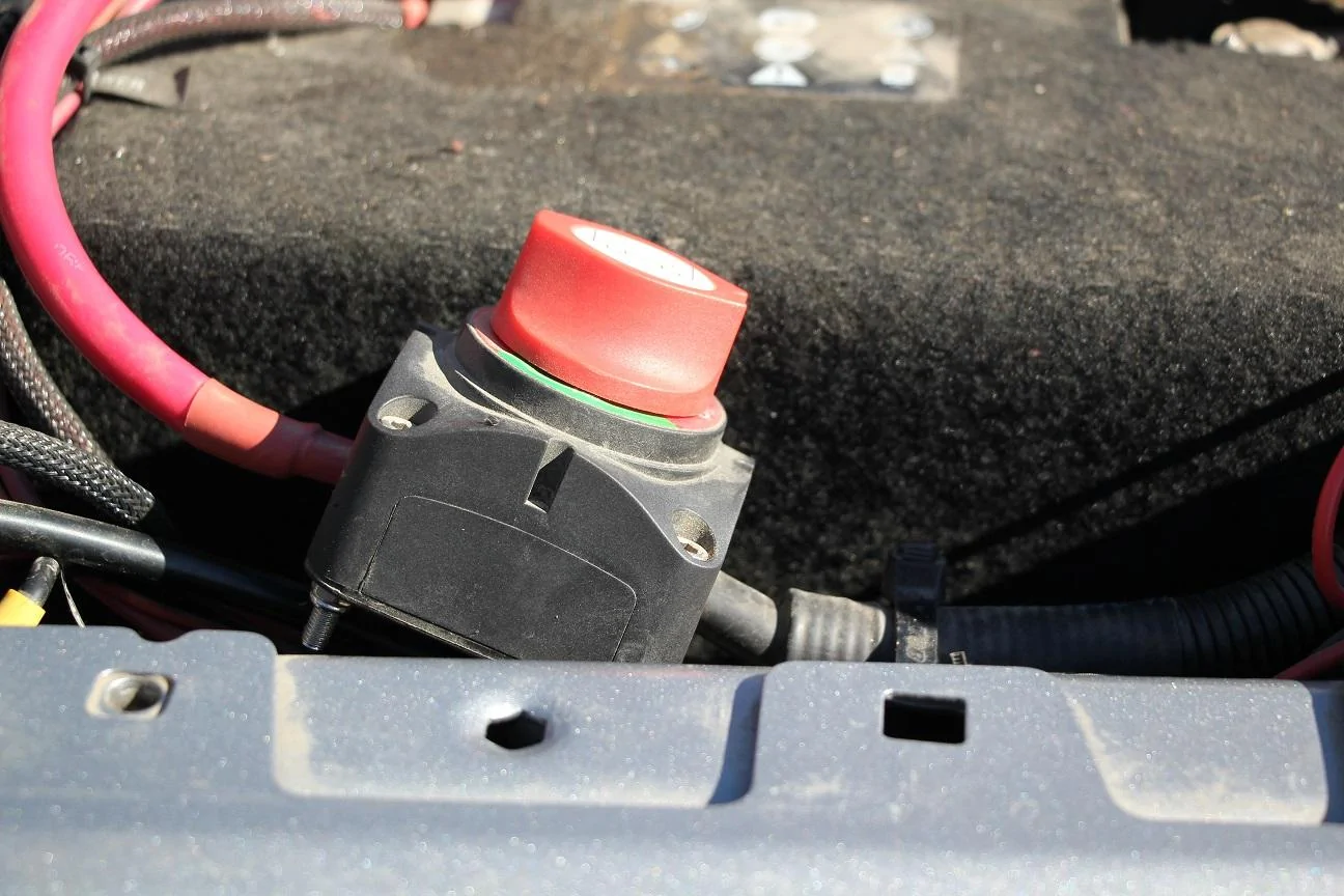

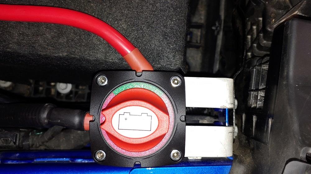

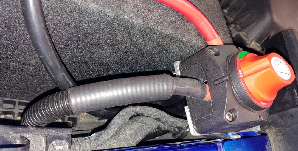

Any reason people are concerned about the mount of a solenoid or switch being non-conductive?
They've been mounted on steel parts for many decades...............
Just wondering why the concern on an insulated part.

Less worries about it being non-conductive, so much as the fact I don't have metal laying around. ;)
That said, I've seen enough squirrelly crap happen with electronics during my life, that I will always insulate anything I can.
Worked as a repair tech for Circuit City for a few years.. and the amount of 'whoops.. that's not supposed to happen' I've seen in mass produced electronics, is mind boggling.
That said, my biggest concern was more about not letting the solenoid bounce around.. *shrug*
~ Casp
