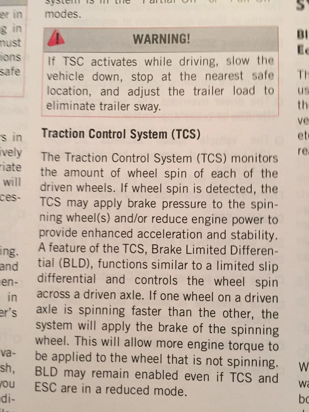

If you’re in 4-hi you always need to disable the ESS using the button on the dash.
