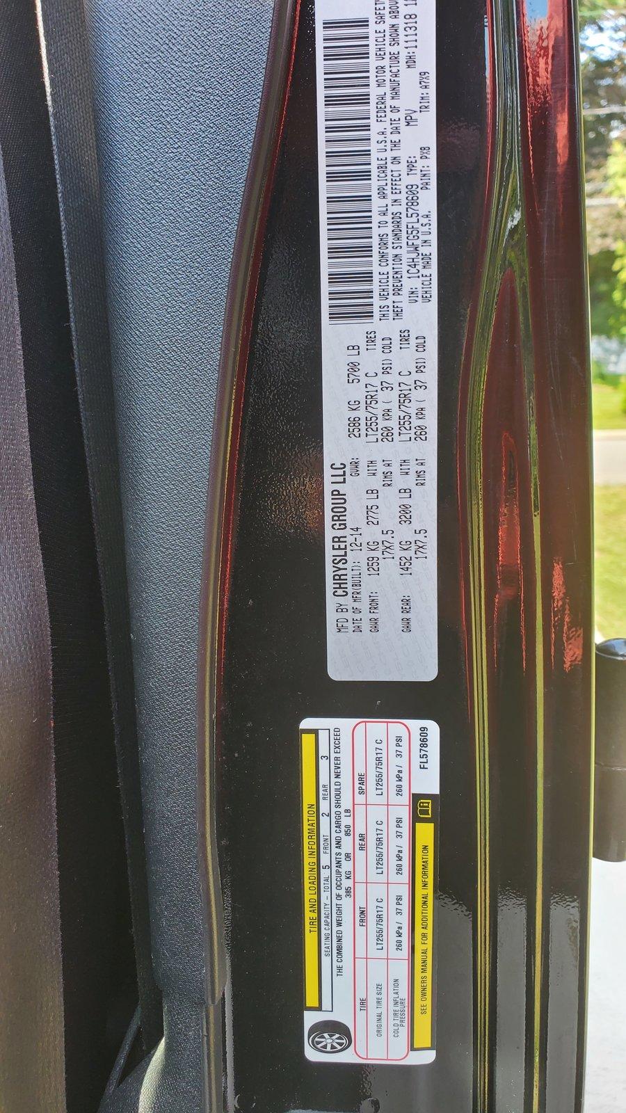

Assuming you are still in the shopping phase, scour your local dealers and find a truck that matches as closly as possible to your target build and put eyes on the door tag.
The key metrics are GVW and GVCW. GVW is obviously just the maximum the vehicle itself can weigh. GVW - wet curb weight = cargo capacity allowable. GVCW is truck plus trailer and tongue weight counts as cargo weight. As you already have a handle on, balancing the maximum weight of the trailer, the correct tongue weight for good balance and track and the weight of the trailer can be a beautiful dance or a rude pig wallow depending on how near the limits you are. The final wrinkle is front and rear axle loading, it is possible to get all loaded up and hitched up and ready to rock but have your rear axle be over weight despite not maxing out overall. Bad times st the uhaul corral!
To answer your initial question, no its not baked in with love. The base base sport s max tow with no options can payload that but everything you add has a weight value associated to it. Hence why its important to look at tags that correspond to target builds.
Looking at the attached for a 2015 JKUR with just a hard top note the GVWR versus the listed payload. 850 pounds for people, pooches, food and clothes but the GVW IS 5700 pounds. 4850 wet curb? But the axles are rated at 2275 front and 3200 rear for 5475. GVCW IS 8325 with a 3500 GTW and 350 tongue. So some of the tongue weight is accounted for but oh my, with a full load and max trailer this would one wild ride. And by wild I mean going slow, big turns, no rapid anything and a hawks eyes on everything. Aint it fun?
