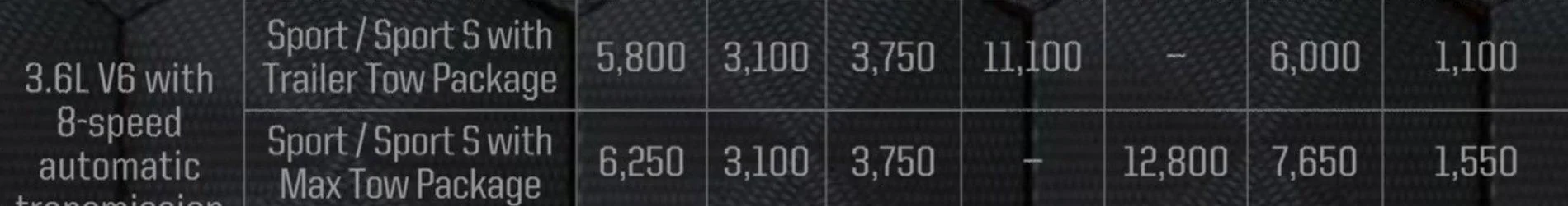

What doesn't make any sense to me is the payload drops if you add the tow package. You would think the extra cooling would help. I don't get that
Jeep Gladiator max payload 20190816_222134
take a closer look at the automagical, Sport / Sport S
tow package = 1,100 payload
max tow pkg = 1,550 payload

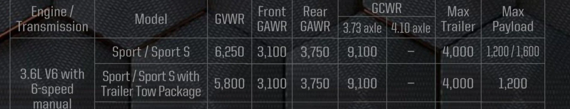

Second set of boxes, manual with the tow package. Payload drops to 1200 from whomever has 1600. I don't get that. Tow package is class iv receiver, beefier alternator, bigger fan for better cooling. Why does that drop the payload?

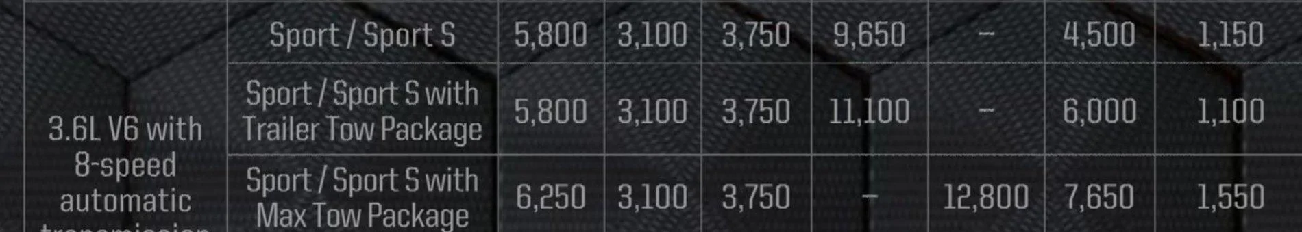

Jeep Gladiator max payload 20190816_224537
this is again the automagical... but from bone stock to tow package... they're listing a 50LB drop in payload...
for the Manual (top two boxes) its confusing because they have both 1200 & 1600, but you're right... 1200 with tow package and either the "sport / sport s" has 1600

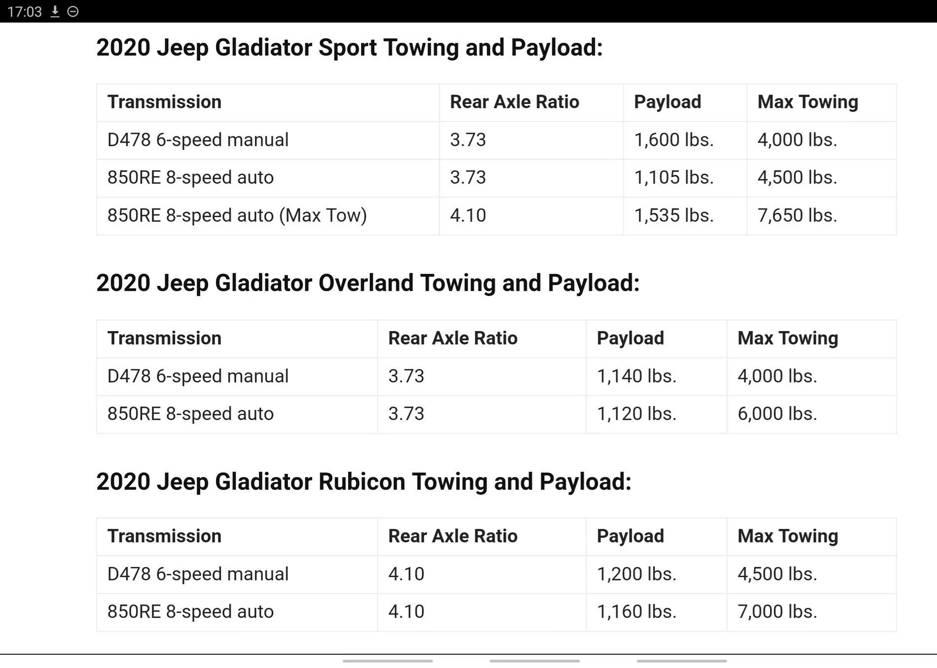

@Hemi I phoned jeep back and got a different girl, she was able to dig a lot and produced similar info to TFL truck.
Jeep Gladiator max payload 20190816_170518
however she wasn't able to look at or reference the gladiator brochure... still this info the jeep girl had over the phone says the manual rubicon has 1,600 of payload (like the brochure)... and TFL says that same configuration has 1200. also she couldn't specify the difference between the sport and sport s payload.
