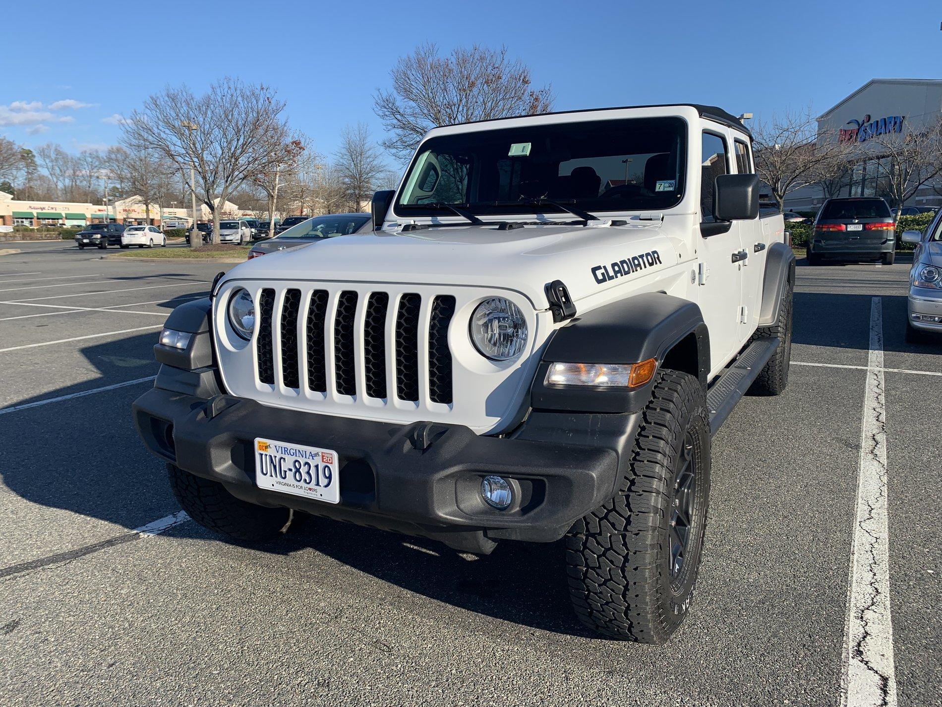

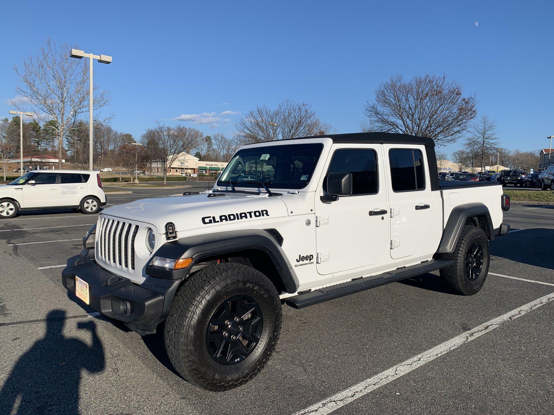

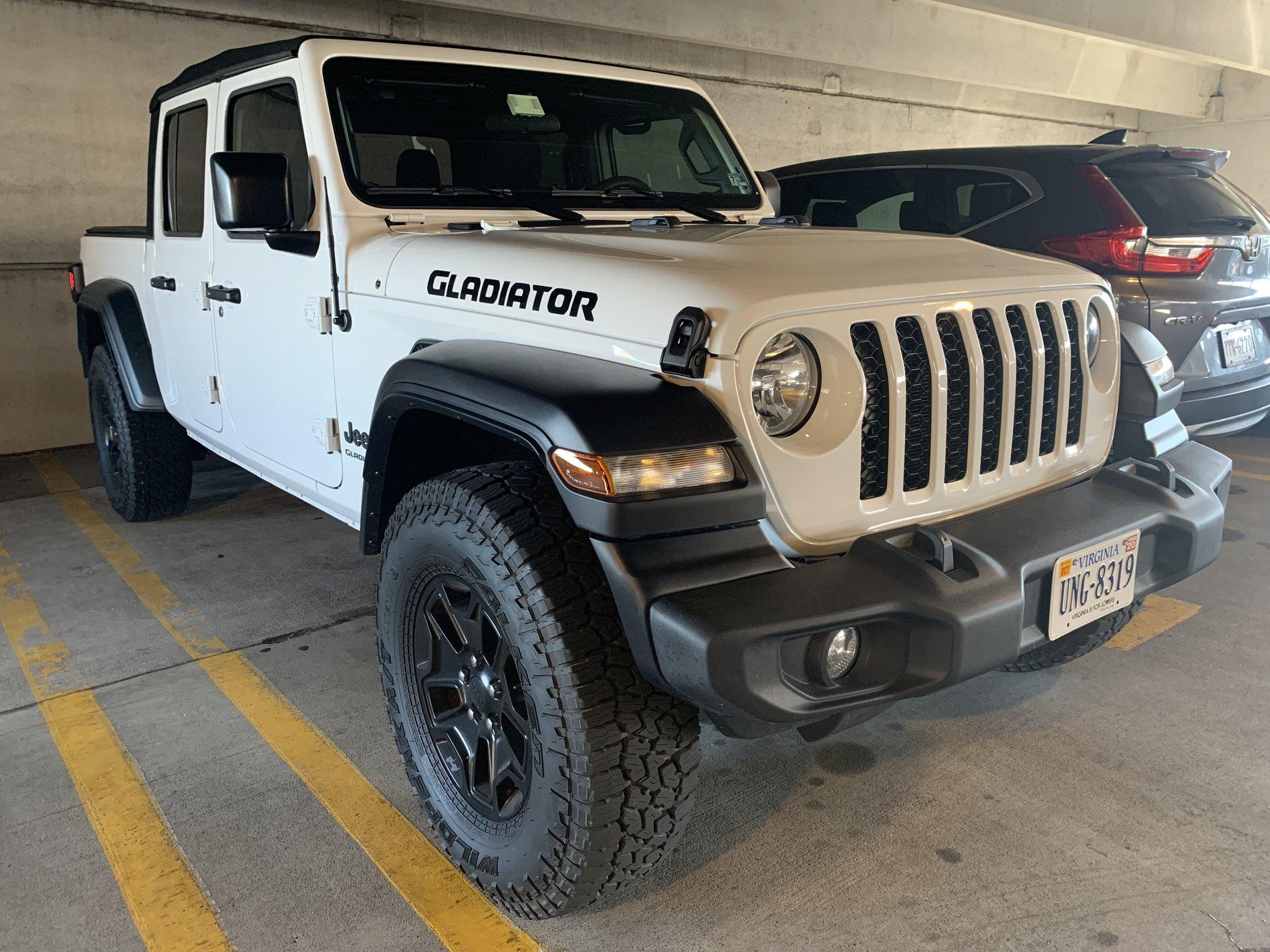

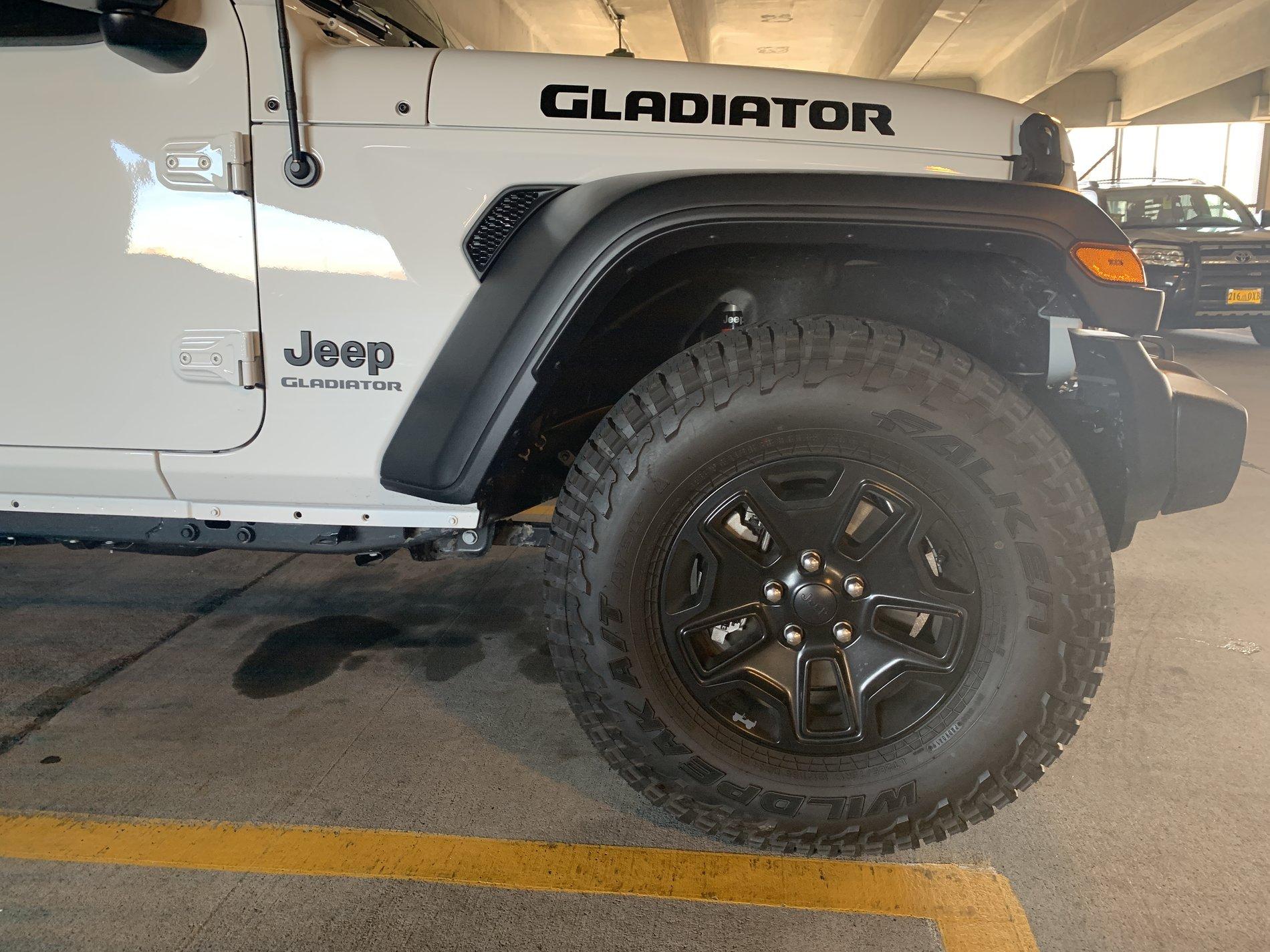

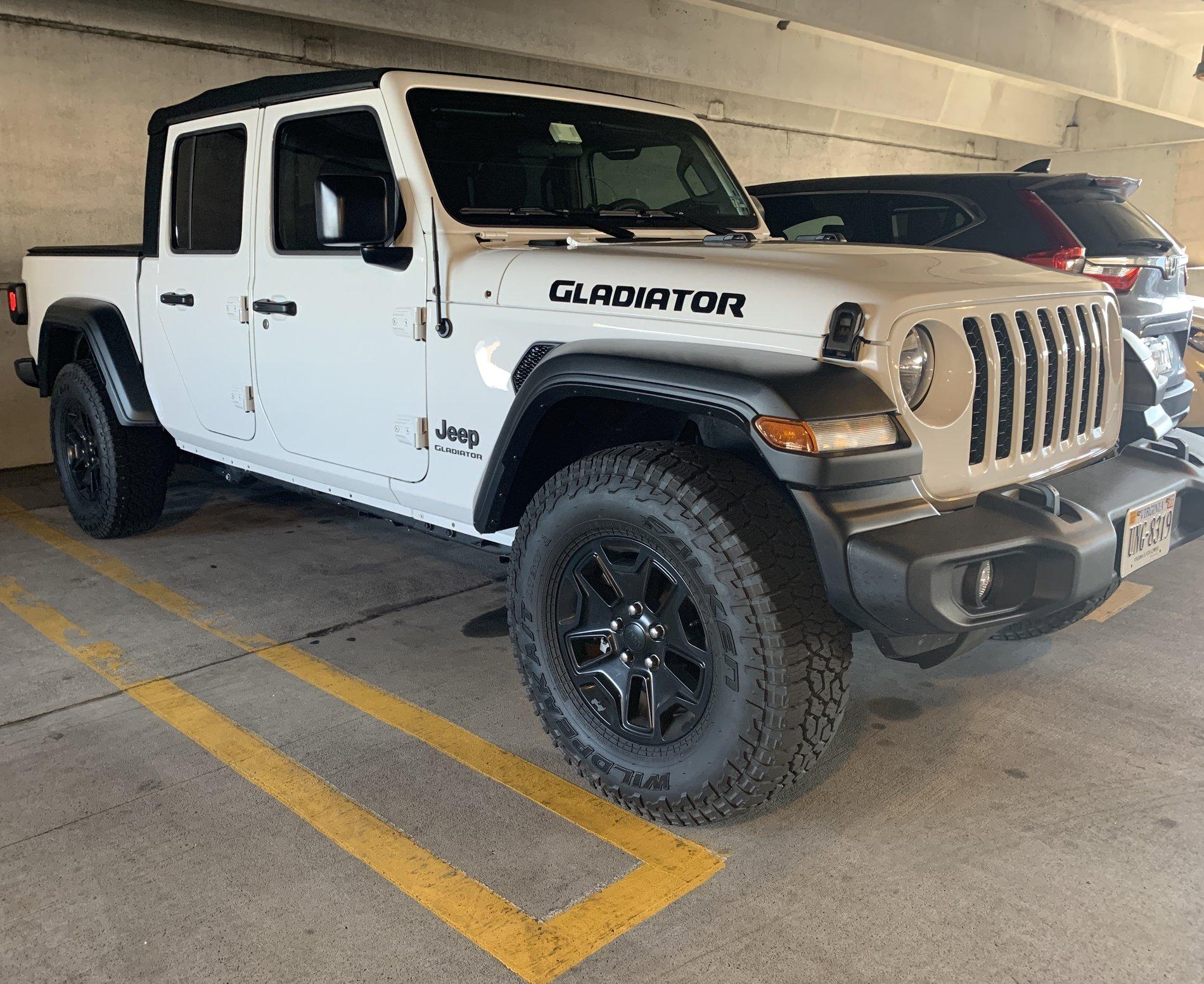

2020 MAX TOW MAX TOW MAX TOW, 4.10s w 1583 payload
Is it possible to put bigger tires and maybe a <=2" lift on a Gladiator Sport w/Max Tow without significantly decreasing its payload or towing capacities? I would like to put on 33" (or maybe 35") tires without compromising its capabilities. Only do light off-roading. Primary use of the vehicle is to haul stuff and to be comfortable on the highway.
If it is possible to increase the tire size, would appreciate any recommendations on specific tires that will have the necessary load and top speed ratings, decent off-road / snow traction, but comfortable and not too loud when driving with the doors and top off. Would also appreciate specific recommendations on what if any changes would need to be made to the suspension that wouldn't cause any decrease in payload or towing capacity, or highway comfort.
Thank you.
I did a LOT of research on this before I finally settled on what I did with my max tow.
Tire wise I went with 285/75r17 wildpeaks, which are close to 34s. To be honest there was no noticeable negative change in throttle response or anything really. I think it actually improved the way it drives, I run around 36 psi in the tires, handles better, steering is better, feels better towing. Tires don’t rub at all, and didn’t have to remove the bumper air dam. I threw on some rubicon take offs, which are the same size as stock rims. The 285/75r17s are the biggest wildpeaks you can legally put on the 7.5 stock rim. I actually prefer the tucked look, versus tires sticking out past the fenders. No issues with flinging you rocks or mud to the body. Only negatives I found were there was about a 1.5 decrease in mpgs and had to calibrate the speedo.
I decided not to go with a lift. A 2 inch mopar looks cool, but I don’t need it. Also it’s like $1300-1800 depending on where you get it and who puts it on.
Suspension wise I haven’t changed anything other than bought a rubicon takeoff suspension ($160). The only thing I put on mine was the Rubi fox shocks, which I think improved the ride and Cornering. If you swap out the springs it’ll lessen the towing and weight capacities I’ve heard.
I also threw on a fox IFP steering stabilizer. I think think this is the best bang for the buck. It definitely improved the stability going over bumps, especially bumps in turns. I never had wander problems, but I would say my steering is now excellent. Tight and no wander.
I’ve put 1600 pounds of flooring in the bed and towed my tritoon which is 7200 Loaded with the trailer. My Jeep does great and holds its own to full size trucks!!
Overall I’m super happy with my set up. Drives great, tows great and looks bigger than a stock rubicon side by side.
The first 3 pictures are without side steps, and the last couple are steps mounted. They are the mopar aluminum ones.. picked them up from a guy for $220 and he helped me put them on in his driveway, which was a killer deal. I will say it looks “bigger” and better without the side steps, but my wife and 5 year old needed them.
