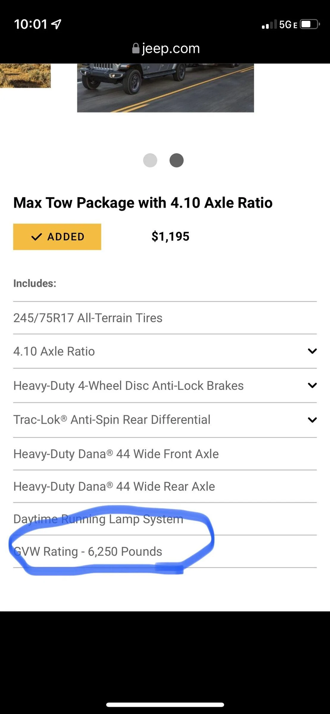

I may be behind the ball here but i thought the max tow rating use to be over over 7k??

That is an important stat to have circled, if you own these trucks as a work vehicle being over 6000lbs gvwr allows them to qualify for larger tax deduction. So a max tow package likely saves you money compared to the same truck without it. (If you use it for work)

GVW = Gross Vehicle Weight, meaning how much weight can be on the 4 tires of the Jeep.
GCWR = Gross Combined weight Rating, meaning how much total weight Jeep and Trailer can pull.
Typically the trailer weight is just a marketing combination with the heaviest trailer you can town in a perfect setup (180# driver, no passengers/load, ect....). Its usually very difficult to have the perfect setup.
For instance, if you fully load the jeep down and with all your passengers, gear, gas, ect... it weight 5500 lbs, and the GVW = 6250, you only have 750 LBS of tongue weight from the trailer that you could add before you are over the GVW. HOWEVER, the GCWR for a max tow is only 12,800, so your 5500lb jeep plus a 7500 lb trailer put you at 14,000, over your limit.

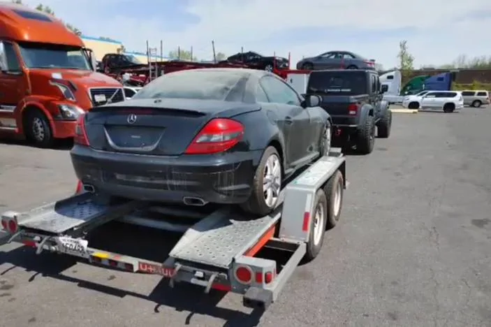

I posted this in a similar thread a while back but; sport max tow w/ 4" lift, 35s, still pulled this 6k load like a beast. Watched temps/rpms the whole way home, not a hint of trouble.
