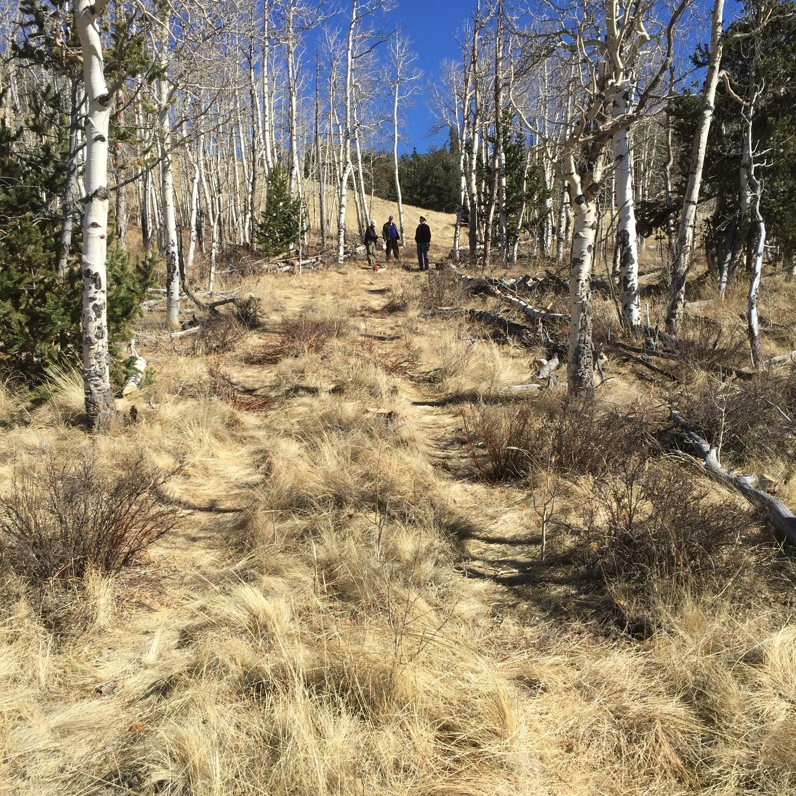

A modestly-relevant anecdote: A few years ago, my friend and I cut this "road" through an Aspen grove on my land in Colorado to be able to get vehicles back into the middle of the property.
My uncle in his F150, caught the vertical brackets under his side step on a stump we had created from a cut-down tree, and almost ripped his side step off. That couldn't happen to my JTR, especially in the configuration it will be in tomorrow.

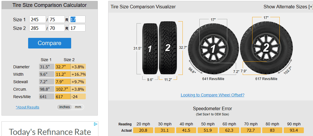

Stock tires on the Sport S Max Tow are the Duler AT 245/75R 17. I confirmed this today at my local,
dealership, which just got in a Sport S with Max Tow. The AT 245/75R 17s are about a 28.5 inch diameter tyre.
Whilst my JT is the standard tow, with the limited slip diff., I have the same tyre.

I thought Max had 32's and Rubi had 33's

Yeah, by manufacturer listings the Rubicon tires are 32.8" and the Sport/Overland tires are 31.5".
While mounted on the Jeep, measured in a straight line rather than including the sidewall bulge, they actually measure out 32.2" for Rubicon, and 31.0" for Sport/Overland.

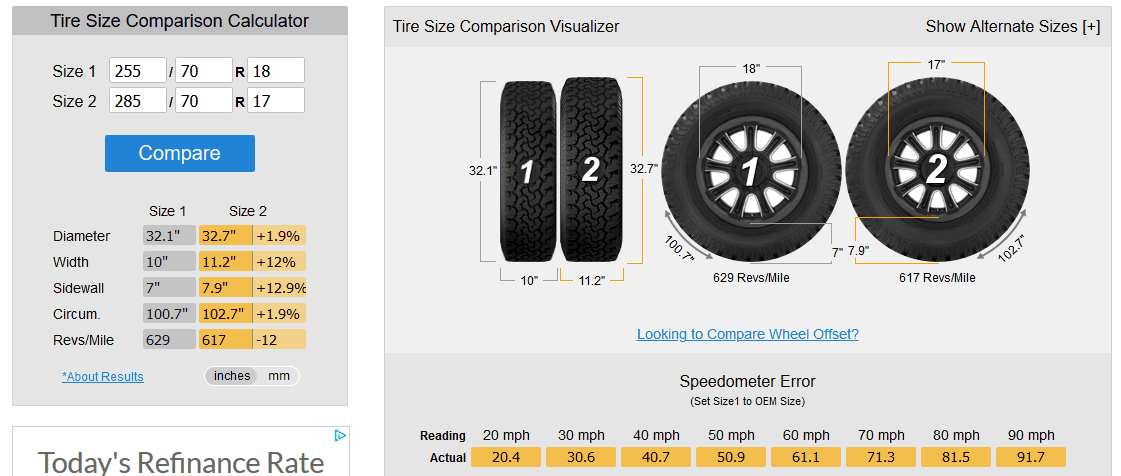

Tirerack and others say my Overland tires are 32.1" .
Here are the details copied from TWO different tire sites -
Stock Overland tires - Bridgestone Dueller H/T 255/70R18
diameter 32.1",
width 10.2",
mounts on a 18" rim
649 revolutions per mile.
weighs 45 lbs,
max load of 2535 lbs,
maximum air pressure of 44 psi,
tread depth of 11/32"
should be used on a rim width of 6.5-8.5"
Since the Rubicon tires are 32.8 that means there is a .7" difference. In other words, there's not even a 3/4" difference in diameter.
Figure half of that is below the hub, you have the Rubicon tires on an Overland raising the truck ----------- wait for it.................... a whopping .37" To know how much a tire raises the vehicle, you use the radius, not the diameter.
WHOOO-HOO! Big whoop. Who's going to notice - oh, my neighbor will - hey Bill, I see you lifted your truck! Yeah, Larry will notice that < 3/8" difference the truck sits up.
No wonder no one recalibrates the speedometer for Rubicon tires on an Overland. What's that, a couple less revolutions a mile?

Funny how if you go to 6 different tire sites you may end up with 2 or even 3 different dimensions for the same exact tire.
