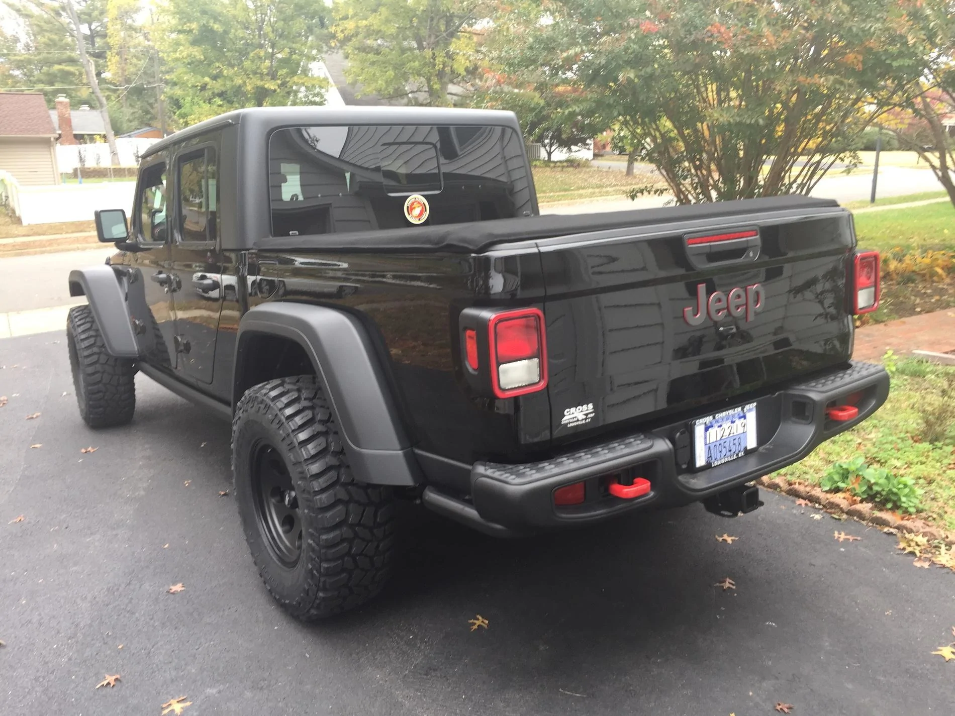

I'm at the other extreme. I am fairly cautious and will get someone to spot me if there is anything concerning to me. I think my uncle, whose truck tries are fairly tucked-in, cleared the stump without hitting it with the front tire, but as he was turning a bit, caught it on the step bracket. That's one of the reasons I like having my tires out a bit:
If I'm being fairly-prudent, and don't catch something with my front tire, I'm less likely to gouge other parts of the Jeep on it.
What lift / wheel / tire do you have? And, very interested in the exact spec of wheel because the spacing looks perfect. Nice work man.
