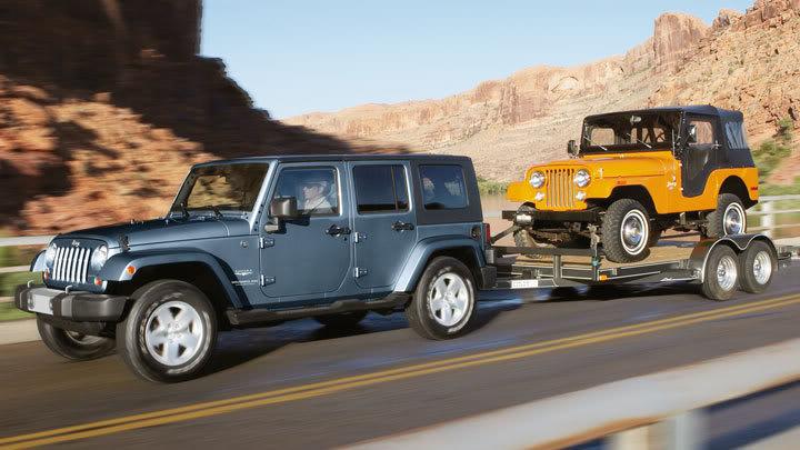

Something FCA needs to consider is that if they continues to cripple the Wrangler's capabilities then stop making and showing marketing material like the image above implying any type of serious capability in towing. Don't show it towing more than a seadoo or pop-up tent trailer, and even then... just don't.
Either improve the capabilities or stop implying it's capable, and you can't get away with that crap in the truck market with a weak JT, they will eviscerate and mock it, and it will never recover from that kind of launch.

Might be tough though? JKU's towing capacity is 3500 lbs. JKU Sahara weighs about 4400 lbs. So towing capacity has to go up by almost 1000 lbs.
Hope they do it though... I'm just imagining a JT in front and JK in back. :involve:
How much weight do think is being towed in that picture?

It definitely is purposely underrated on paper (official specs). The JKU can tow well over its 3500 lbs official tow capacity. I've seen a friend tow a Ford Bronco on a hauler across Washington in his JKU Rubicon w/ 6 speed. The Bronco weighed about 4200 lbs and the Hauler about 2000 lbs. That's 6200 lbs!
