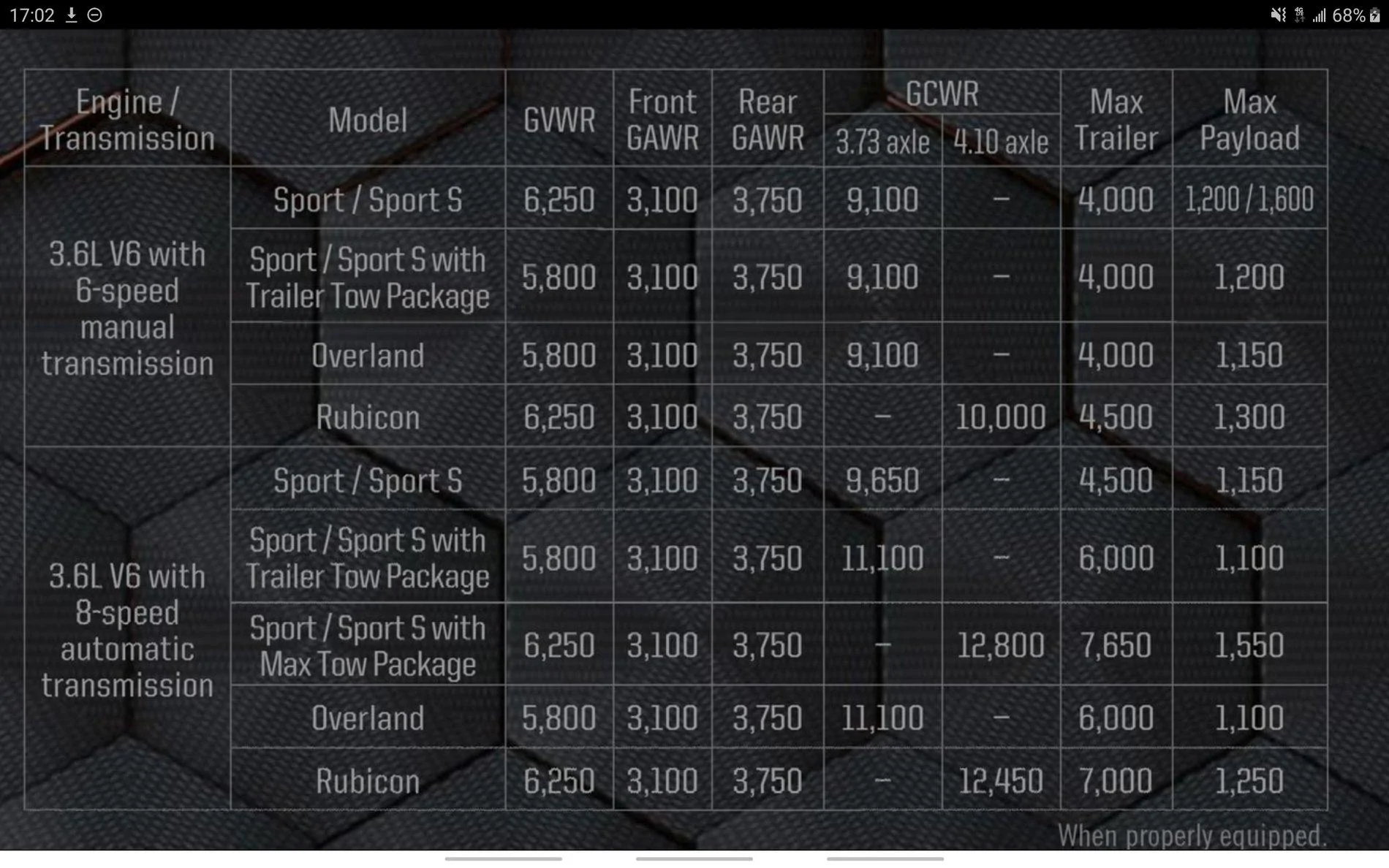

Online I have see Max Payload of the Overland being 1,120.
The door jam says 1,045 if I am reading it right.
I've researched this extensively as I had a lot of confusion with the Sport S and Base Sport's payload, and wanted to make sure I got a configuration with max payload. When I get my Manual Sport S no tow package I will be posting a photo of the door card to show off my 6250 GVWR and 1600 lbs of payload.
the difference between 1200 and 1600 is not a 400lb//10% accounting for trailer tongue weight. The max payload configurations actually have different springs.
Basically, only Automatic Sport S and Base Sport with Max Tow and Manual Sport S with no tow package get max payload.
I'm guessing you bought an automatic. Your payload will start at 1,100 and the rating on your door card will drop from 1,100 depending on how much equiptment the factory sips with it. Payload is everything in your bed, equiptment you bolt on and passengers in the truck.
Jeep Gladiator Max Payloads? Screenshot_20190816-170240_Chrom
if you're unsure posta photo of your door card and I can confirm where on this table you are. Also do you have auto or manual?

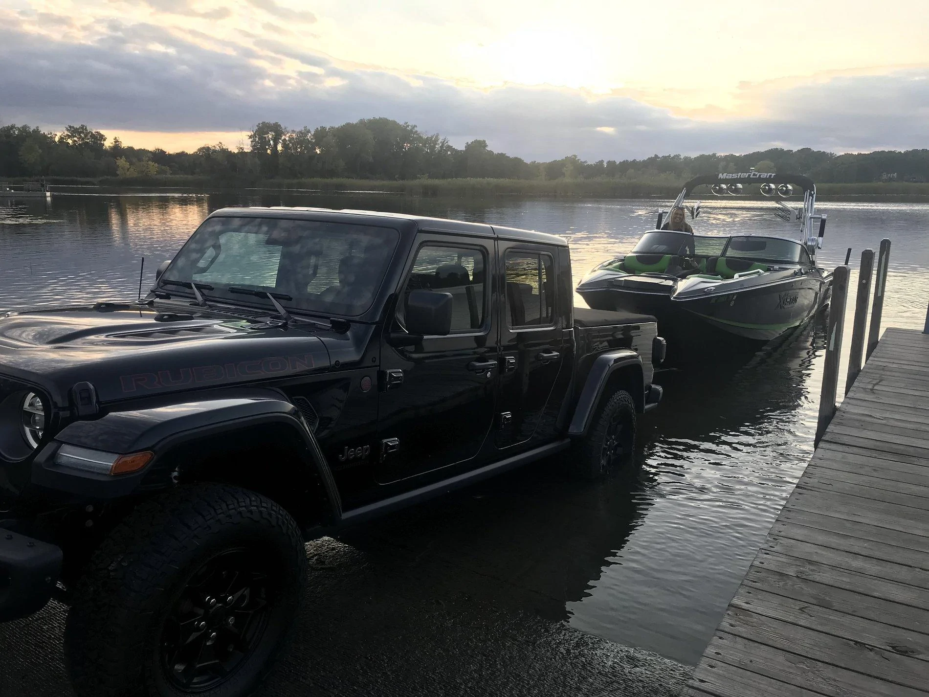

Okay I’m probably going to get shot here but I hauled out my 5,000lb MasterCraft XStar on it’s 2,000lb trailer and dropped it off at the dealer for winter storage. I have the LE, yes I completely understand this is at the outer limits of its capacity, but never had to drive faster than 45Mph on the 25 mile trip. Honestly it did great for what it is, I was extremely cautious the first time towing with this truck and it exceeded my expectations. I am not naive enough to think though I would would want to pull this load at 65 mph for a couple hundred miles. I’ll rent a F350 for the weekend if that’s ever a necessity. G damn I love this rig!
