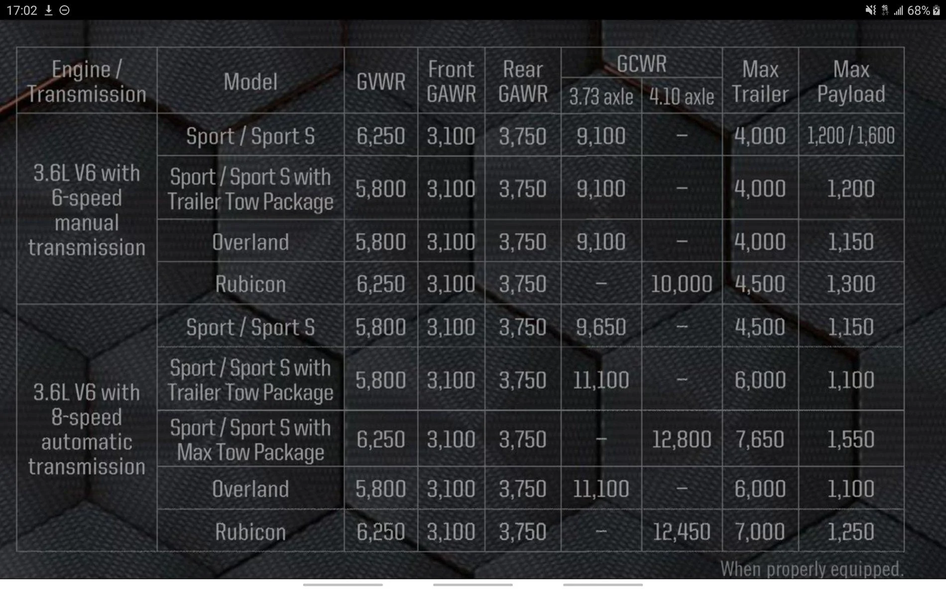

Hey i'm sorry everyone. I only every pay attention to the manual transmission options. I was told this chart below is accurate (+/- options) by @JeepCares
Jeep Gladiator Some confusion on max payload Screenshot_20190816-170240_Chrom
so yeah, Auto base sport with max tow = 1550
sorry I was thinking of the manual base sport = 1200
They must of intended to all along since the chart lists it as sport/sport s max tow.
After checking some vehicles at the dealership this weekend...This chart is half correct. :(
In fact the payload listed for Sport/Sport S with NO tow package is basically correct. 1200ish for Sport and 1600ish for Sport S. However, the GVWR listed should read "5800/6250" because a Sport with no tow package is 5800, and a Sport S with no tow package magically gets the 6250 gvwr. (This is all concerning the manual transmission ONLY)

so that chart above states that my Sport S with Tow Package should have a GVWR of 5800lbs, but my window sticker says 6250lbs. I am assuming the window stick takes all my accessories into account...right?
