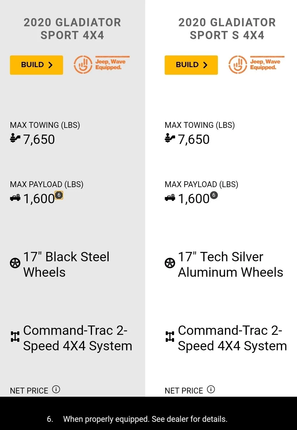

@WXman that's super frustrating... I have still have yet to find a dealer that knows...
Jeep Gladiator max payload Screenshot_20190818-222944_Chrom
what, "1,600 when properly equipped" means.

It's entirely possible we'll have to wait until our preferred combination (Sport manual with tow package for me) hits a dealer lot so someone can check out the payload rating on the door sticker. There are a lot of combinations so I suppose it was difficult to distill them all into a simple chart.
By the way, @basicGlad , I think the 400 lb tongue weight being the same as the max payload difference is a coincidence. I've never seen the recommended tongue weight of your max towing capacity subtracted out like that in other truck specs. Afterall, no one is going to be driving around all of the time towing a 4000 lb trailer. When there's nothing back there you should be able to use that capacity for more stuff in the bed or cab.
I think the key is in the GVWR column. There must be two rear suspension options for the Gladiator (probably mostly the springs). The max payload would be attainable for configurations that get the 6250 lb GVWR and have a lower curb weight than the Sport max tow or Rubicon options. The rest would get the 5800 lb GVWR which presumably trades payload capacity for a softer ride. This is why I'm so interested in solving this little mystery. If I knew a Sport manual with tow had a 1200 lb max payload but the Sport S manual with tow had a 1600 lb max payload I'd probably move up to the Sport S just for that. 1200 lb is in the barely adequate range for my needs.

@giskard we should try compile a real world table. I am only interested in manuals as that's what I am going to order. And I am in the same boat... I want a Sport Base, but would upgrade to Sport if it's 1200 vs 1600 payload. However if you look at the previous image i posted, jeep does list on their website both Sport base and Sport s get 1600 "when properly configured". You cannot get max tow on a manual.
A local dealer has a Silver Sport S Manual with regular Tow package and the GVWR is 5800, 1200 Payload.
I have yet to find any other manual Gladiators. But there would only be:
  1. Manual Rubicon
  2. Manual Sport S w/o Tow package
  3. Manual Sport S with Tow package
  4. Manual Sport Base w/o Tow package
  5. Manual Sport Base with Tow package
