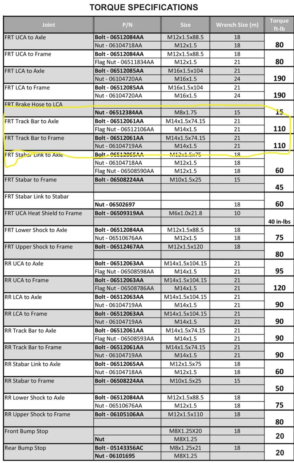

@DailyMoparGuy Looks like I had my bars crossed lol .. The track bar is fine, just my part identification as a newb is showing ... The tie rod and steering drag link .. They both have the slightest bit of play vertically and from what Ive read its normal .. so the clunk remains until I can get to the shop .. Crazy how it only happens when I apply the brakes at slow speed backing in/out ..

It’s weird that multiple people are reporting this issue lately. I had the same issue for a couple of weeks but it went away and I haven’t been able to replicate it. Hopefully yours gets sorted out. Like someone else mentioned, check the control arm torque and front sway bar torque as well.
