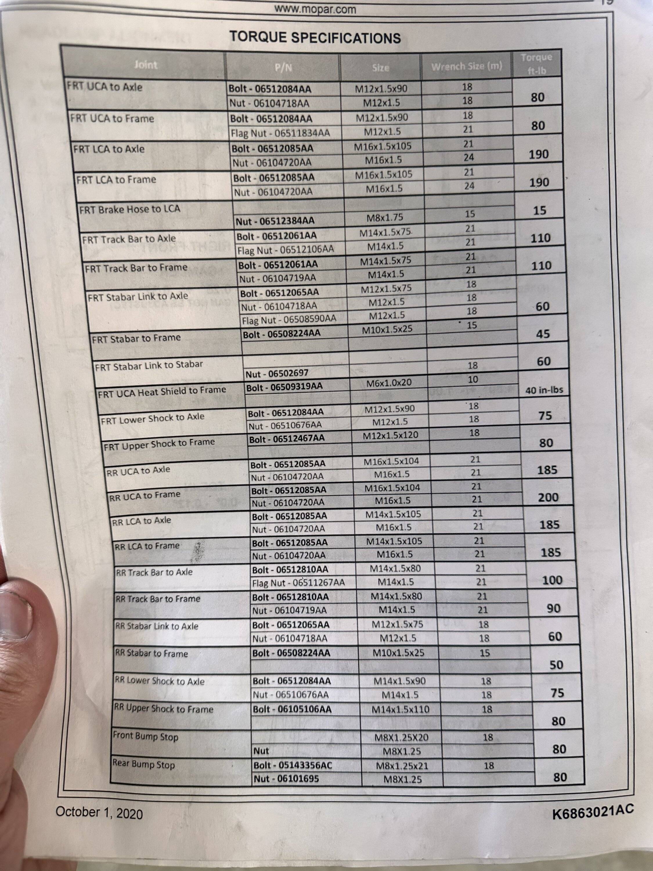

Case in point: I think I’m getting creaking from the new front UCAs, but haven’t confirmed. Definitely want to figure out how to resolve…

Yep. Lowers torqued to 190 ft-lbs. Uppers to 85 ft-lbs.
That's loose. That's MOPAR lift kit specs and it's loose.
The upper has a front and rear bolt spec and they vary.
I believe the front is 41 plus 185 degrees and the rear upper control arm bolt is 111 plus 95 degrees so before you even added the number of degrees of additional turns, your upper rear bolt is already loose if you only did 85.
Torque them to proper factory torque after it's sitting on the ground. Loosen the bolts, jounce it, then torque it properly. Some of the specs floating around out there are just too loose and aren't factory specs that the techs use when repairing or rebuilding these things.
I'm surprised the MOPAR lift kit instructions are so very loose on their torque specs - maybe those are old specs from old lift kits, but it's way loose.
Rear lower control arm bolts, for example, when using the factory torque plus degrees is over 200, not 190. And 85 for lowers? Not sure where that number comes from - just the torque before applying the final number of degrees turn on the fastener is 111 so 85 is crazy loose.
That doesn't apply here to the OP's noises looking at Crazy Cooter's posts, but still - there's a lot of JTs out there with under-torqued parts.

Interesting - I was using the factory spec of 80 ft lbs for the front uppers. Haven’t changed any other control arm yet (at least not to the Core 4x4 stuff, I changed using Mopar stuff as part of original lift last year).

@ShadowsPapa Do you know what the correct spec is for the front uppers? I loosened and rocked the truck a bit (on level ground) and about to re-torque. Not sure if I should stick with 80 or go a bit higher. Also probably doesn't help that the axle mounts are a hair larger than factory and so they end up bending/crushing a little with torque.
edit: missed your other post - not sure where you got those pics, but yea...that's a lot more :/
