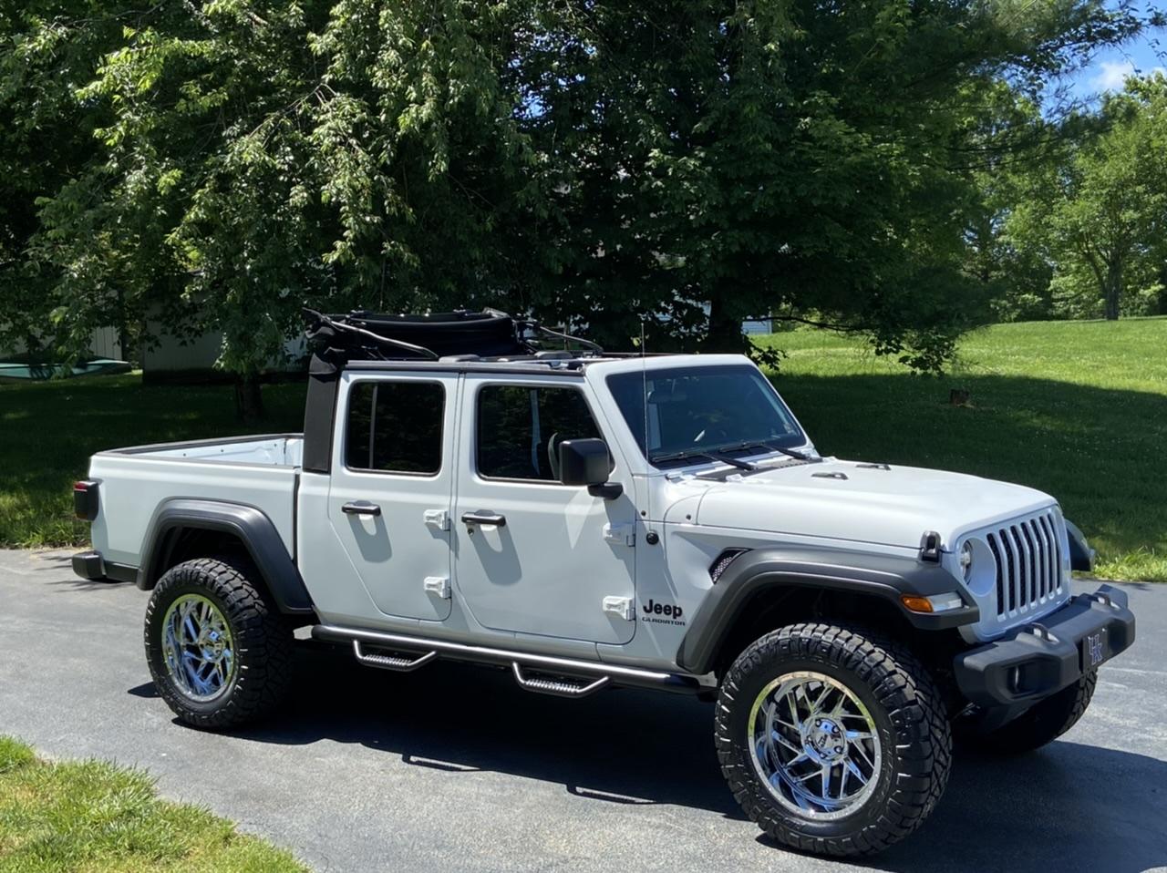

Does anyone know if 33 inch tires would not kill your power as bad as 35 inchers, and do the programmers help very much with power?
