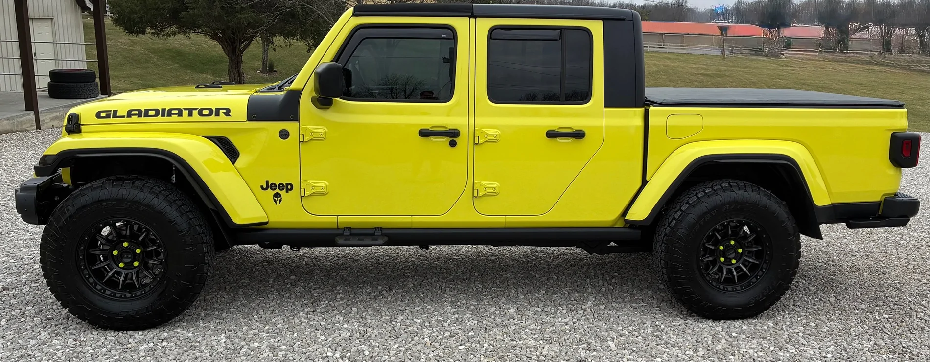

Thank you. Nice ride. Lemonade looks good.

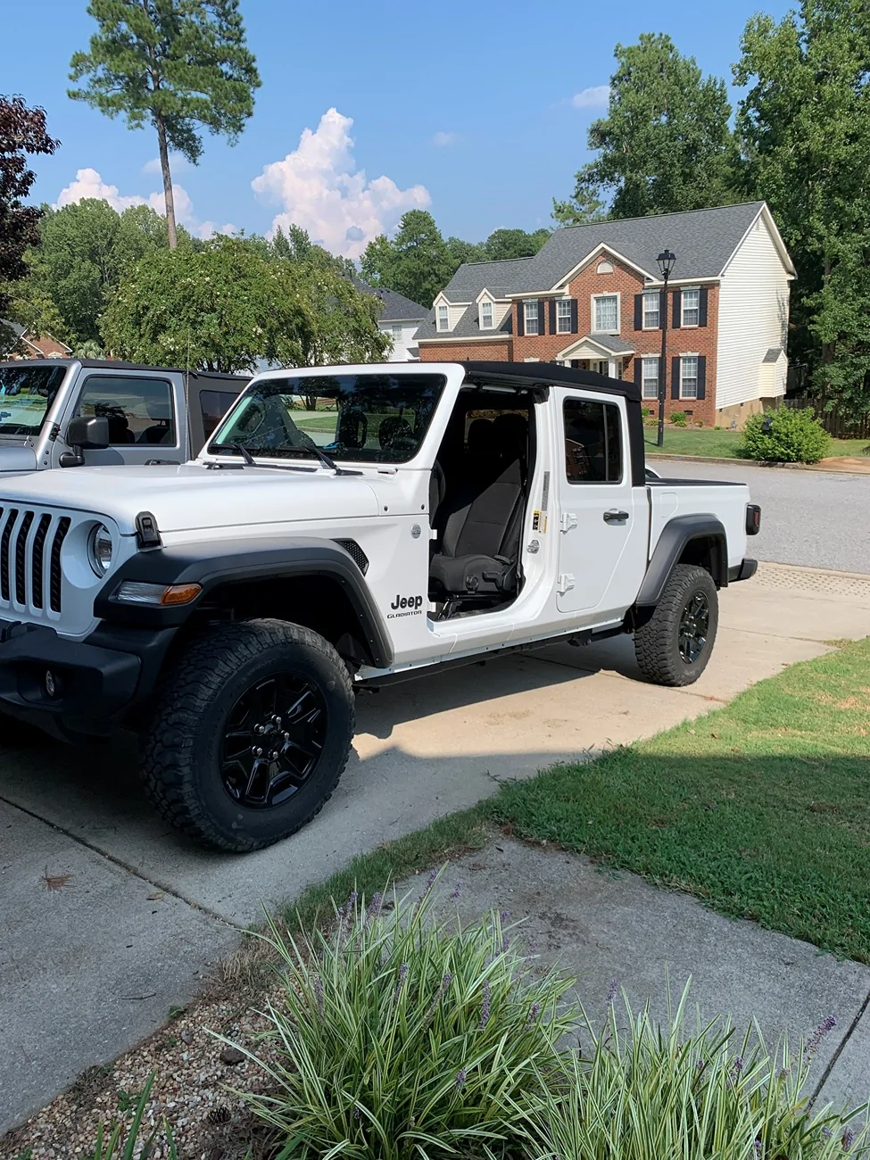

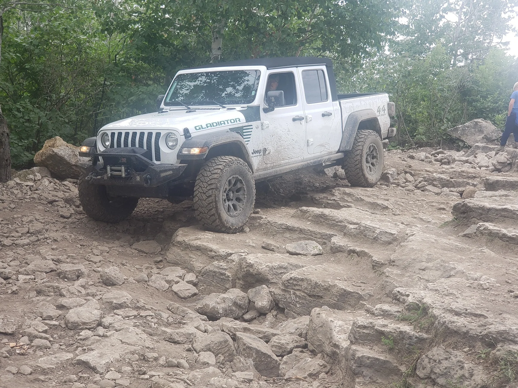

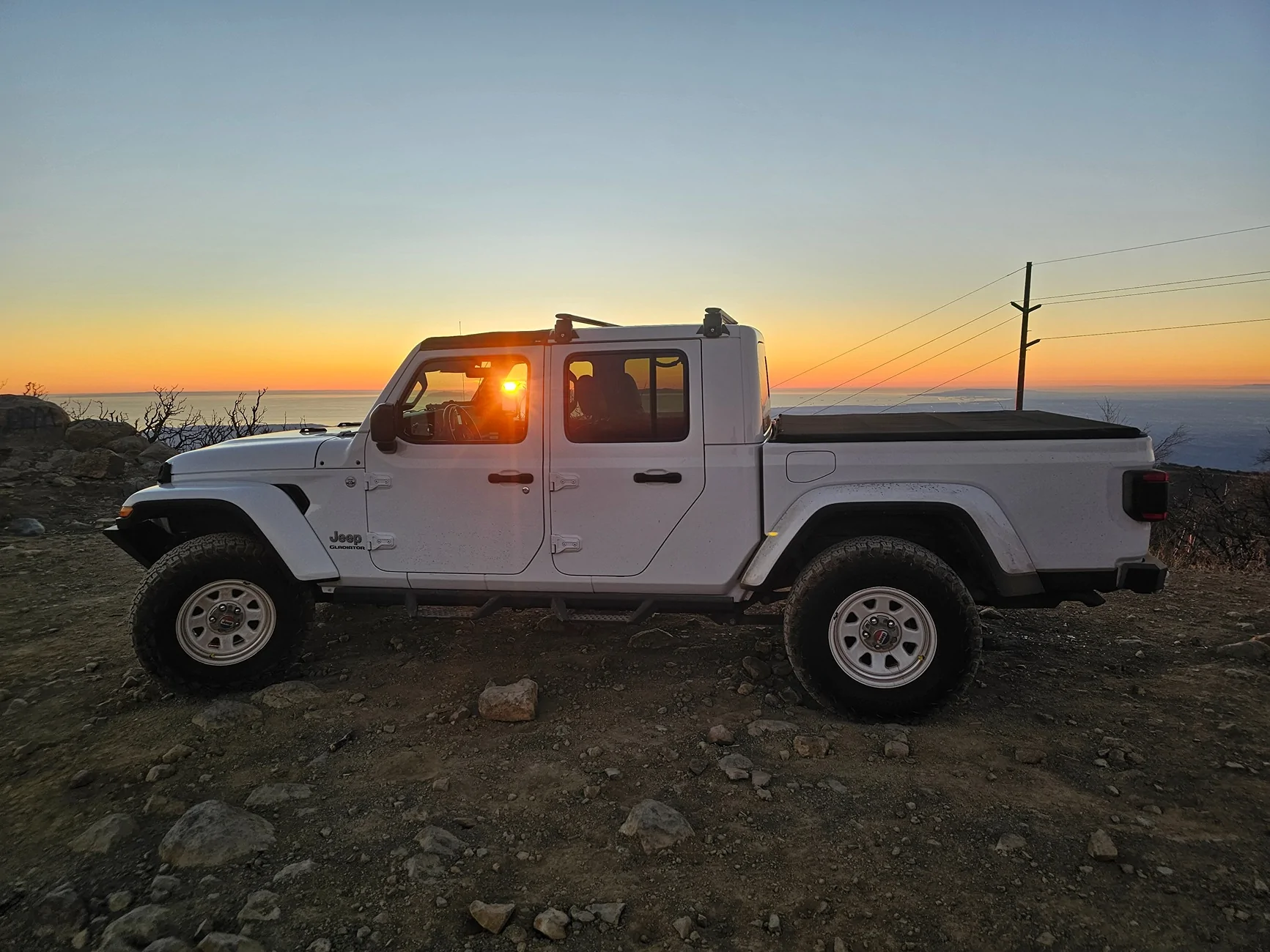

teraflex front spacer kit on 315/70r17 bfg ko2s. they rubbed the lower control arm at full tilt with stock willys rims. this is sport, non max tow with 3.73 gears.
i no longer have this jeep, old photos.

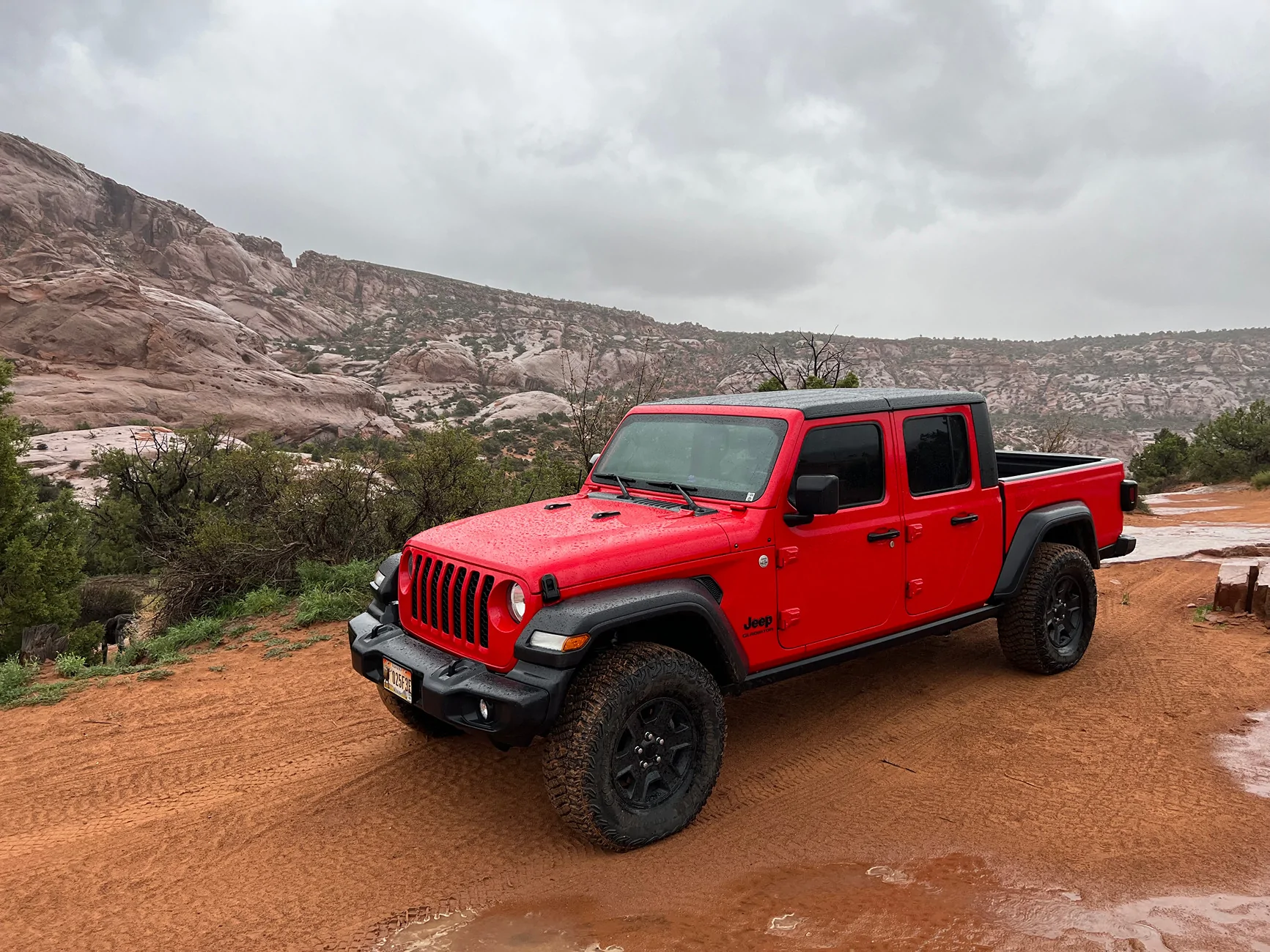

Had 35's back in 2020
2.5" front with winch and bumper. 3/4" in rear

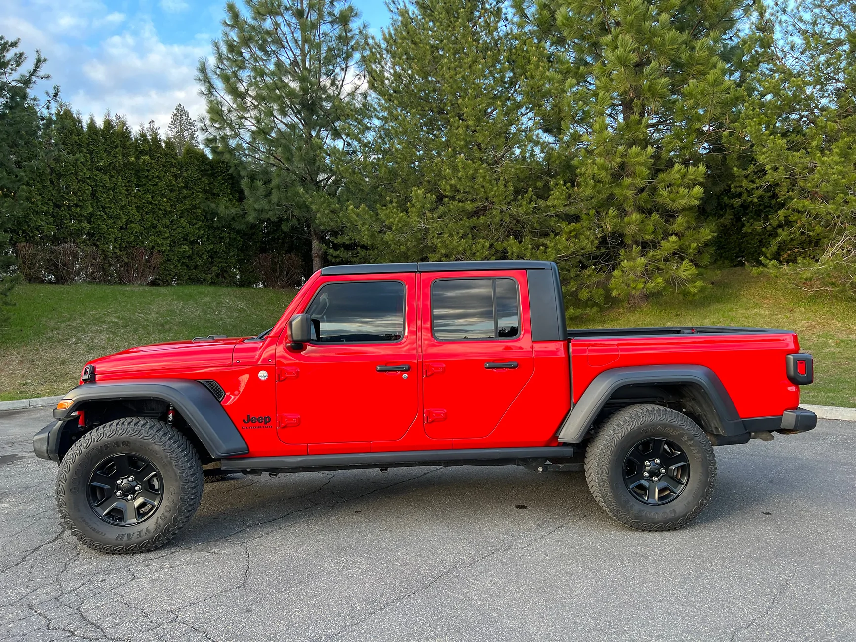

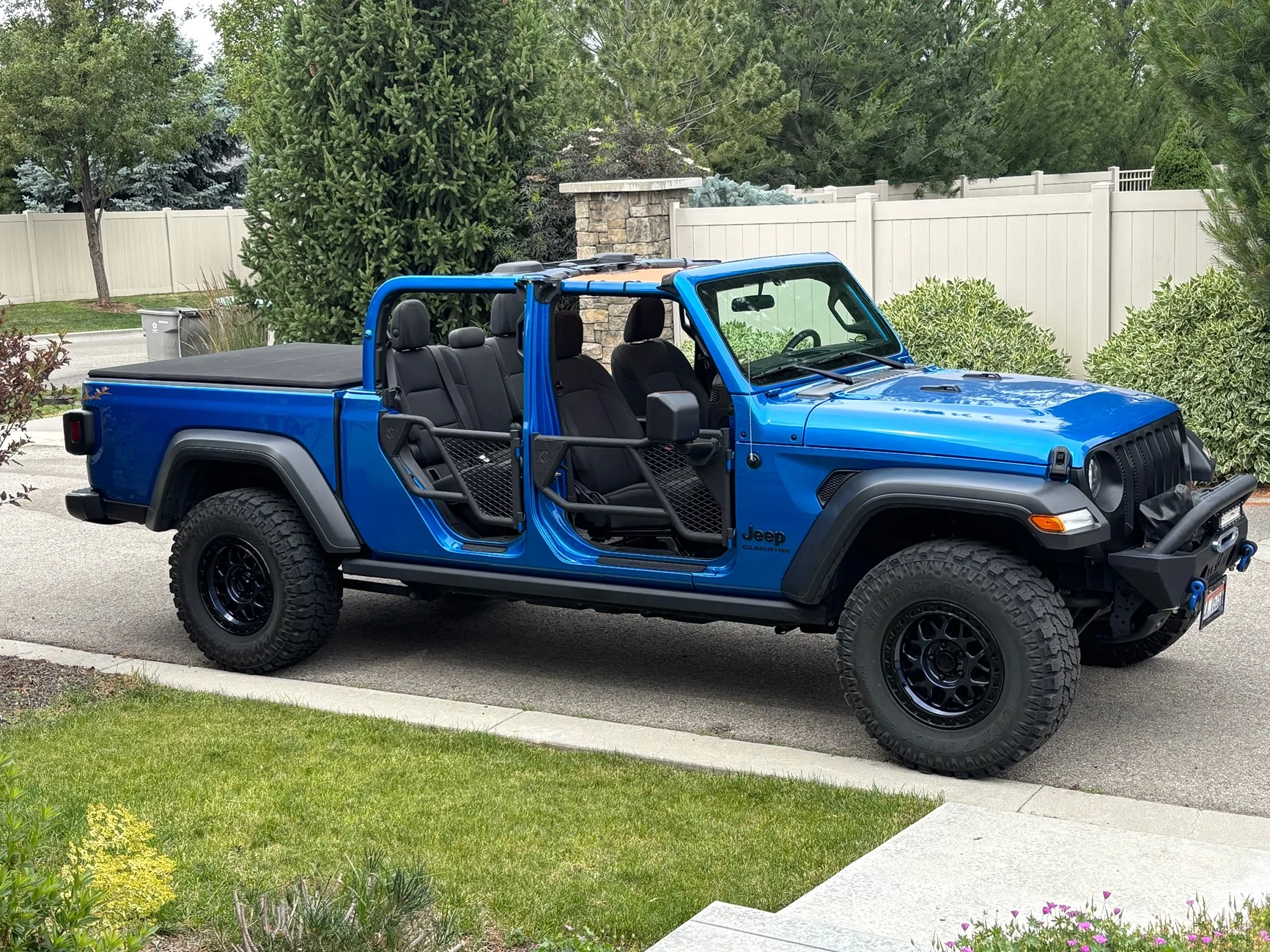

This is Rubicon springs with a 3/4" front spacer so about 1.75" in the front and 1" in the rear

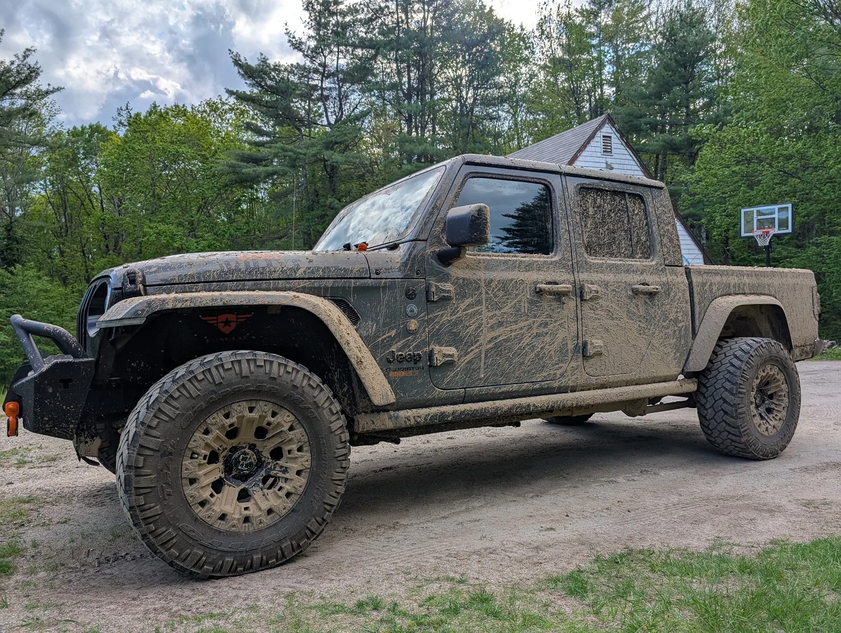

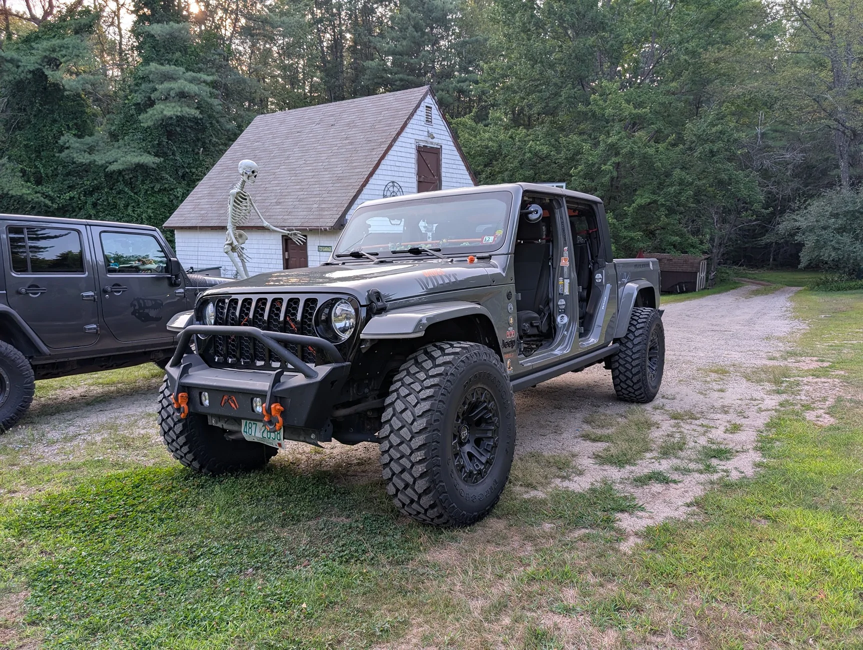

Here you go, first pic is 34" on teraflex leveling kit. Second is 37" on teraflex leveling kit. Sorry can't seem to find my 35" winter tire pics. I've had fun trying to get high without throwing away a lot of perfectly good stock parts.
