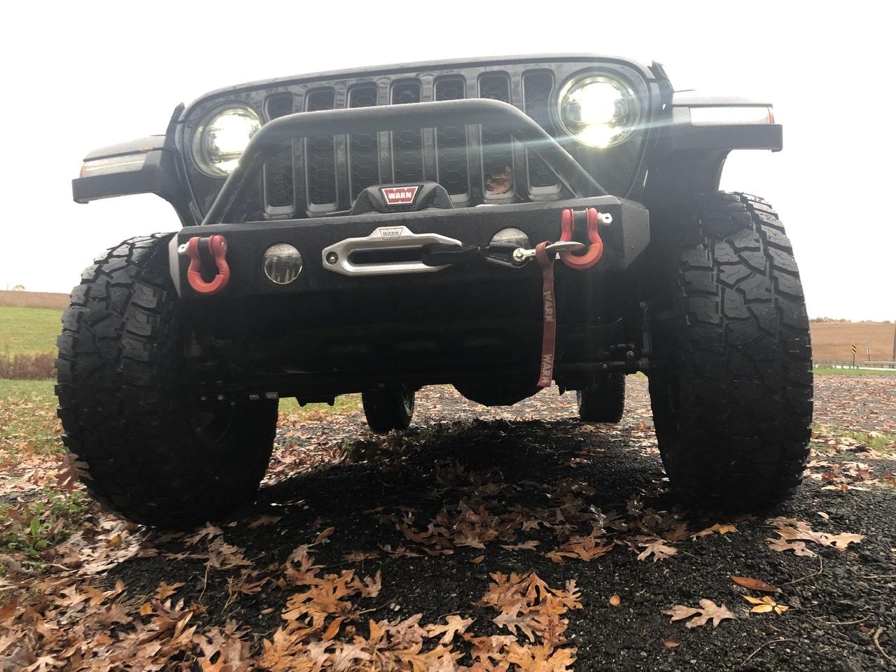

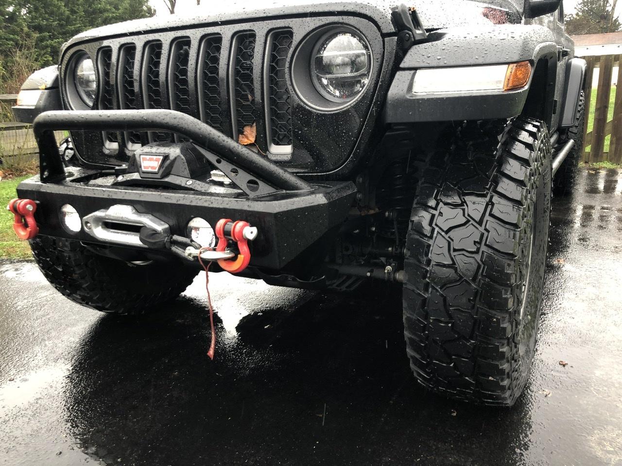

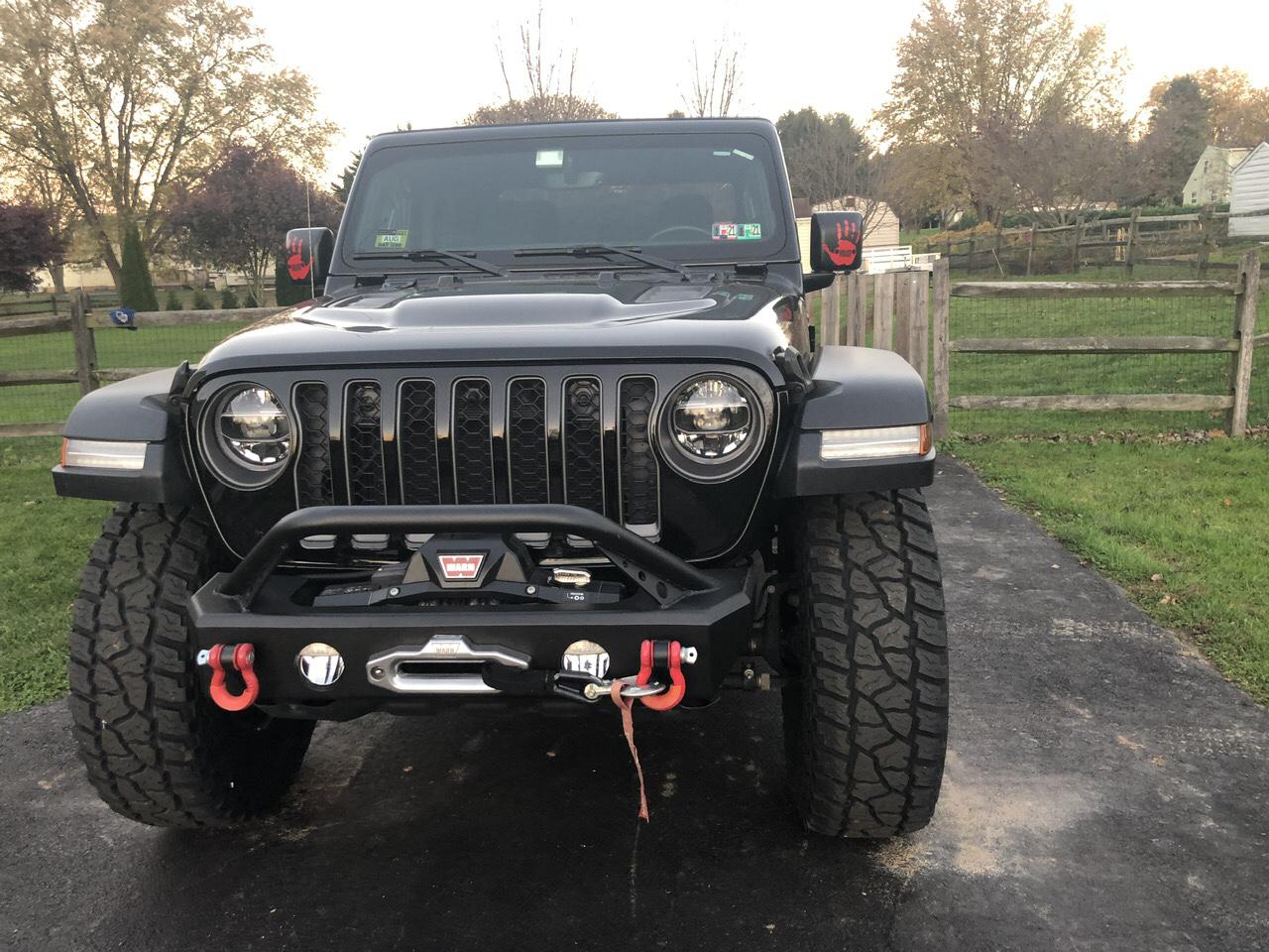

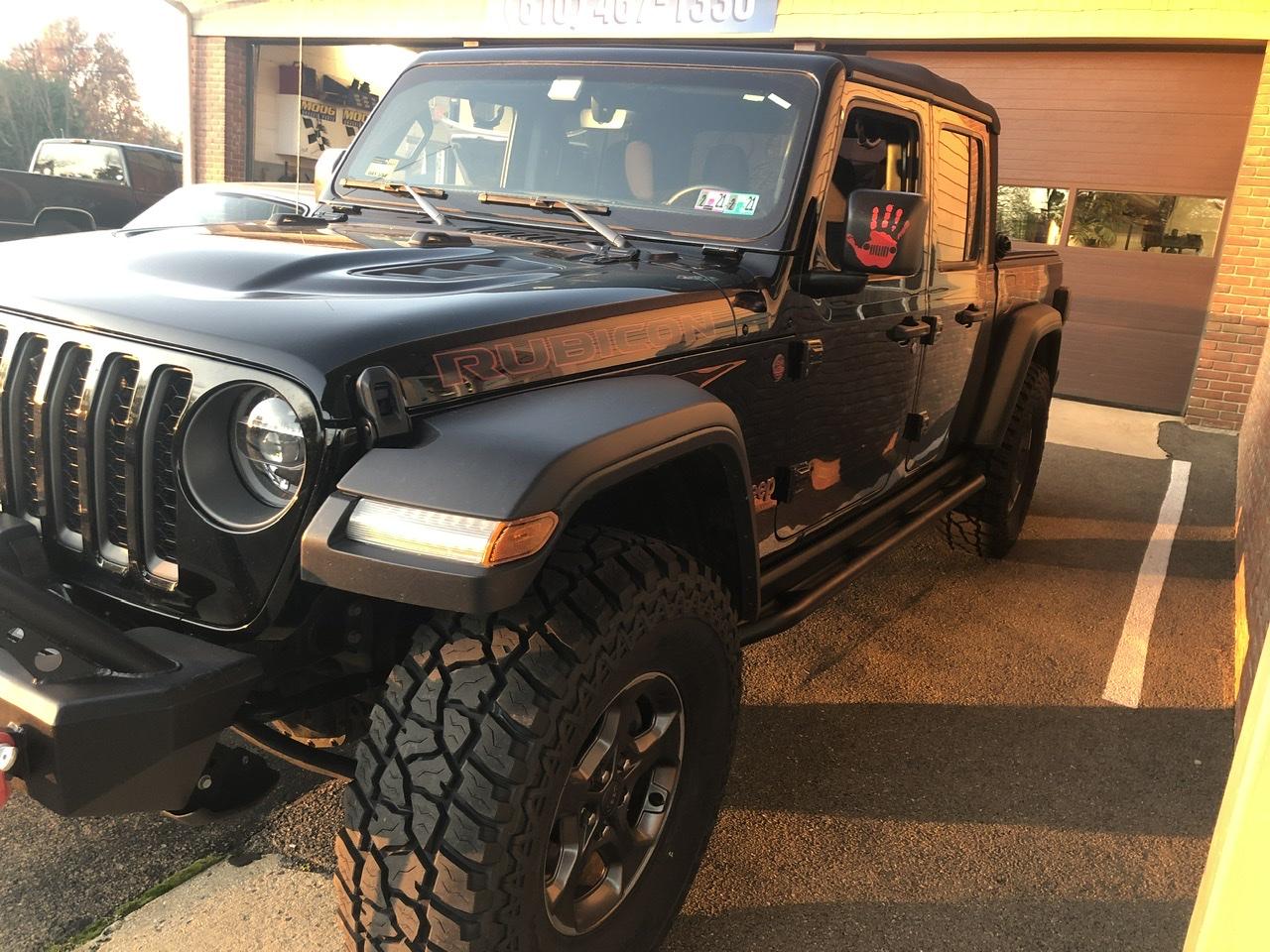

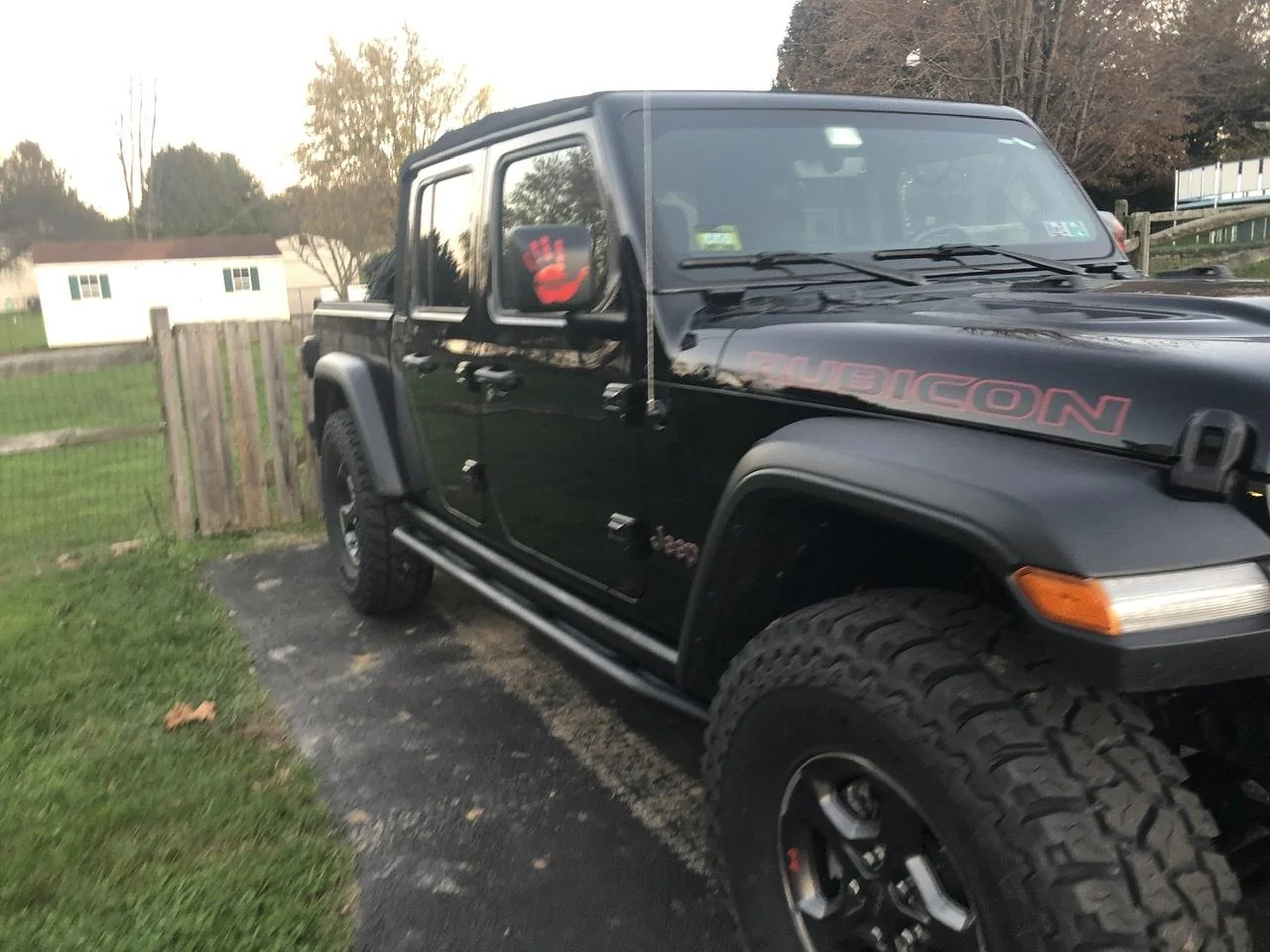

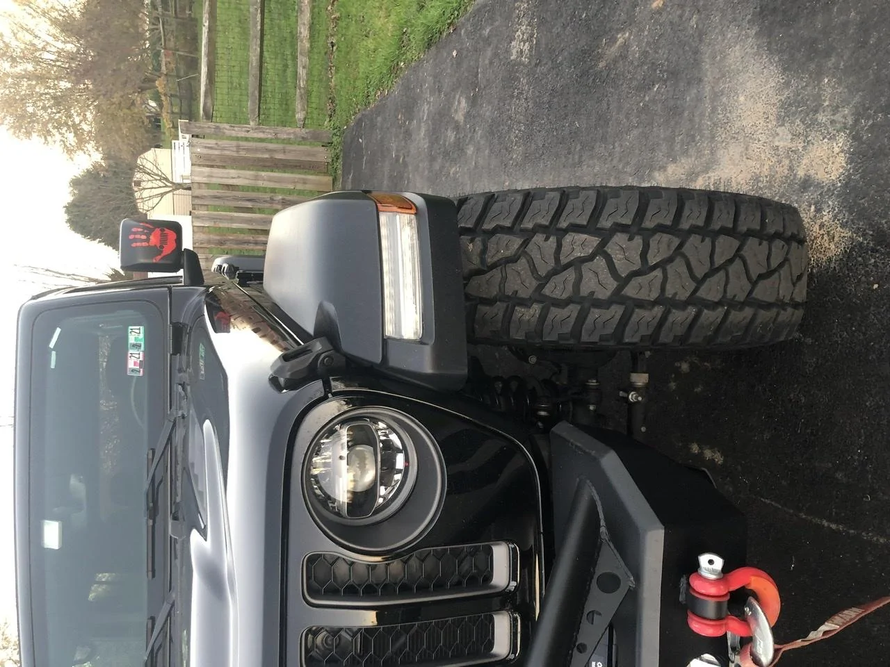

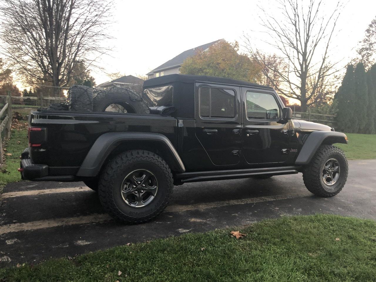

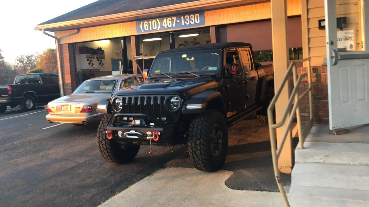

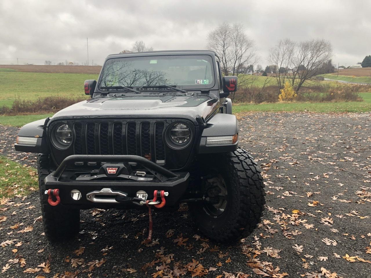

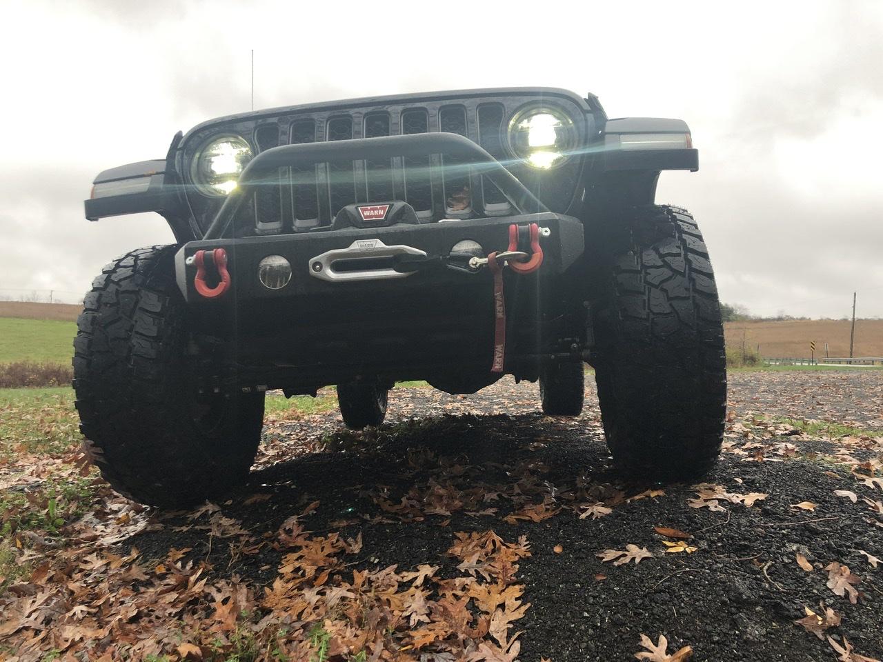

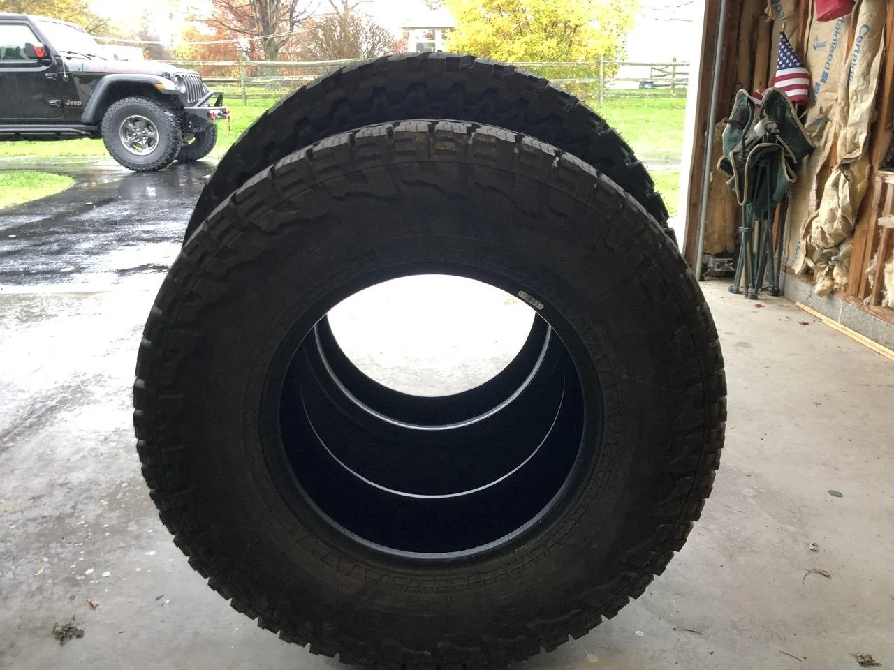

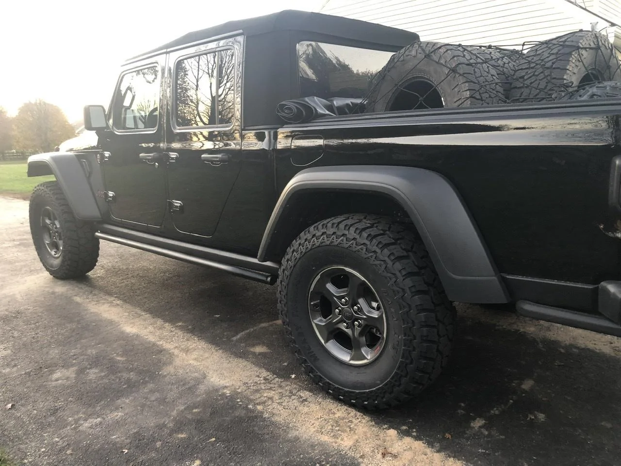

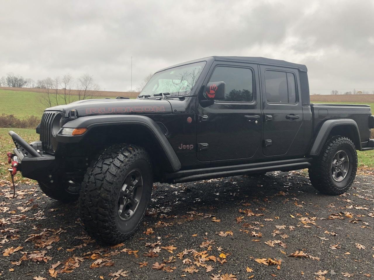

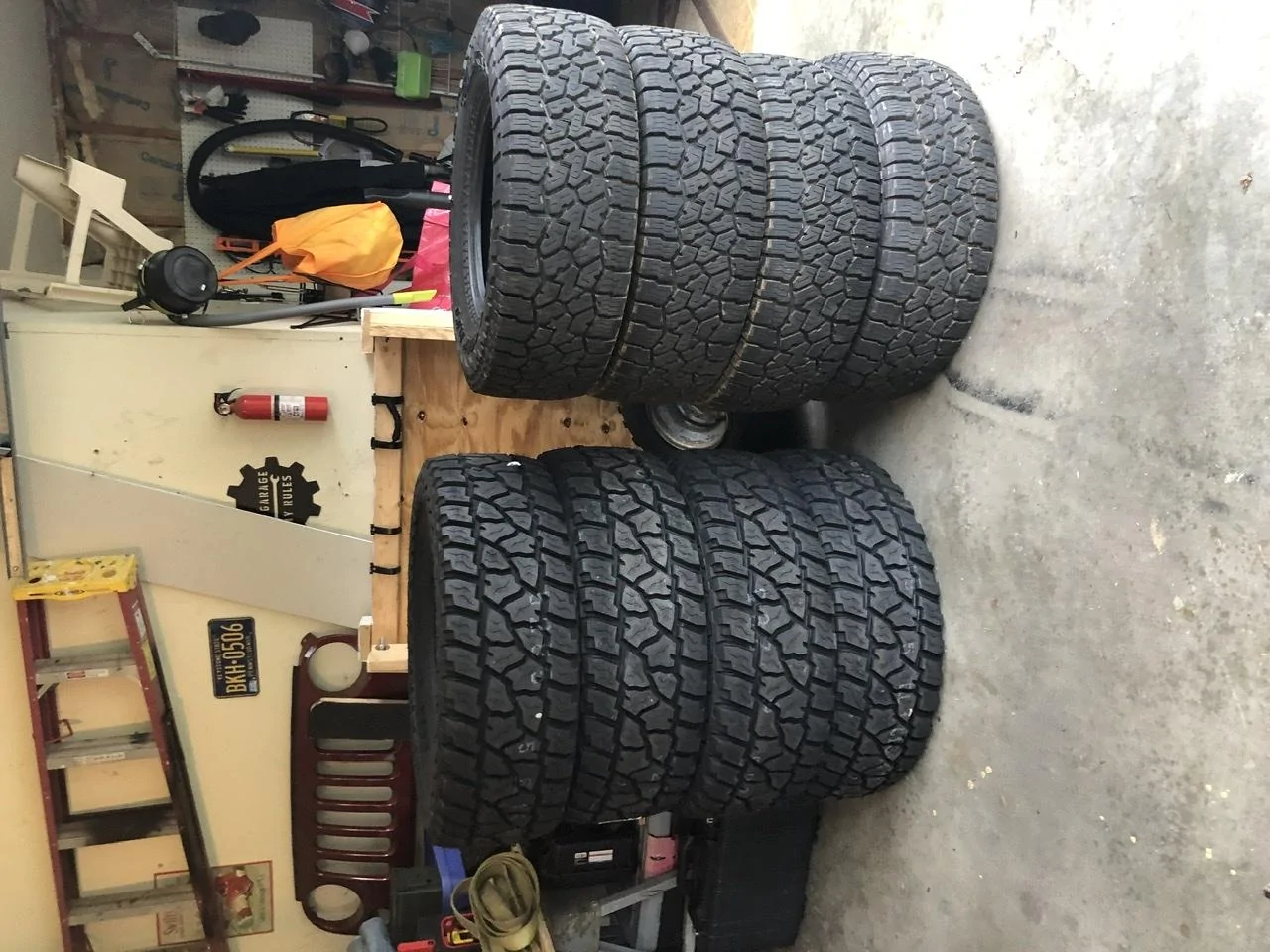

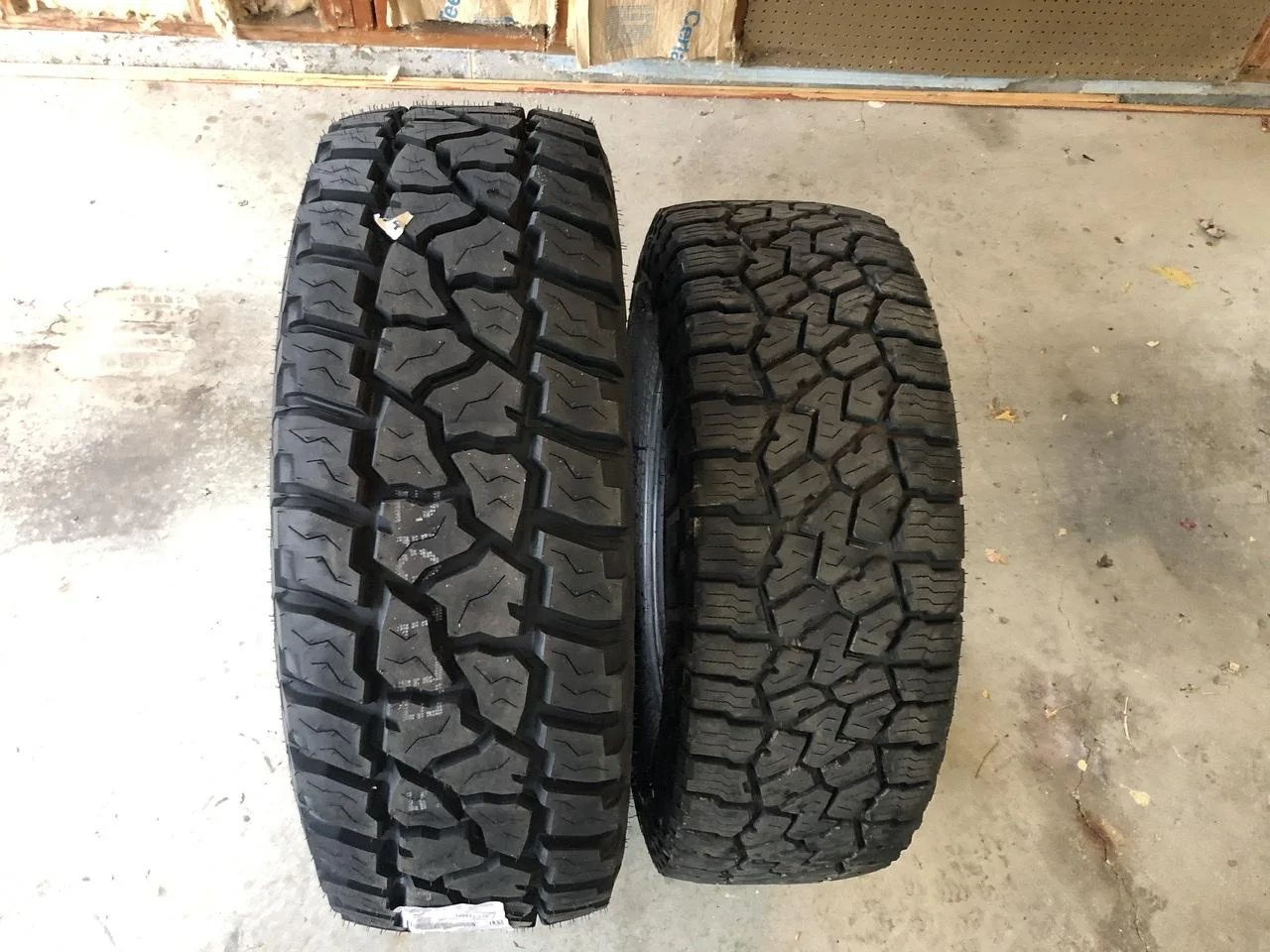

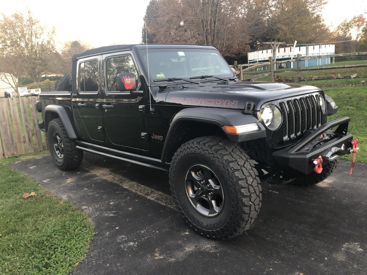

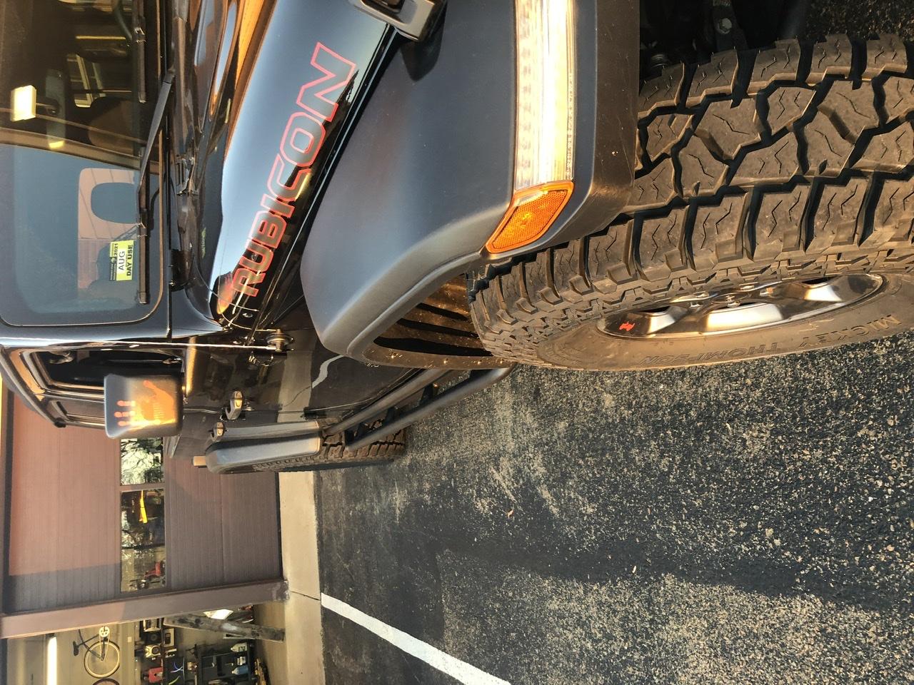

Title says it all 2020 Rubi JTR - #JTRSPARTACUS with 37x12.50r17 Mickey Thompson Baja ATZP3. Thanks to forum sponsor @Discount Tire for getting me these at a fair price ....@TeraFlex Suspensions 1.5” level kit on the front springs, no wheel spacers. Rubs a bit on left turns at full lock. Will address with washers on steering stops . Likely rub offroad. 37’s do sap some power so re gear is in the future. Also planning on a 2.5” @Clayton Off Road lift in the future to save my fender flares off road. More flex, measuring , impressions to come on my YouTube soon https://www.youtube.com/c/JTRSpartacus
