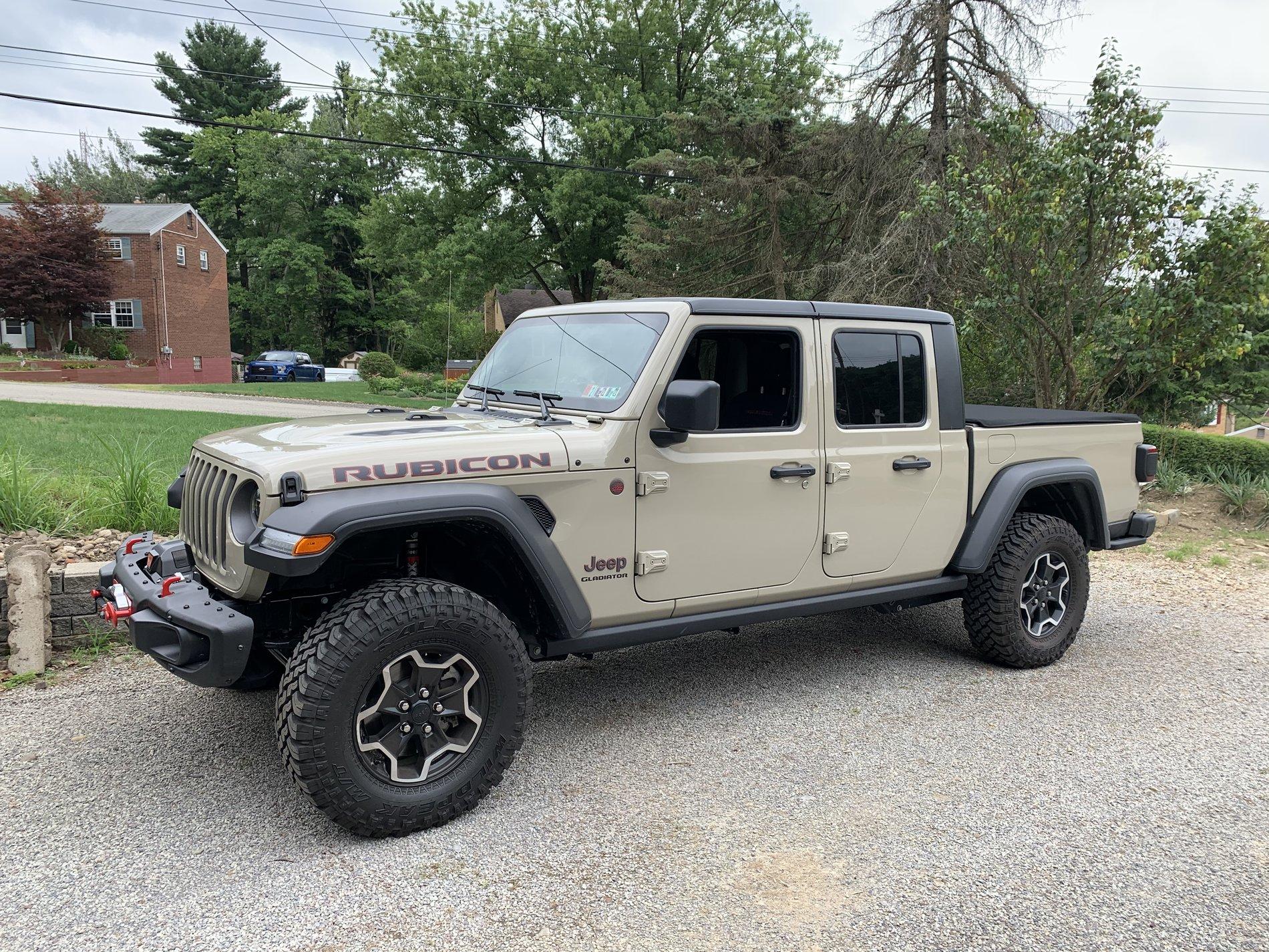

Jeep Gladiator Pics please.. Rubicons with just a front 1.5 spacer lift 59070DEE-9723-44D4-A7EF-F52F51D6A75F
still has a bit of a forward rake but it’s quite a bit better than it originally was. After the winch and winch cradle ~80lbs it did weigh the nose down a bit. The 1.5in kit resolved all of that. I would recommend a trac-bar however. I had a bit of binding in the front end, that centering of the front end helped. Not only that, but the firmer tracbar reduces driver fatigue and wandering. I still have yet to put on the synergy tracbar mount, but this definitely helped.

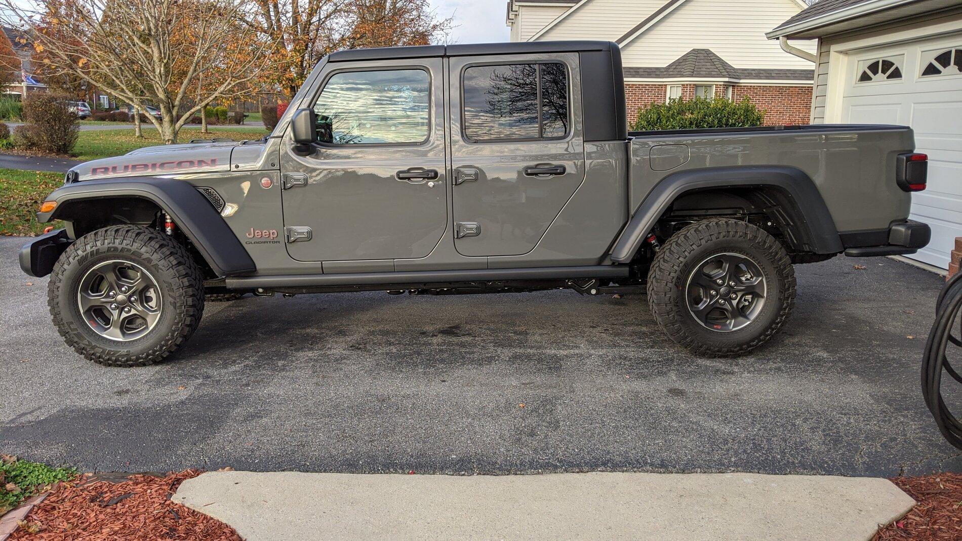

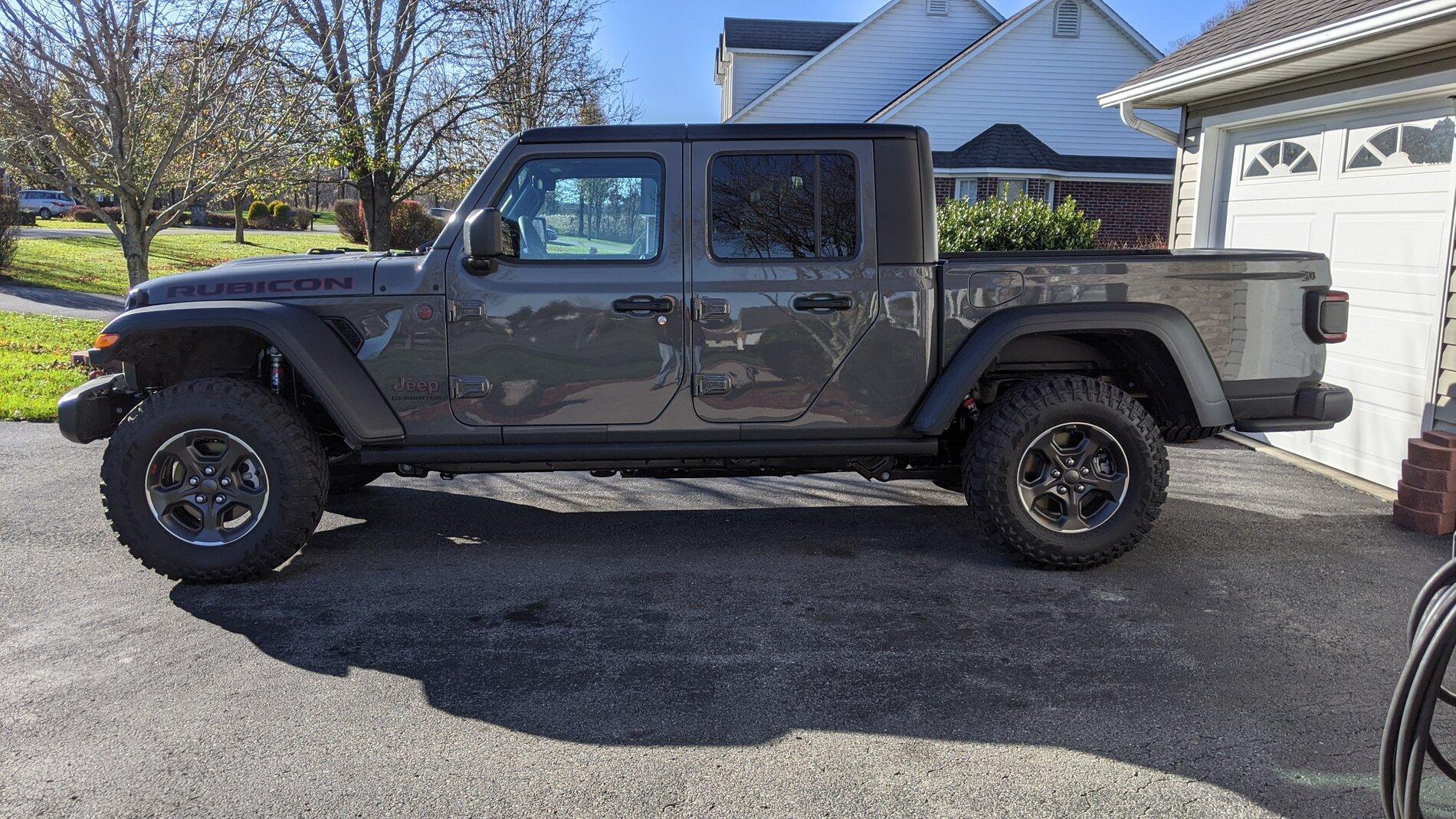

Here's a pic of my JTRD stock then with the Teraflex 1.5" spacers installed, sorry the views are not the same, I'll shoot another tomorrow when it's light in about the same spot as the stock photo. Post updated with before the 1.5" spacers and after the installation in almost the same position and angle.
Jeep Gladiator Pics please.. Rubicons with just a front 1.5 spacer lift PXL_20201114_131342309
Jeep Gladiator Pics please.. Rubicons with just a front 1.5 spacer lift PXL_20201116_194151497

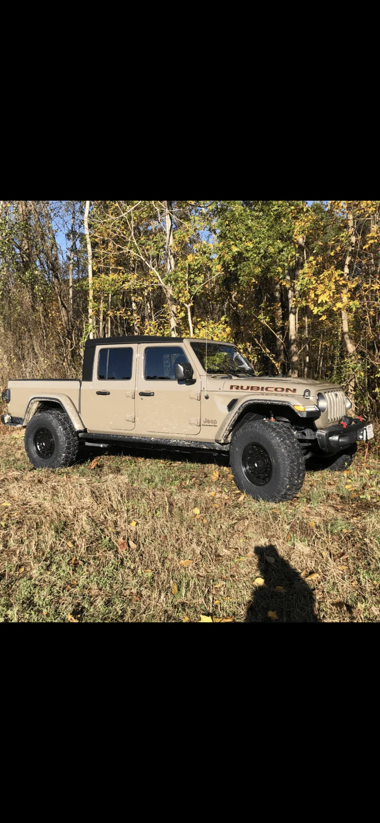

2” rustys off road spacer in the front and 37”s, have the factory steel bumper and rustys winch plate with steel cable smittybuilt winch. Sits level
Jeep Gladiator Pics please.. Rubicons with just a front 1.5 spacer lift 1DA13B12-ABA9-4C37-8860-6E3CFD9C545D
