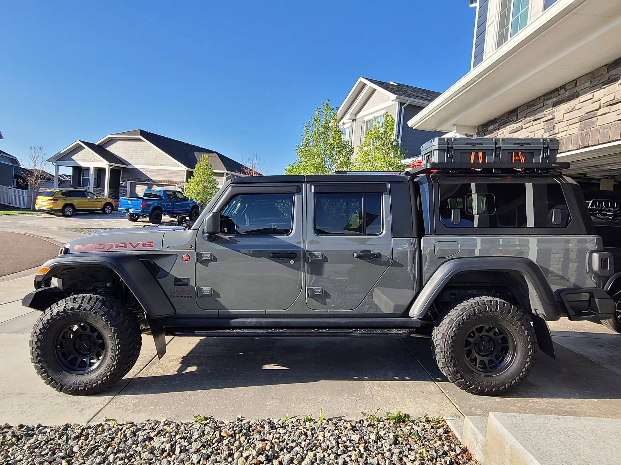

Take your time is my best advise, you dont want to spend a lot on something you regret. Figure out how you are going to use the jeep. Are you going to just hit the trails without a ton of gear in your bed, like a rack or topper, rooftop tent, steel bumpers, add a winch? If you plan to add a lot of weight like that, your common lift kits mentioned here "may" not be able to handle that kind of weight. So that's something keep in mind. I built an Overlander with a lot of weight, as you can see in my avatar, the rear has quite a bit of sag with the stock Mojave Fox suspension. I just got my 3in Dobinson lift with 3way adjustable shocks and HD springs and it lifted me about five inches because of that sag. Clayton and AEV also have HD lift kits. The rabbit hole for 35/37s and a 3in lift I crawled into, also got Metalcloak F/R Control arms, F/R Track bars, Steering stabilizer and plan to get Apex sway bar disconnects. I also plan to go 37s from my current 35 Toyo MTs. So I got Method 703 wheels with -12 offset to avoid wheel rub on full turn, although most probably go with 0 offset which are 2 of the 3 options for the Method 703, +25 is the other. I like the Method 700 series because they are designed run at low psi as are other brands, so keep that in mind when shopping for wheels. Although 35s will fit on your stock OEM wheels and a lot of guys do it, they will perform much better on 8.5 or 9 in wide wheels. Previous owner had the 35s on stock Mojave 7.5 wide wheels and when I switched to the Method 9in wide wheels, the performance was very noticeable specially turning with some speed and the tires looked bigger, wider. Although expensive, I like the Toyo Open Country series of tires and specifically the R/T Trail tires, Toyos are one of the best on the market. Before you buy, dont get too excited and forget to see if its offered cheaper somewhere else and if you can wait, I saved a ton on Black Friday deals, like 30% on my front runner roof rack. Good Luck and Welcome to the club!
