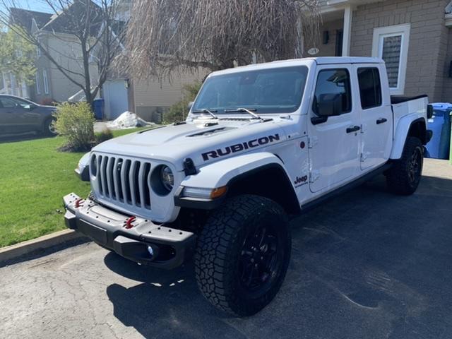

So just picked up my Gladiator LE
I had ordered Method 305 wheels 0 offset with 4.75 backspacing
I will be running Goodyear Duratrac 35 12.5 17
They are telling me it will stick out quite a bit and here in Montreal Quebec they will bug me.
So now considering Black Rhino Arsenal 17x8 30 offset and 5.68 backspacing
if anyone running these set up pics would be appreciated
thx in advance for your help

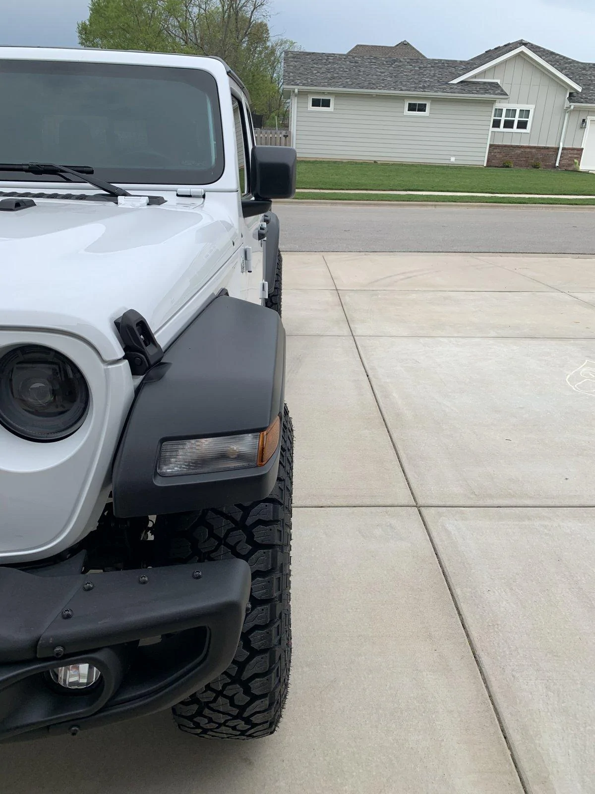

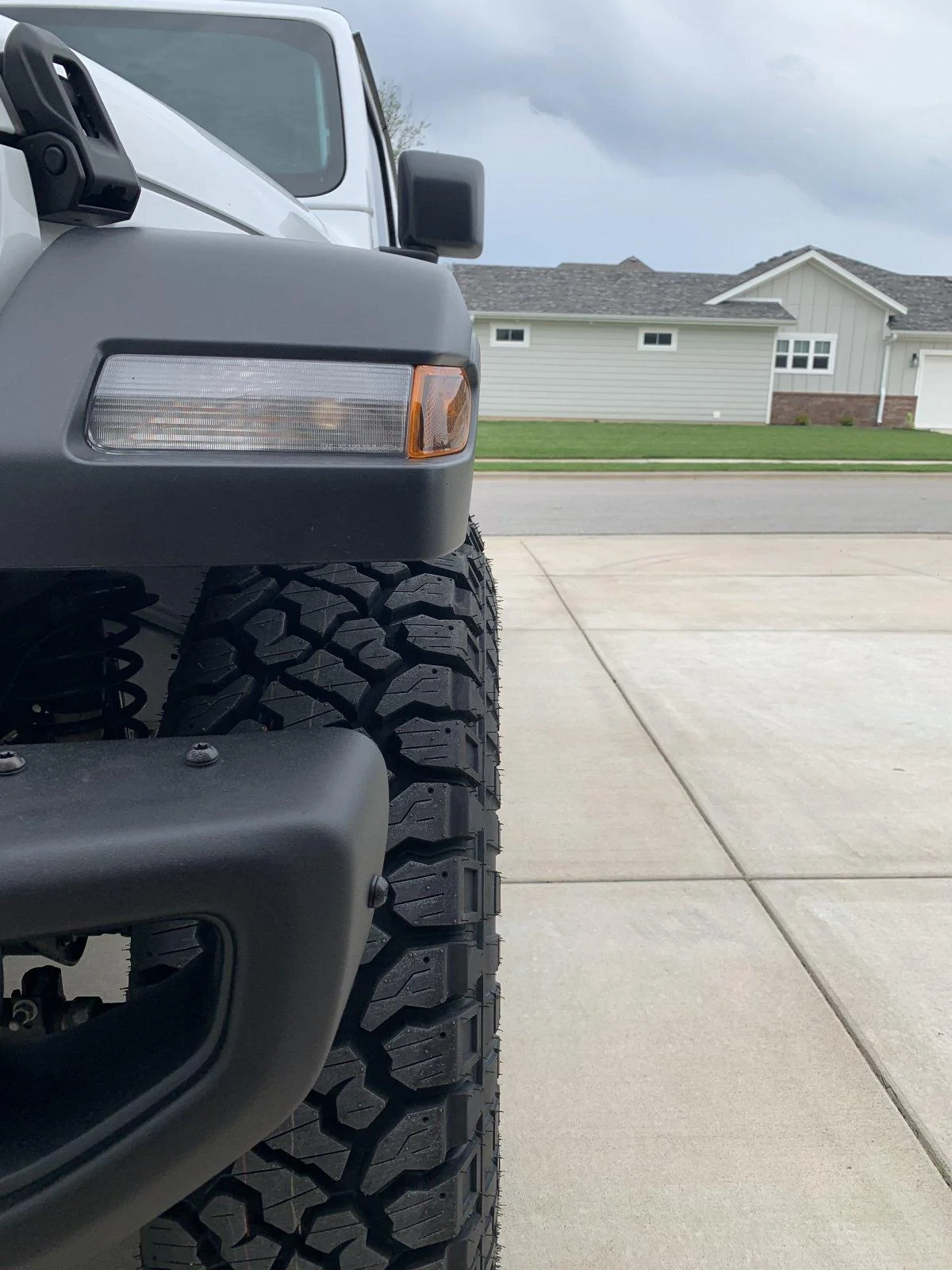

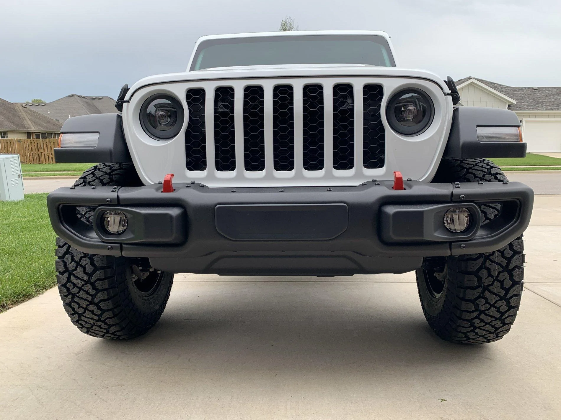

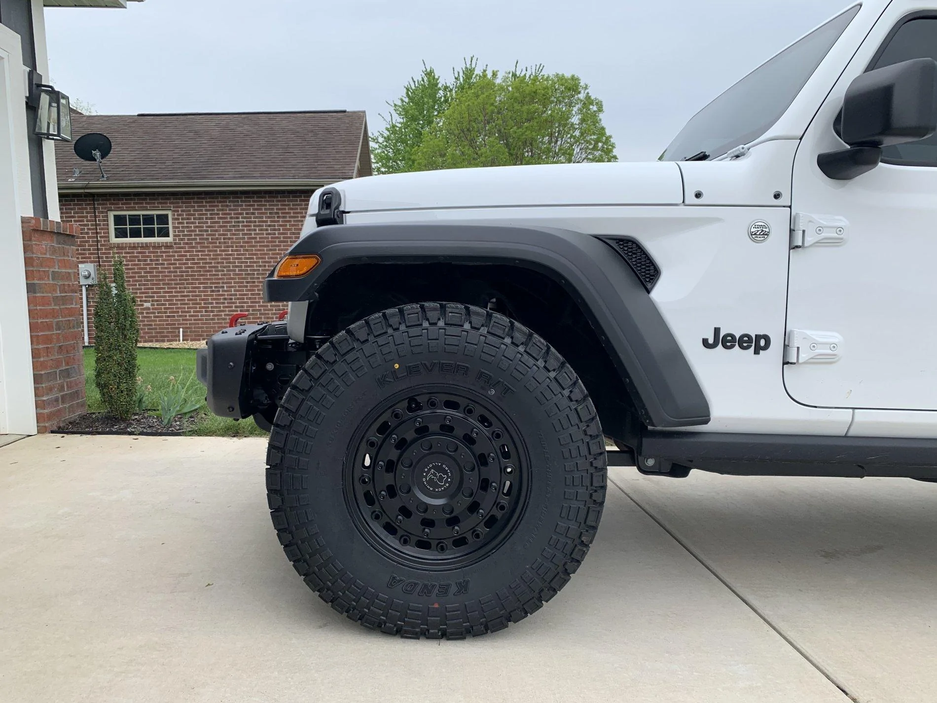

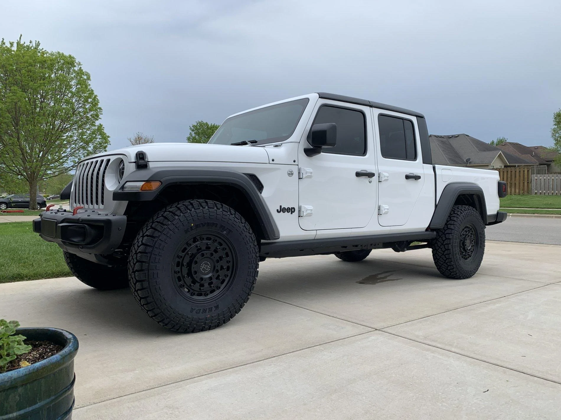

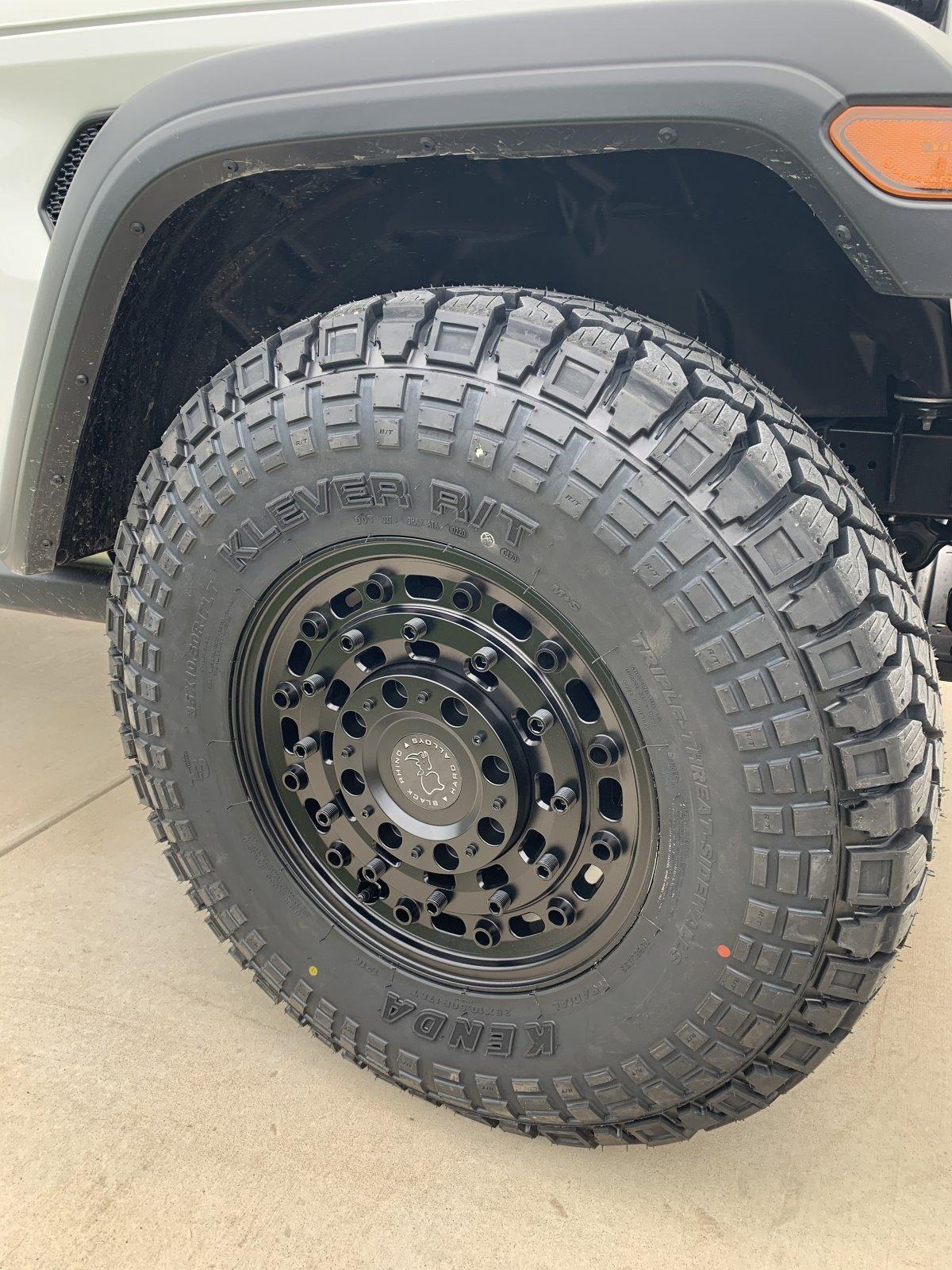

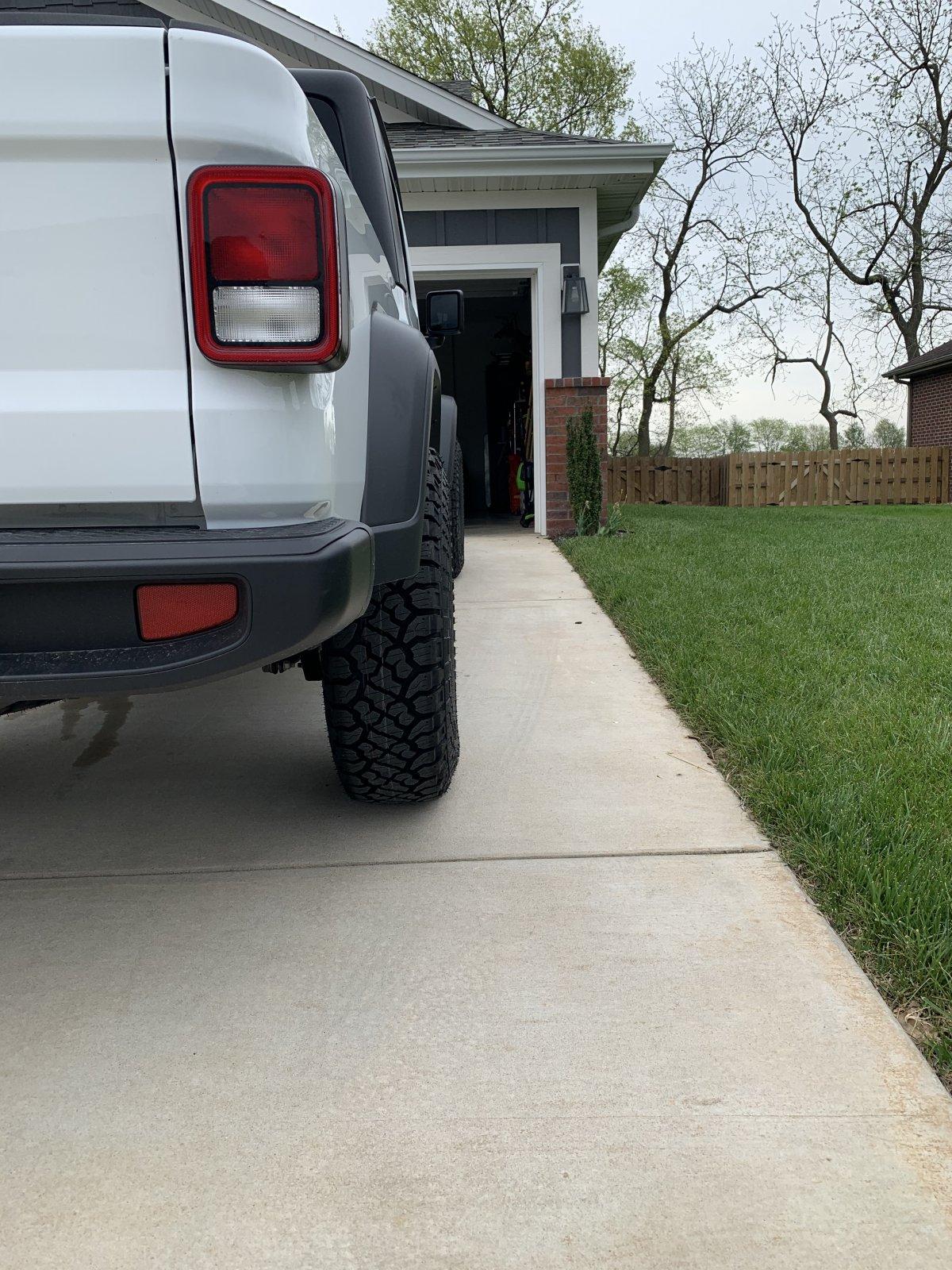

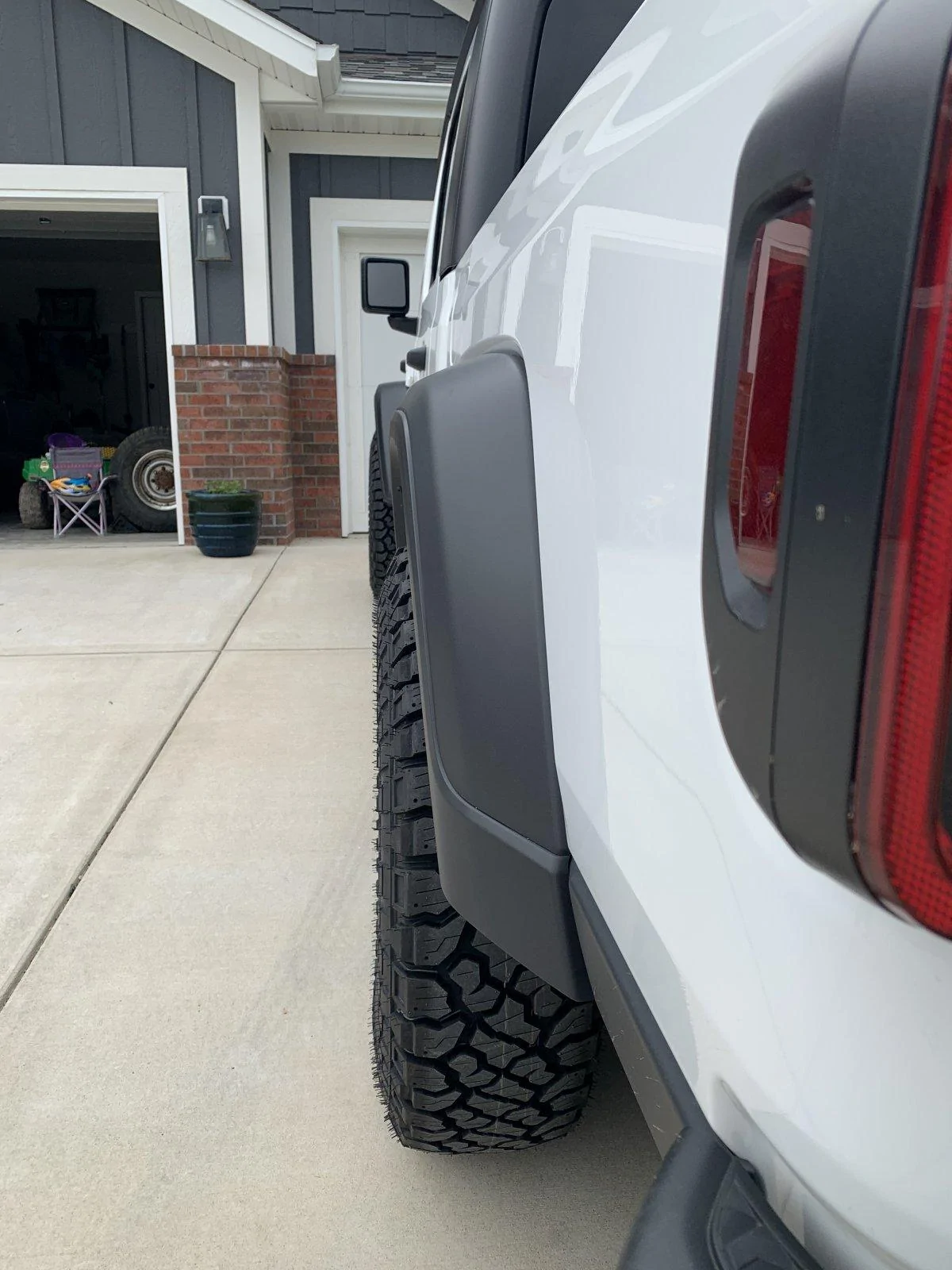

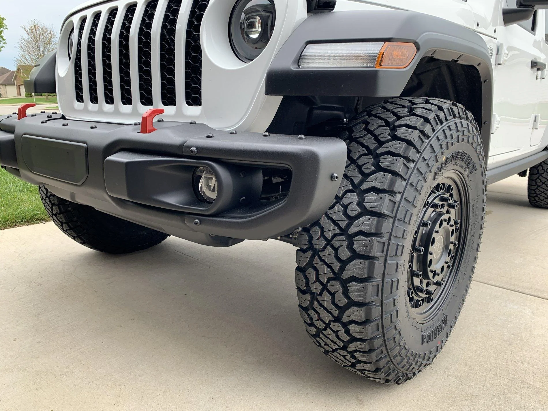

Congrats on the purchase! Great color choice btw! I am running the Arsenals in a +30 but a different tire setup. I went with Kenda Klever 35x10.5 r 17 due to the fact they had great reviews, half the cost of other brands and 10.5 helps the tires not to poke out. I have a sport with the shorter axles and fenders but this should give you an idea of the set up.

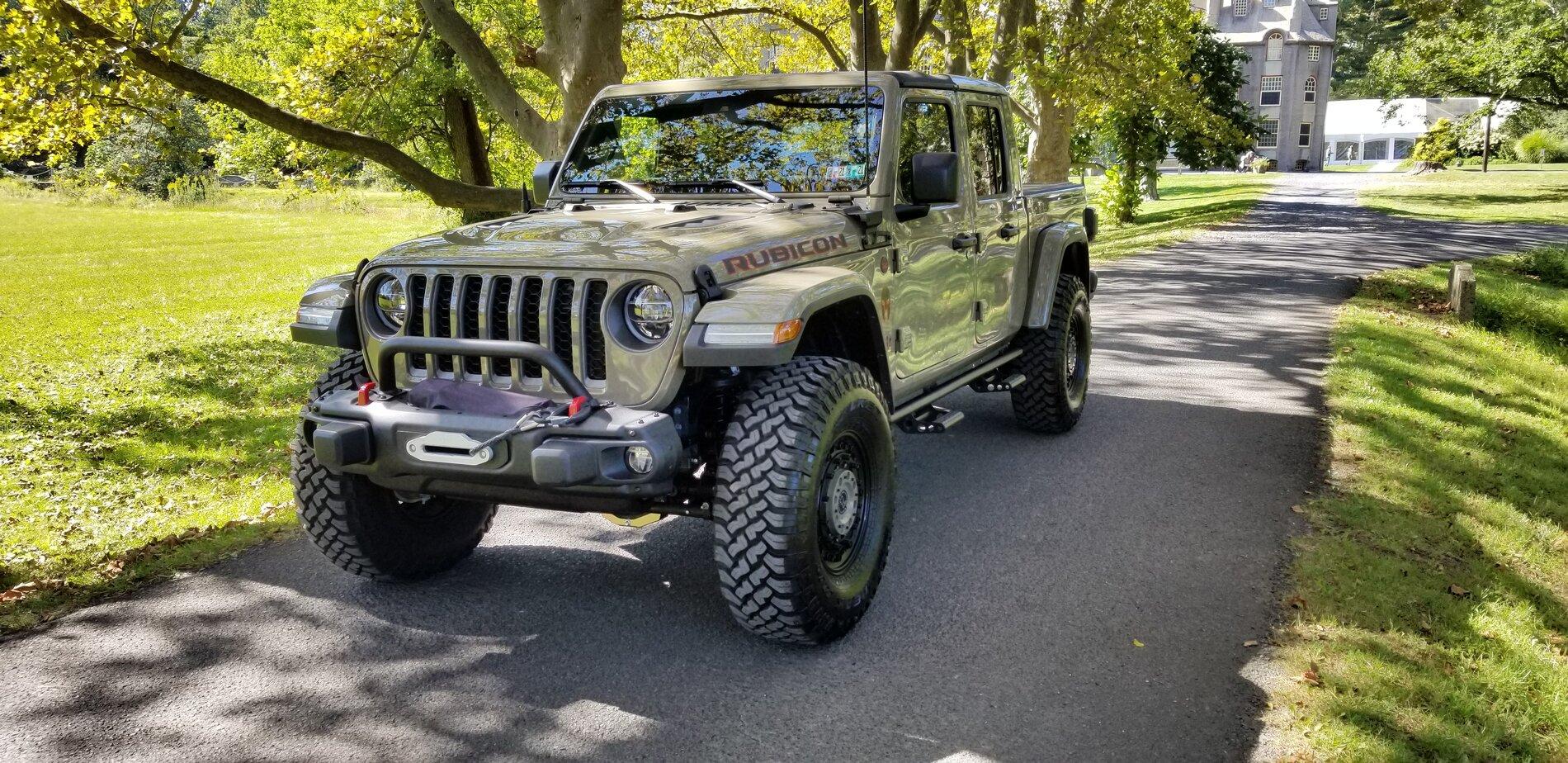

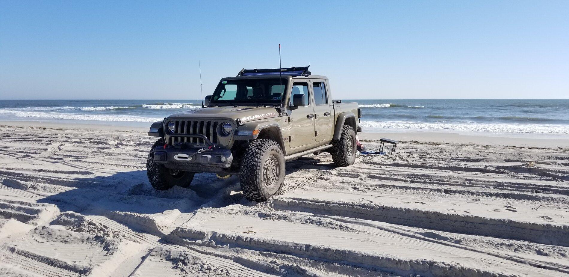

I am running these wheels and bought them for the same reason...tire poke. I am in Pa too...
They are perfect...no rubbing...don’t stick out...will pass inspection.
Running Wildpeak MTs, 37s.

From the pics the Black Rhinos def don't stick out as far as my Methods do. I have the 701 but the specs are almost the same, the 701 being a tad wider.

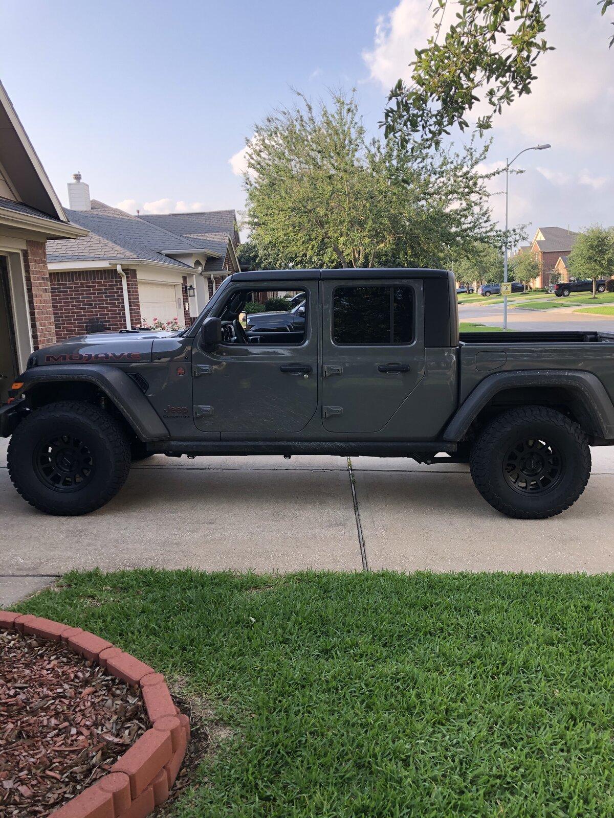

Here are some shots of my Method 703’s with zero offset and 315/70/17 KO2’s. Only had them for a little over a week. Haven’t had them off-road yet, but no rubbing from lock to lock on my Mojave.

Are you happy with these wheels after 1 year of use? Any rust or other issues? I am considering this wheel in 18x8 +30. Thanks in advance for your response.
I am very happy with them. No rust issues and they still look new.
