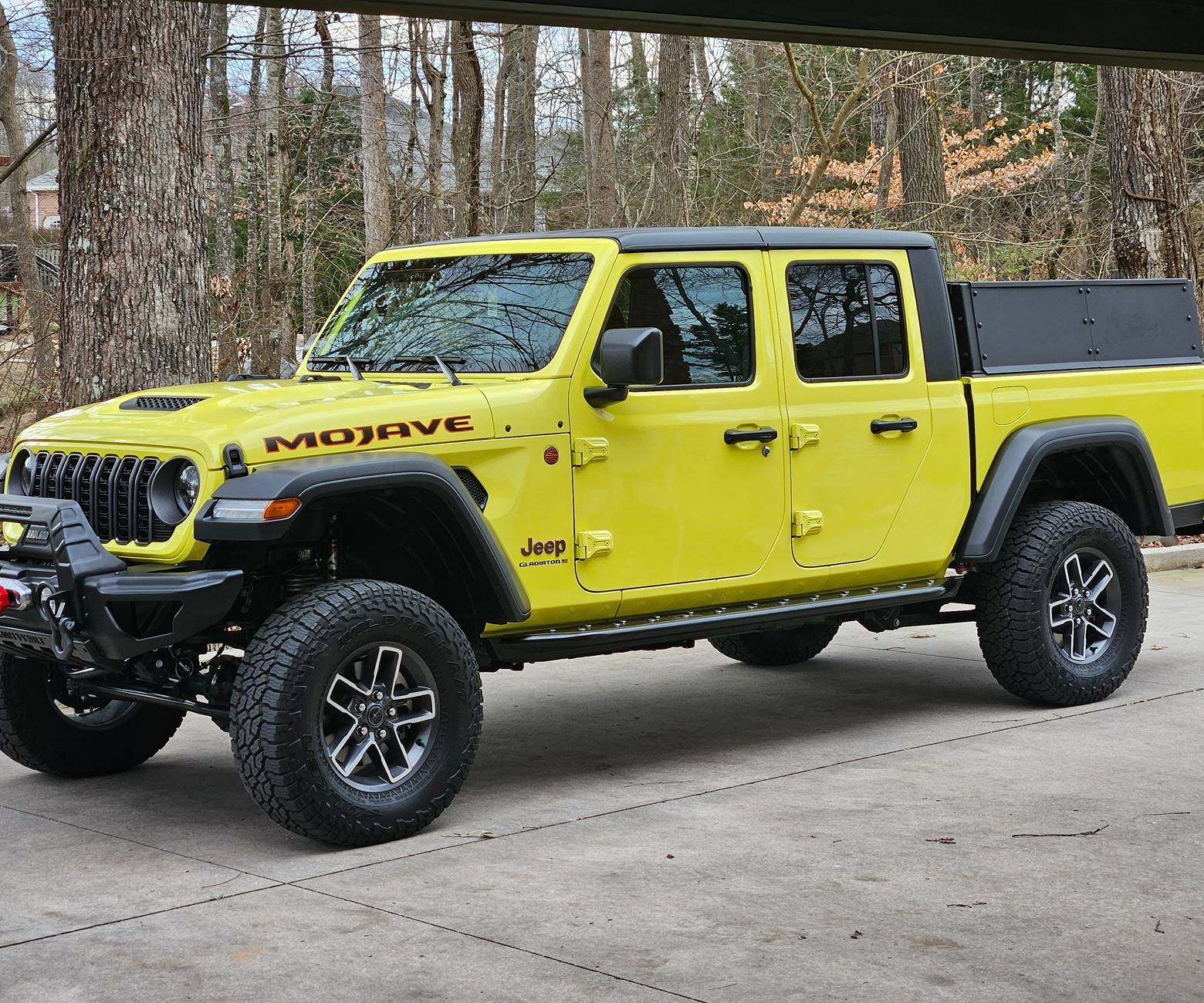

I'm trying to make sure I have everything I need to assemble these beadlock wheels next week when the tires come in.

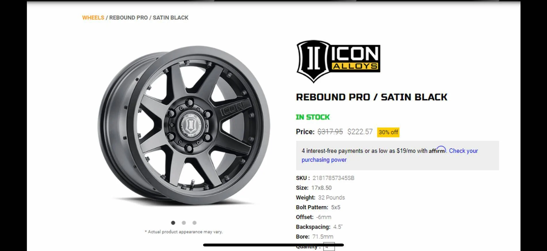

That’s why I went with these. The only thing extra the pins that come up behind the bead. I don’t have to worry about broken bolts maintenance as far as periodically, checking ring bolt tightness or legality or liability issues.

I looked at those Icon wheels, but those don't allow you to mount your own tires. The concept of putting wheels and tires together like Legos is so interesting. I guess if I drove more than 5k miles per year, I probably wouldn't go with beadlocks. I'm probably weird, but I enjoy doing maintenance on my vehicles. It shouldn't be too difficult to check the torque on the bolts every so often.
As far as the legality, half of the things people put on their vehicles say they are for "off-road use only". Ever wondered why? They aren't DOT approved. Most of the LED headlight bulbs that people install in their vehicles...illegal. Most of the aftermarket taillights people install...illegal. A lot of exhausts, intakes, tuners, air suspension, etc. are illegal. Why should I care about this one item? I'm an adult human with at least half a brain. I think I'm capable of not letting a beadlock ring fall off.
