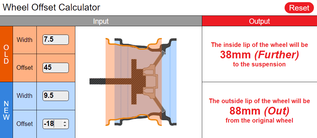

It all depends on what look you are after.
Going to a wheel that is 17x9.5 -18 will push the front lip of the new wheel outward 88 mm which is 3.46 inches .

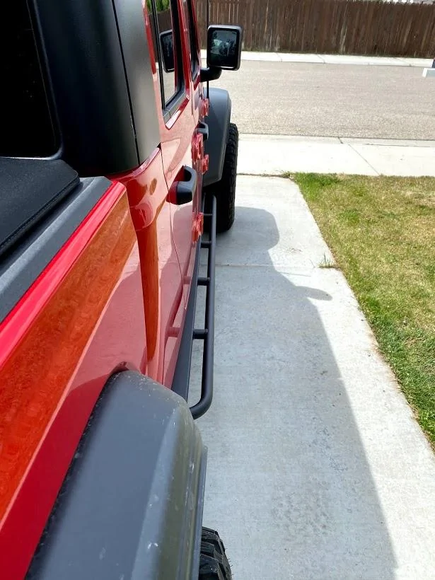

For not too agressive I think that -18 might be a little much. I have a max tow (so same width axles as your Rubicon) and I ordered 0 offset with 317/70r17 ko2's & felt like there was too much poke. To do over again I would have ordered wheels with a bit of positive offset.
This was with the stock fenders. The -18 your looking at is another almost 3/4" out from there.
