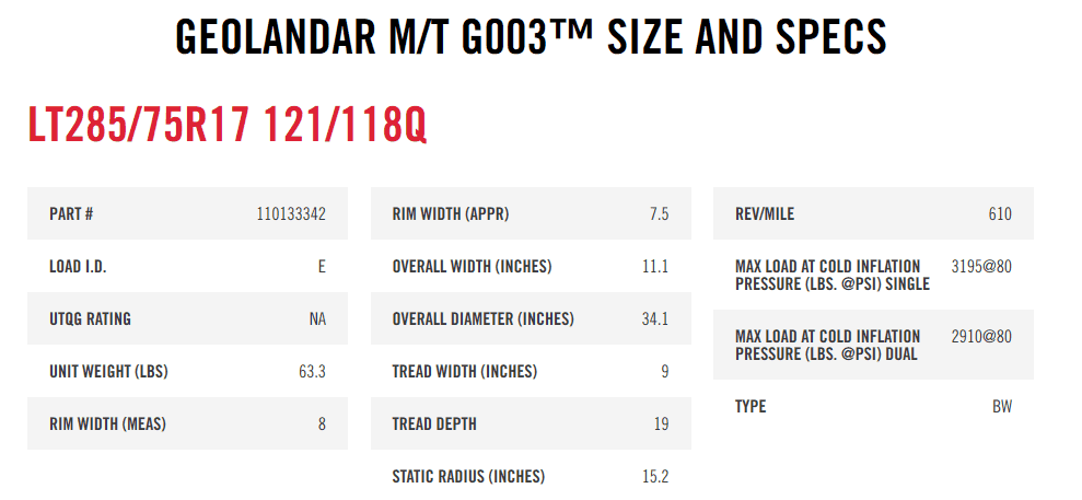

Factory tread being 19, you lost 4/32" in 8k miles? Seems a bit excessive. My Falken M/T01 in 255/75/17 lost 3/32" in about 12k miles.
They barely measured 18 new. I'm not saying they're amazing, but for the money and how well they do on the rocks and in the mud, getting 35k+ miles is good enough for me.

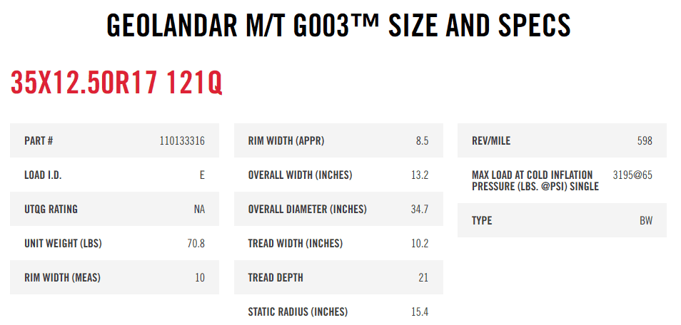

I suggest you look at the Yokohama Geolandar M/T G003. I personally run a 287/75-17 which is a 34x11 vs the 34.5" of a "35". 63 lbs in my size or 70 lbs for the 35x12.5. Mine were like $250 a tire from Simple Tire and after 8k miles I'm still at 15-16 32nd's
