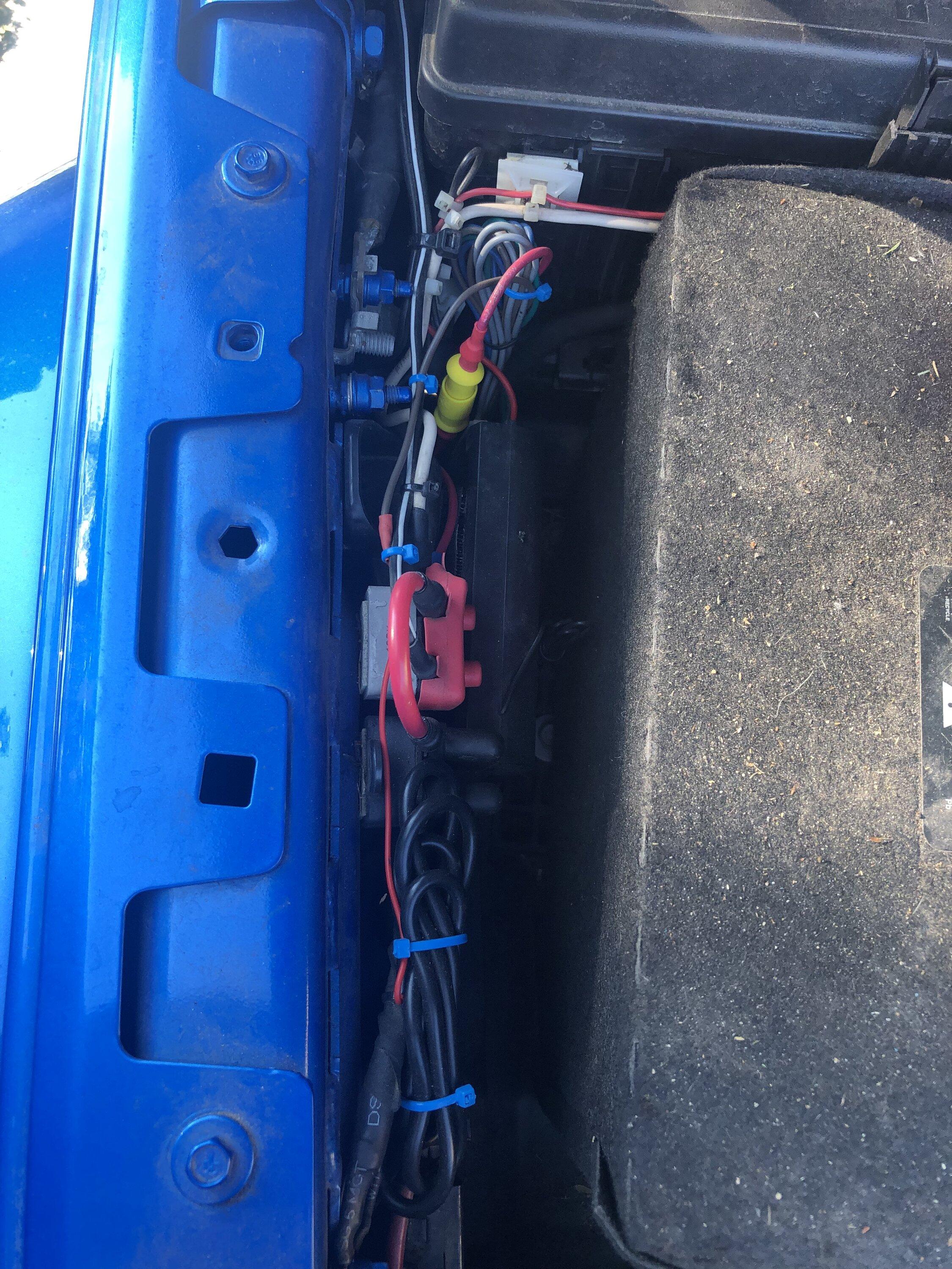

I found there is enough room beside the battery.
Jeep Gladiator Not much room at battery terminals for accessories... 1661961324288
I’ve got like 4 accessories wired in, with fuses or circuit breakers. I affix the breakers with 3M trim tape.
Now, I don’t have any high-current devices connected, either.
But, contrary to what audio guys will say, a 10ga. wire is plenty for 30A. I’ve seen some guys running 4ga. wire for a device with an internal 25A fuse: it’s a waste of money.
