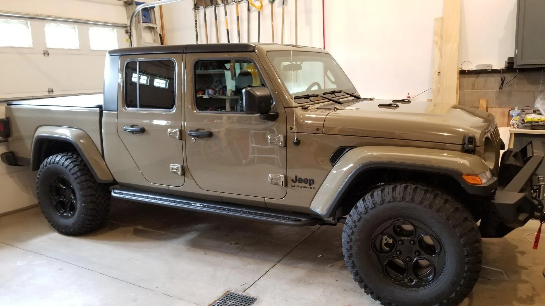

I just want to start this by letting you know this is my first Jeep and also first offroad build. The build is mainly for daily and overlanding. I will be taking it to Moab in November on mostly easy trails and maybe a couple moderate ones.
I knew I wanted 35s and did not want 3" of tire outside the fenders. This is where my lift issues start. I went with the AEV Savegre II wheels and 35" Falken MTs. To give some clearance up front I just installed a Teraflex 1.5 level spacer and no rubbing at all on road. Now that I am looking at the clearance to the fender 4", it just does not seem to leave enough space for flex so I am now looking for a 2.5" lift with adjustable control arms and track bar. I would love to go with a 3.5" lift but the wife is already struggling to get in and out.
The issue is that the AEV wheels have a 5.7" BS and from what I have found on most lifts, they want 4.5" or less.
So my question is, what is the actual part that rubs or inteferes and causes the issue with the BS? MC 2.5" appears to have an issue with the lower shock mount being offset, other lifts have indicated sway bar link rubbing or LCAs. I have a sport s so I am thinking the sway bar issue should not matter since I would be disconnecting and strapping them up. I can't figure out how AEV can offer a 2" spacer lift engineered for their wheels and not have any rubbing issues.
Just need some options because I really like the wheels and the fact that they are tucked in. Open to a mixed bag of parts if I have to. For instance would the MC 2.5 lift work without using the offset shock brackets, will the Clayton lift rub the LCAs, and then just substitute those parts with something that will work. If not rubbing now, would the mopar lift work even though I would prefer adjustable arms?I am going out of my mind looking through lift threads hoping to find something about lifts with AEV wheels but have not found anything. Here's to saving my fenders.
