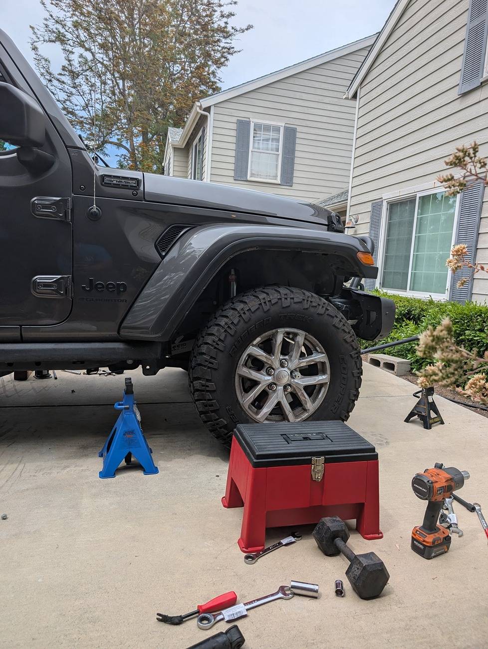

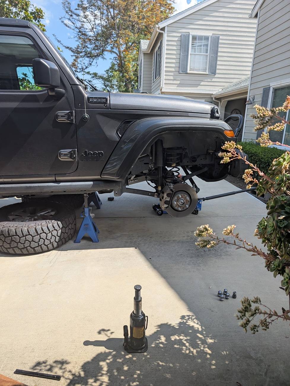

Welp, front is installed! After a fun 8 hours! Why it took so long I dunno, first time taking a jeep apart so I was "cautious".
Bought 6 ton jack stands and set them to 21" high. Unbolted the track bar and all the wires/hoses. Loosened control arms. Axle dropped right down and OEM springs came right out.
Rancho Springs are 21-22" long so getting those in took some muscle. Not to hard. Decided to not use the 1/2" Teraflex spacer. Good thing I didn't as I'd be nose high.
Started at 36" to front fender ridge (down 1/2" from winch/bumper). Ended at 38.5". So just about 2" over the stock 36.5" before I added winch and bumper.
Added Mopar extended control arms. Still need to put adjustable track bar on. Axle Only shifted 1/4-1/2" so save that for another day.
Eibach shocks ride really nice!
