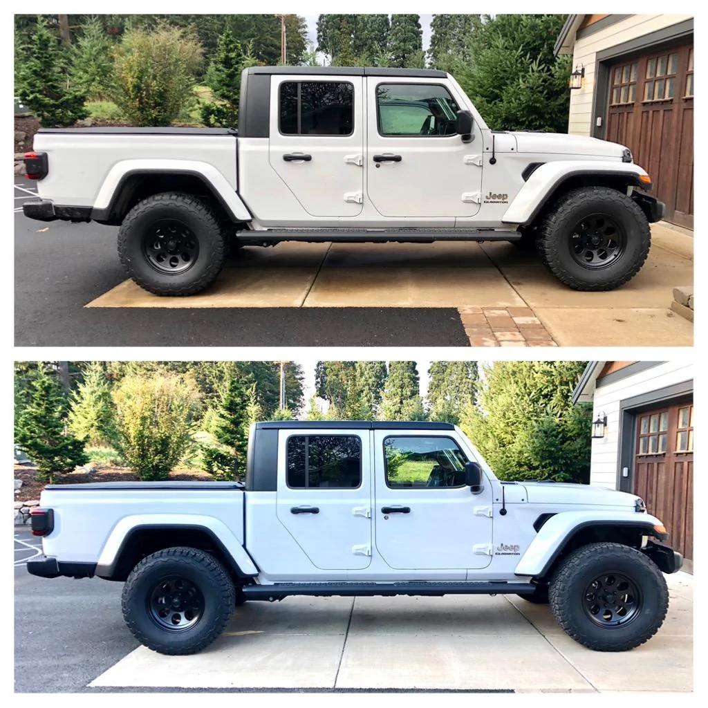

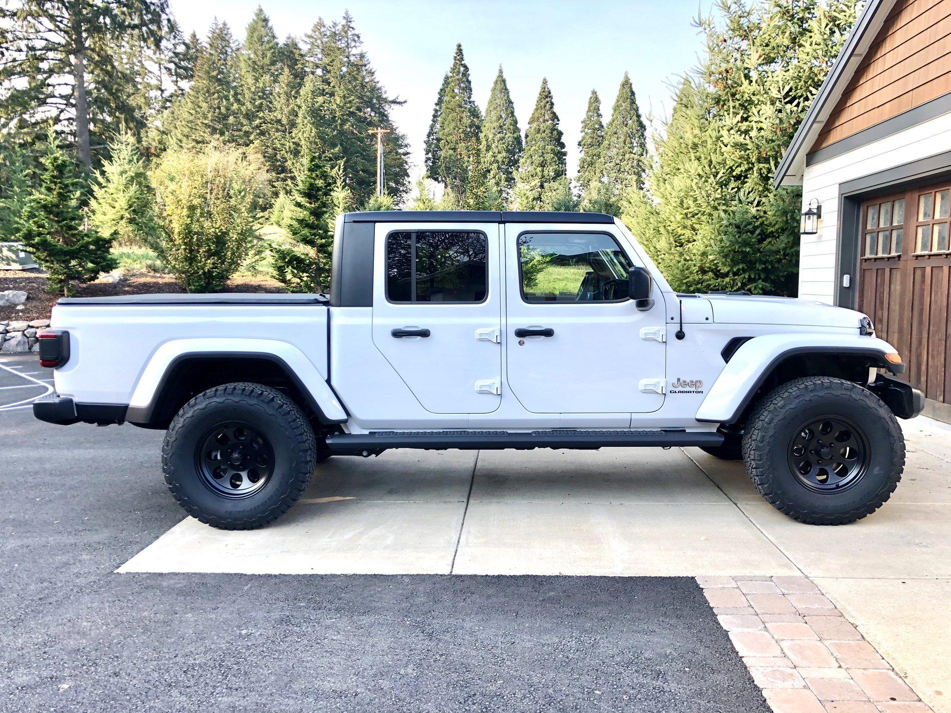

I’ve got an Overland on stock suspension right now while running 315/70r17’s (34.4 inches tall). No rubbing whatsoever on stock suspension. I’m installing a 2” leveling kit (spacer) this week just for looks as I don’t like the rake. I think you’d be fine with the spacer kit. Here is a picture of mine before the spacer kit:

Ok, nice. Wasnt sure if I needed to buy new springs or something. May go-ahead with the leveling kit. Thanks.

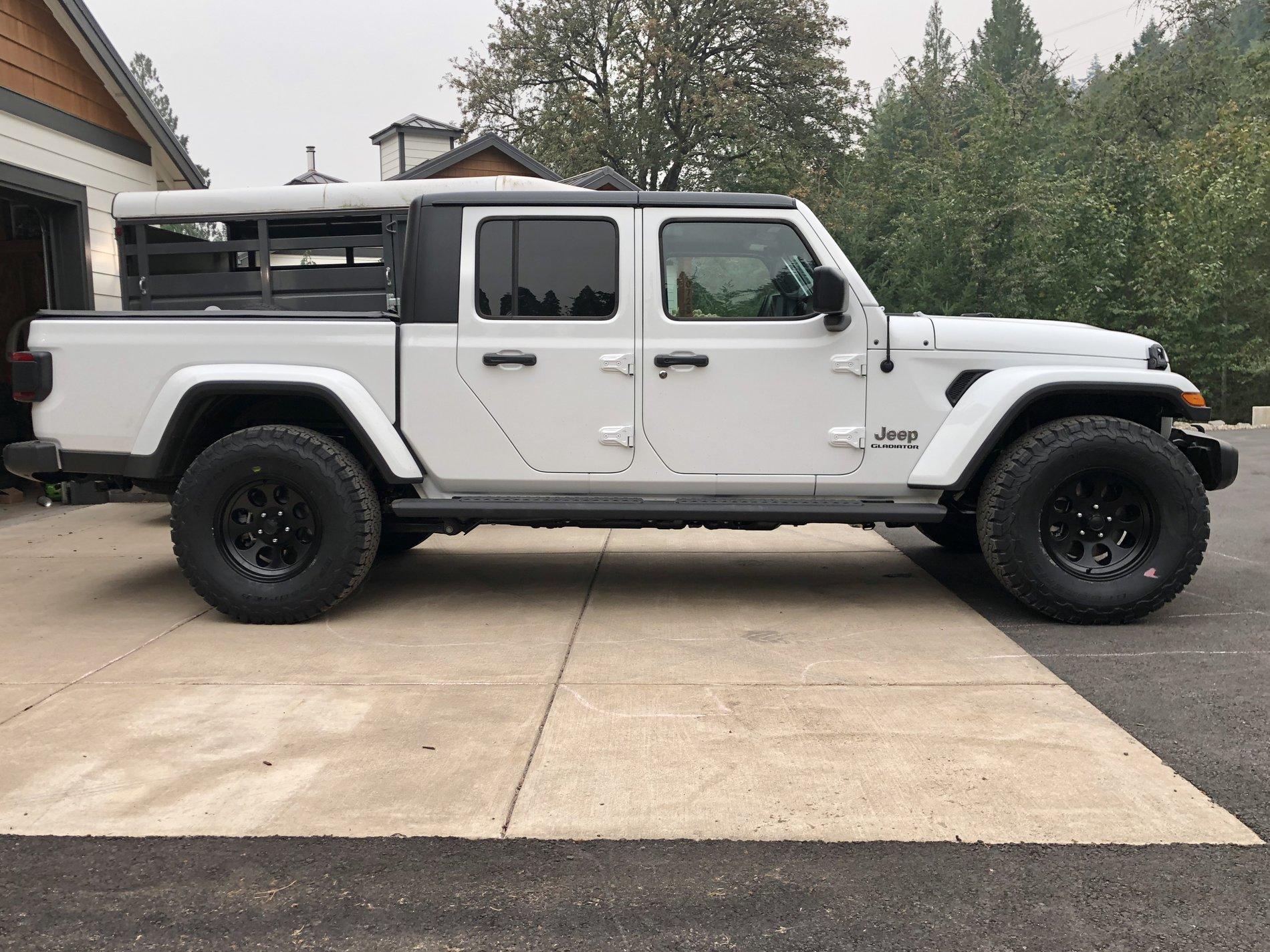

What size and brand spacer kit did you go with?
watarski
Craig
Dec 13, 2019
71
Panama City Beach, FL
It’s a 2” Tuff County kit with shock relocation brackets in addition to the coil spacer. No difference in ride after install.
Thank you for the feedback. That's crazy! It looks great - where the 1.5" spacer that most folks get looks like it raises it too much. Congrats.

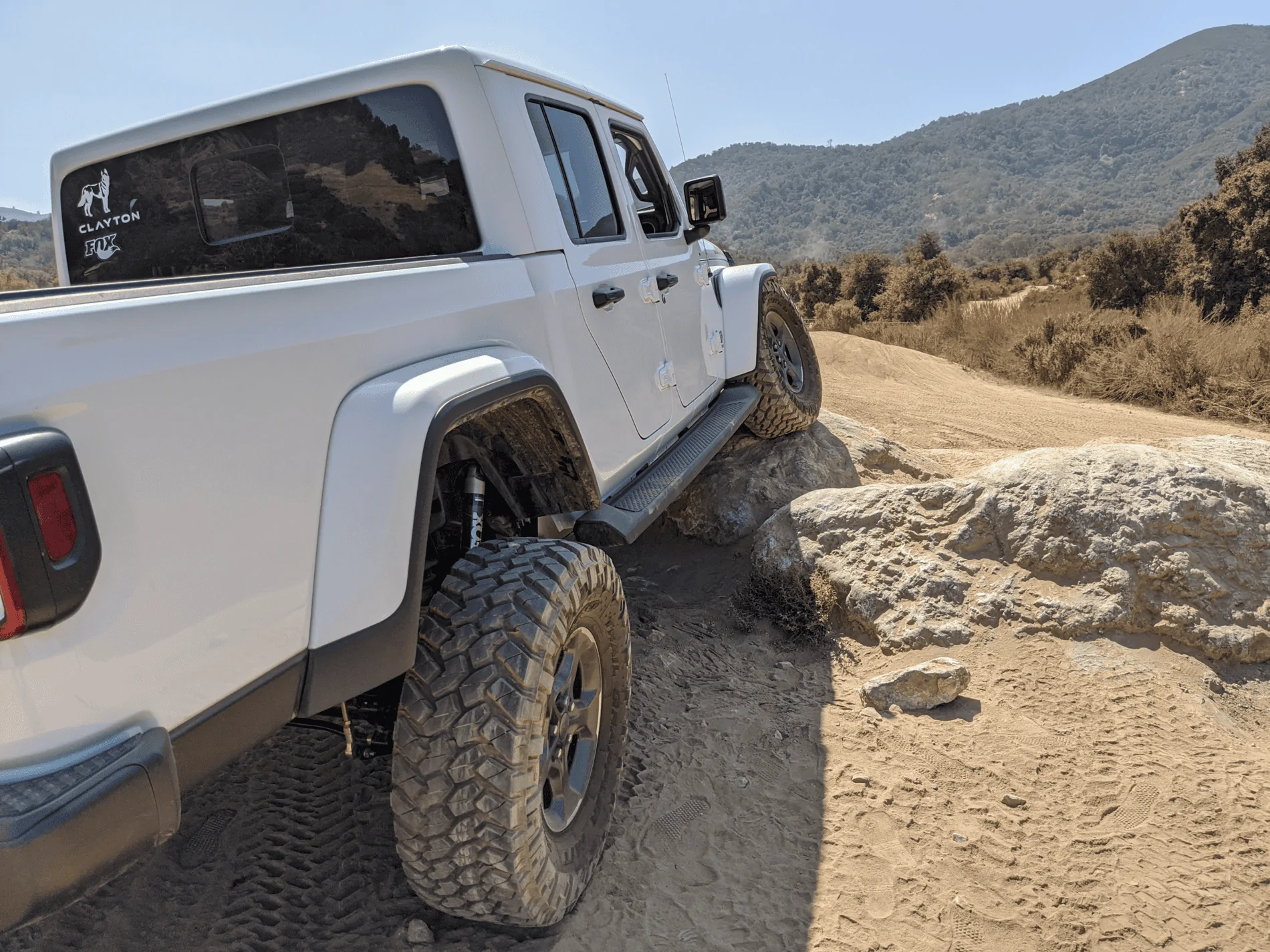

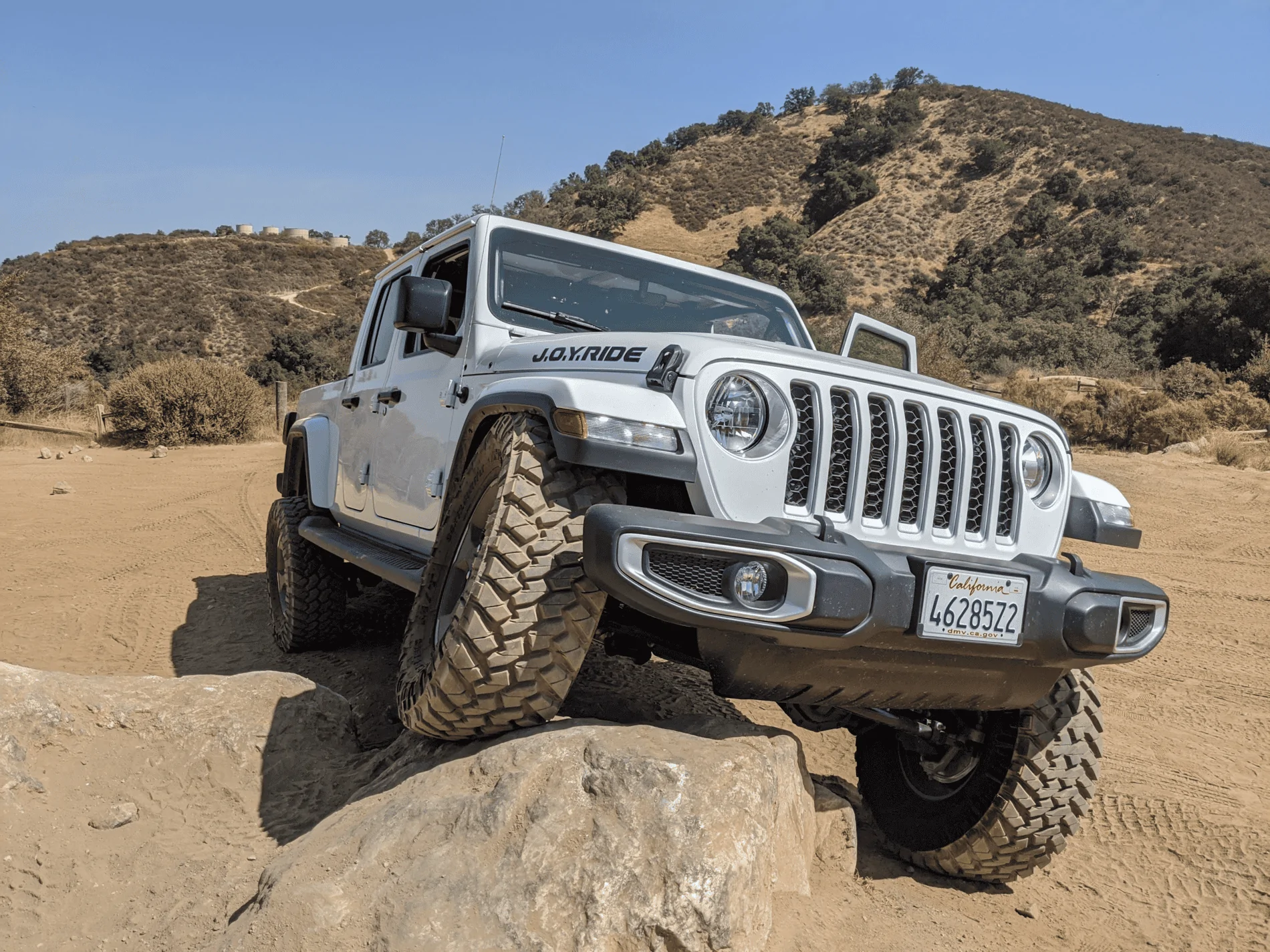

Overland. 17s. 35s. Clayton 2.5" lift which will net you 3.5-4" on the Overland. Need more fender clearance.
