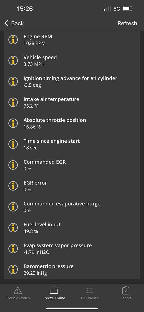

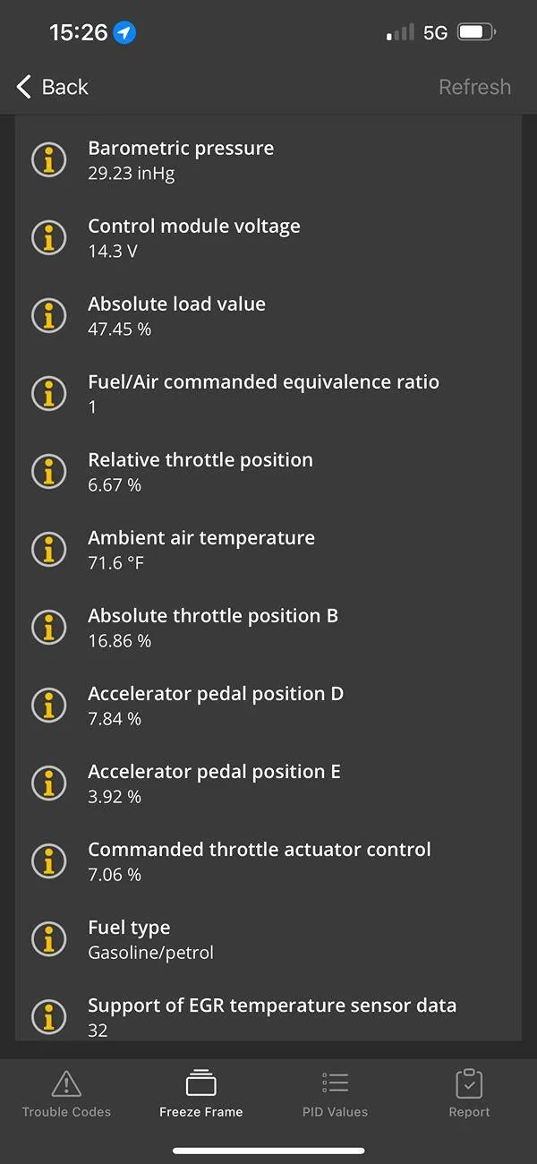

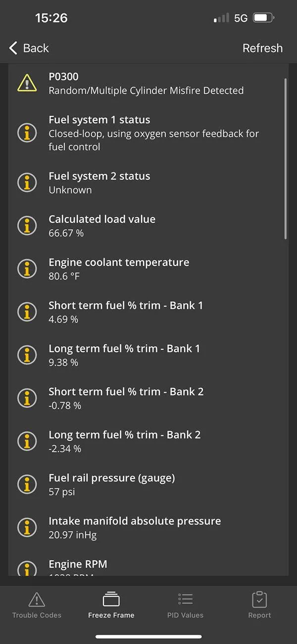

Hey all.
I’m having an issue
When idling at lower rpm’s the check engine light starts blinking. Diagnosis code is p0300 and I’ll attach my freeze frames.
I changed all 6 coils and spark plugs and nothing has changed. Exact same problem exact same code. Idle is also rough.
Any ideas where to look now?
2021 glad with ~90k miles. Actual mileage is in the freeze frame
Jeep Gladiator P0300 code with freeze frames IMG_3016
Jeep Gladiator P0300 code with freeze frames IMG_3022
Jeep Gladiator P0300 code with freeze frames IMG_3020
Jeep Gladiator P0300 code with freeze frames IMG_3018

IMO, there shouldn't be that much difference in fuel trims between the two banks. I'd check the o2 sensor signal graphs to see if there's a bad or lazy sensor, and check for oil leaks getting into the o2 sensor wire connectors (valve cover leak seems to be a common source). If no issues with the o2 sensors are found, perform a compression or leakdown test of all six cylinders.

Would like to see the PIDS for each cylinder misfire count. If concentrated on the right 1-3-5 bank, may be looking into valvetrain issues that are more prevalent on that side.

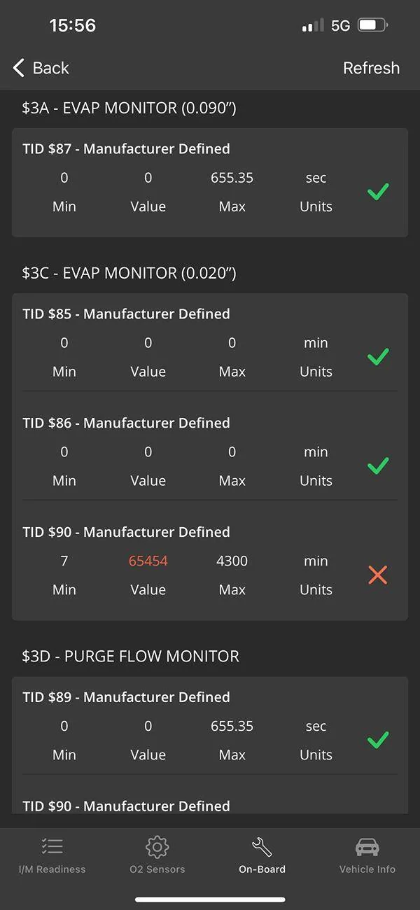

Thanks for the replies. I’ll update the thread with the requested info soon.
Edit: not sure if this matters, but I did see where the evap failed a TID.
