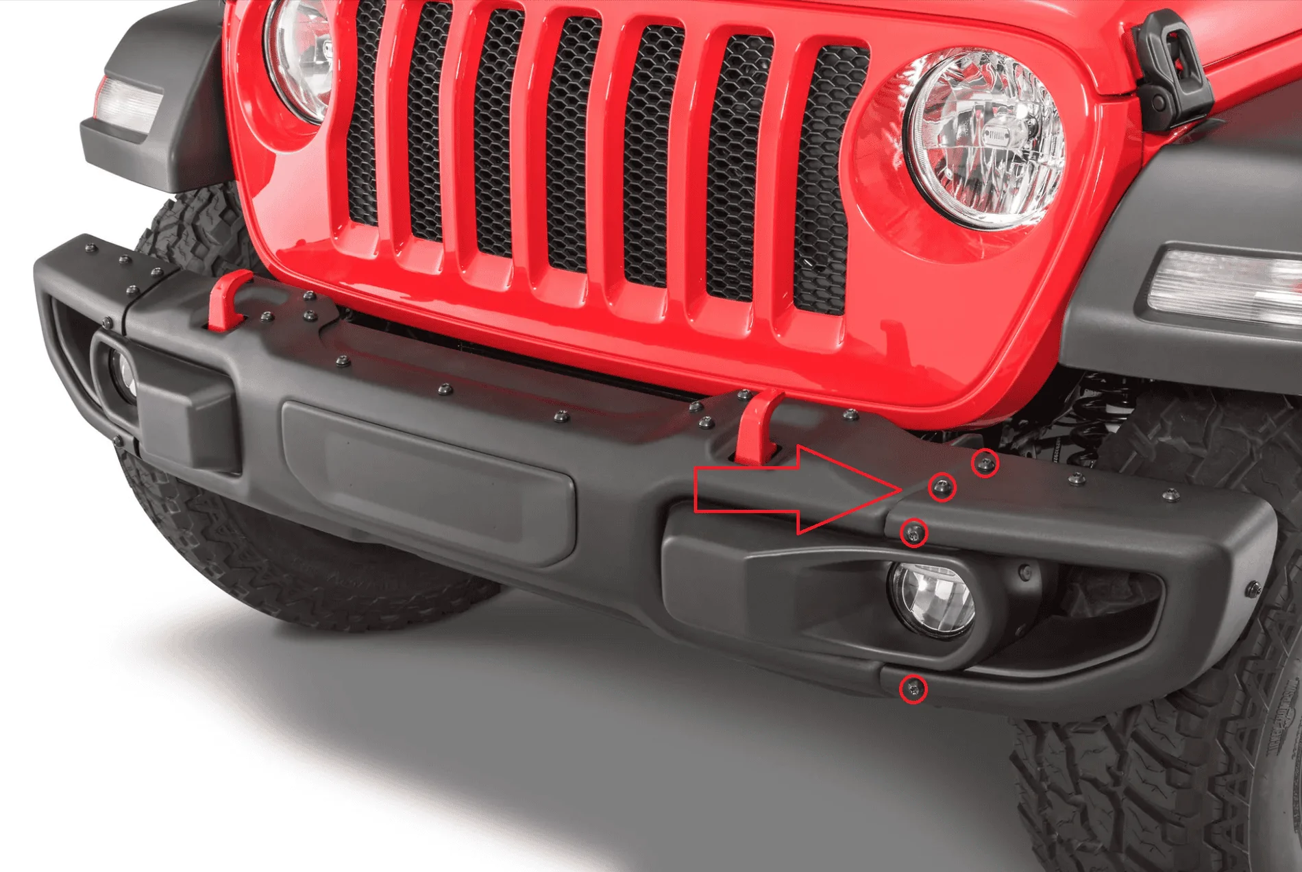

Can someone confirm what the part number for the bolts that attach the extenders on the steel bumper? I bought a shorty steel bumper (no extenders) to replace my plastic bumper but it didn't come with bolts. Looking online I found PN 68231973AA however I received them yesterday and they are not the correct size. Any help would be appreciated!
68355472AA
The bumper is an outer "skin" attached to a chassis. Several of the empty holes in mine were poorly aligned. I loosened every screw in the entire affair, started all of the screws then tightened.
T45 torx driver
