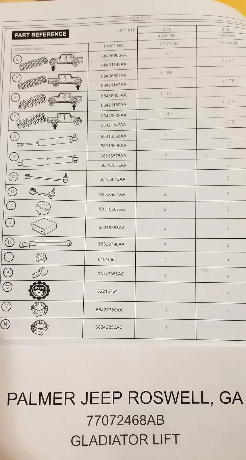

2.0. The 2.5’s are remote reservoir.
The shocks in the MOPAR kit are 2.5" (I have them). Not remote reservoir, but they are 2.5. Factory Rubi shocks are 2.0 and, as others have said, not the same as the 2.0 Fox shocks you get directly from Fox.
