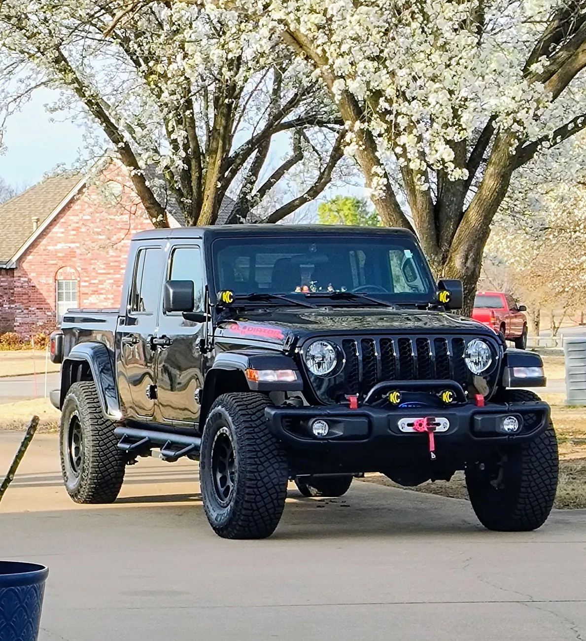

I got her done as per my plan. Everything worked well other than getting the control arms torqued to specs, lol. I went with Fox 2.0's as it's almost exclusively street driven. Im very happy with the mopar front springs/ Icon rear spacers. The stock Max Tow springs balance well with the Mopar fronts.
Jeep Gladiator Piecing together a good 2 inch lift. 1000015307
Jeep Gladiator Piecing together a good 2 inch lift. 1000015308
