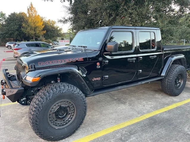

drew0622
Drew
Dec 1, 2020
244
359
Houston, Texas
2022 Mojave
Inventory Coordinator/Document Management
black rhino armory wheels thanks!
