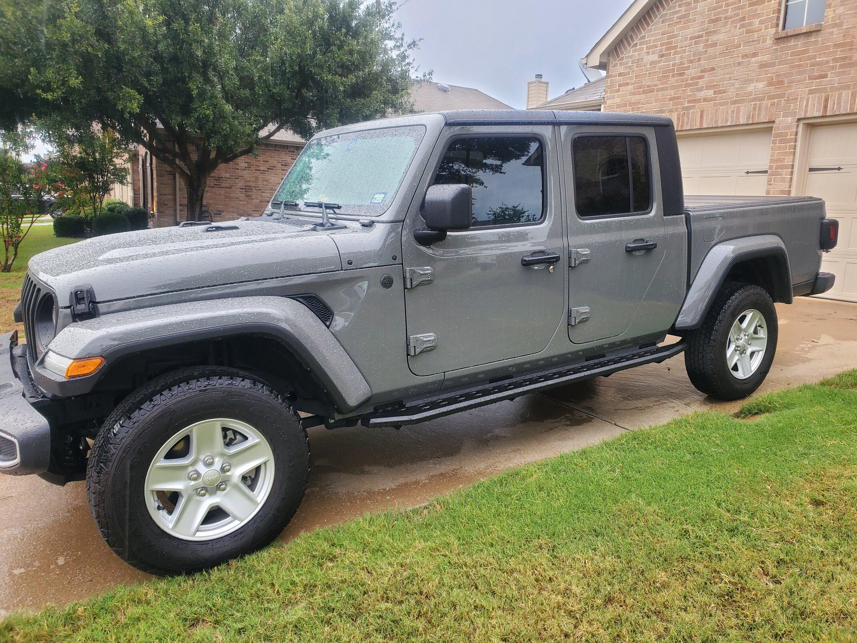

Mopar 2 inch lift and 3/4 inch front spacer

This is not a Mopar lift. Notice the rear upper and lower control arms. They are tubular and adjustable. Same for the front lower control arm. The Mopar lift does not come with any rear control arms.
He could have added adjustable control arms after installing the Mopar lift
It is a mopar lift and I added metalcloak control arms.
