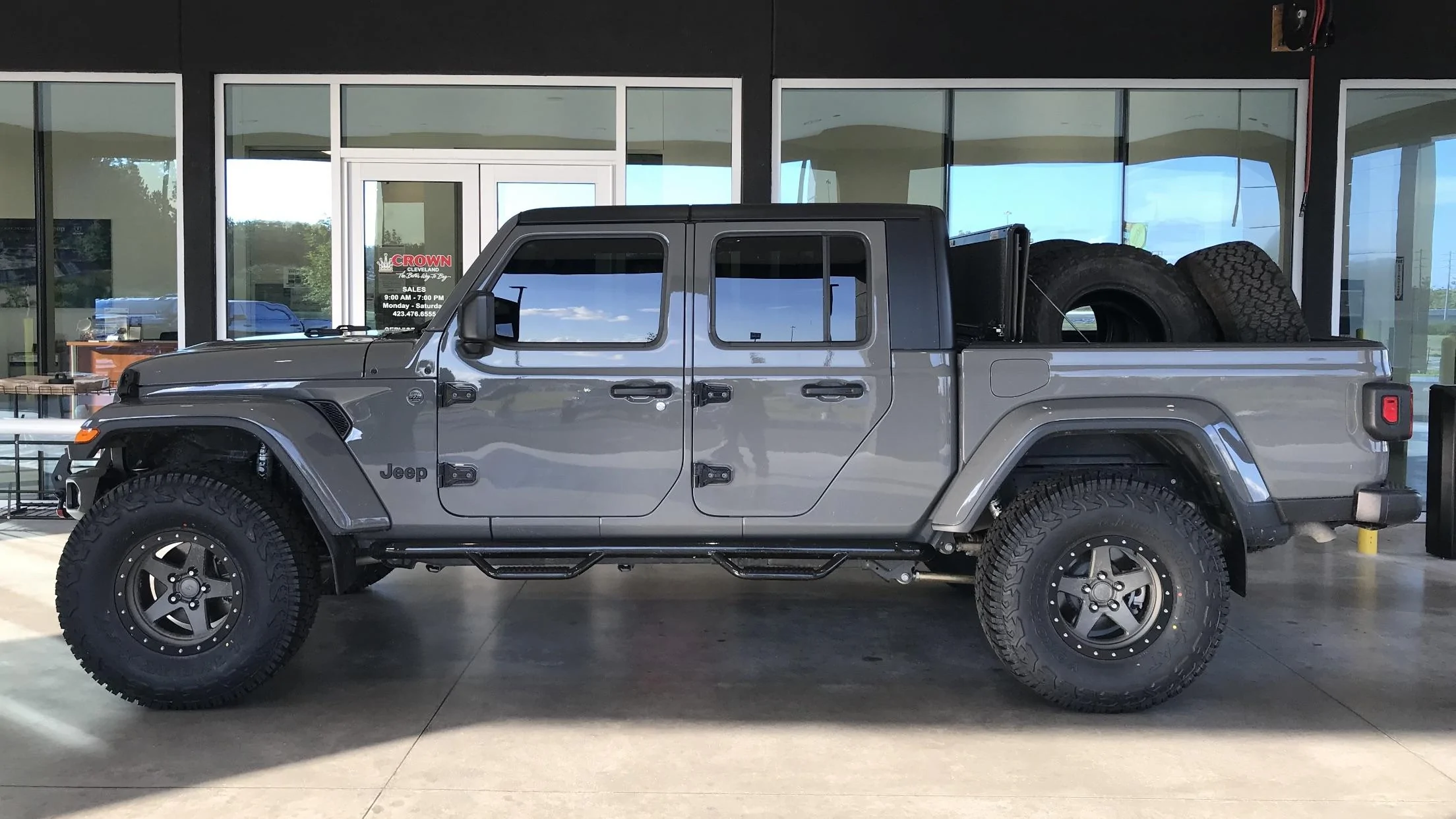

I just had a Mopar 2" lift installed with 37's and now looking to add a leveling spacer to accommodate the weight of the metal bumper and 12k winch, after getting it home I do see the need for adjustable track bars also and starting to look and see what will work best for my JTRD.
This is my first Jeep and build so it's a learning experience.

Looking to get the Mopar lift myself soon. Although I'm already running the Teraflex 1.5 inch level up front.
Done a bit of research for when I make the move myself. And I've heard you'll definitely want an adjustable front track bar. Especially after the front level. If you were just running the lift by itself, I've heard mixed reviews on whether the track bar is necessary. But with any additional height with the lift, I'd say so. I plan to do the exact same when I get mine installed. I'll probably just run the 1 inch spacer from my teraflex kit and drop the .5 inch puck. That way it'll compensate for the slight rake it would have without it. And also compensate for my winch eventually. I'm already running the Mopar 3 piece steel bumper and skid (running the stubby option).
I would probably get an alignment afterwards too.
Side note: nice side steps...I have the same except the non slim version. ?
On the steps: They are the Go Rhino RB20. I'm OCD when it comes to having badges all over my Jeep. I drilled the Go Rhino rivets out holding on the name plate. It left no scratches in the powder coating and looks nice. The only badges I left on the whole Jeep is the ecodiesel badge and the trail rated badge, and I considered removing those.

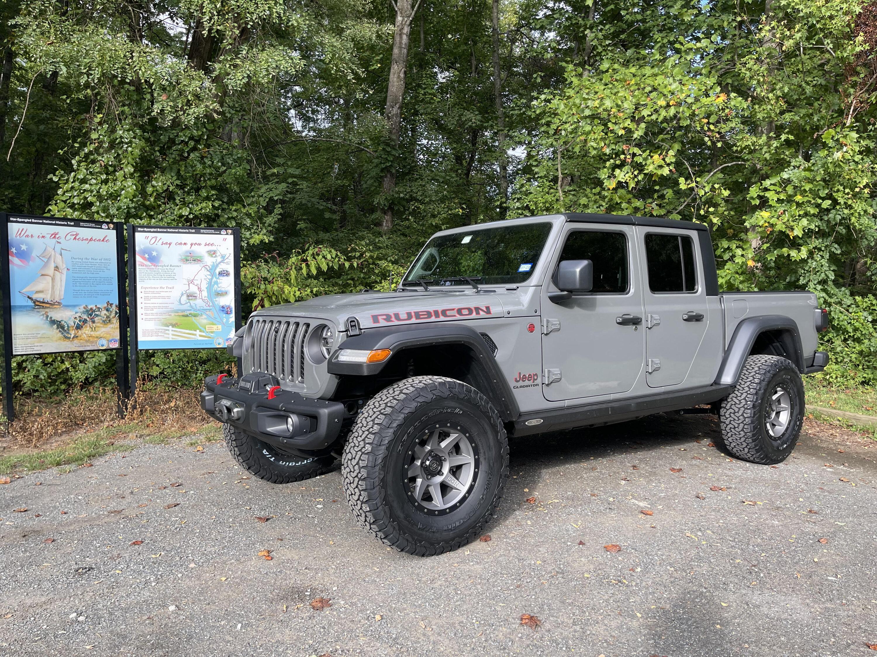

Here’s my diesel rubicon with the Mopar lift and the 1.5 inch TerraFlex leveling kit on 37s.
I have since added a stubby bumper and a 12,000lb winch.
Are you getting any rub when wheeling and what offset on wheel (if any)?

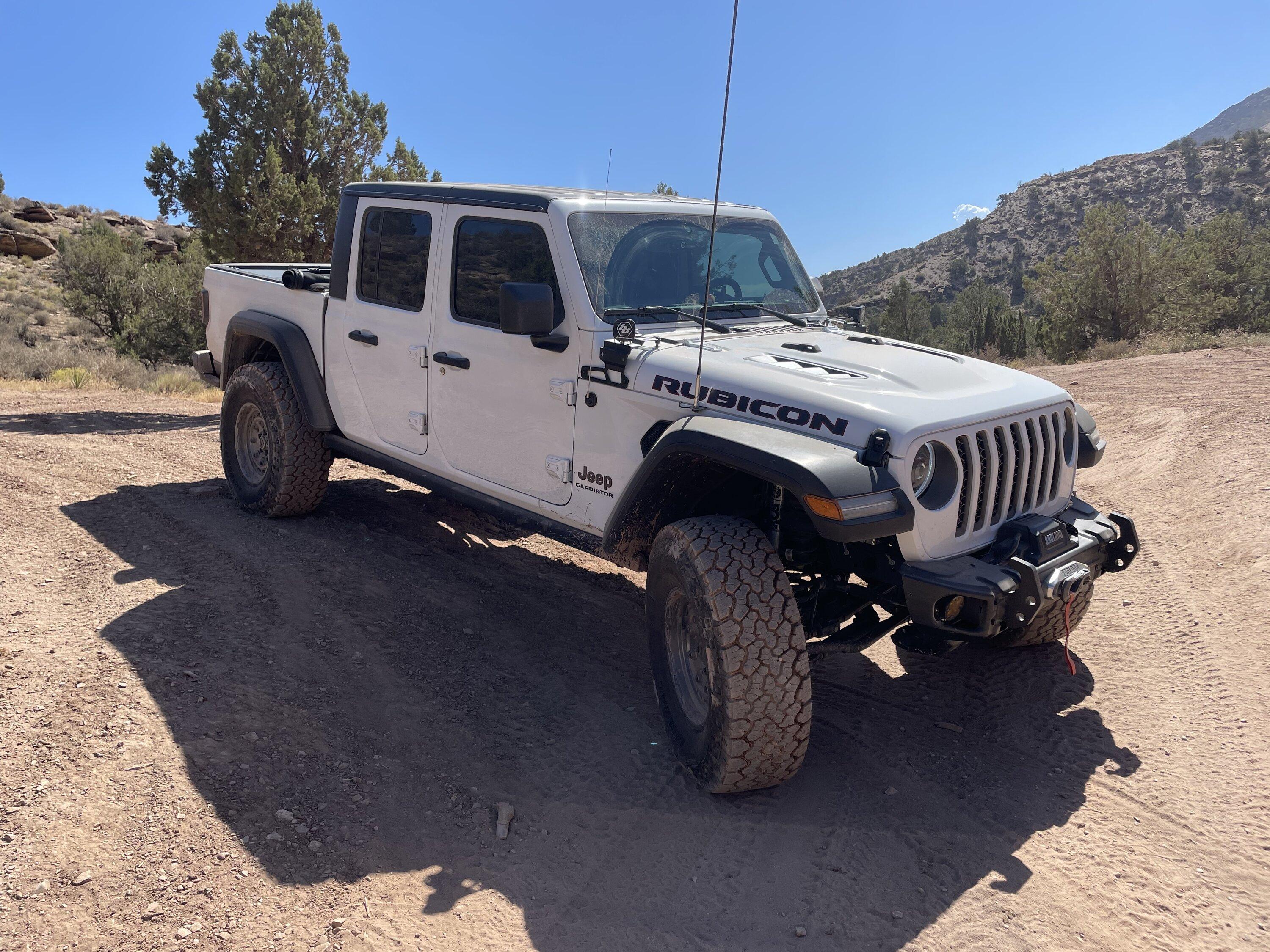

Mine is a gas burner but this is the mopar lift with spacer in the front and 37s.
This is not a Mopar lift. Notice the rear upper and lower control arms. They are tubular and adjustable. Same for the front lower control arm. The Mopar lift does not come with any rear control arms.
