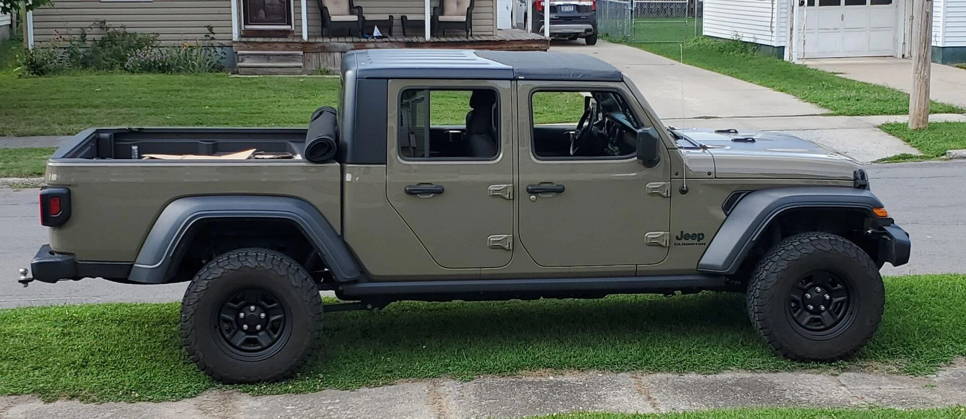

I went with the aev 2" spacer lift. fits great ,rides great and have no issues with 5000 miles on since installing. Have not used snap cal that came with it yet.

Thank you! Looks great. Did you just go with the supplied parts or did you add anything? Also are those 35s?

Thanks, just used everything that came in the kit.no those are 33s but i want 35s now lol

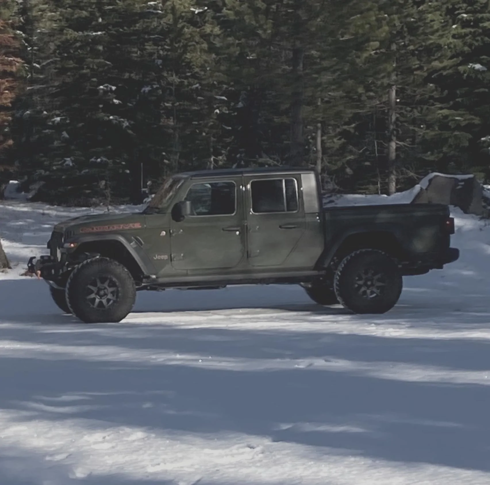

This is the AEV on a Mojave w/35" tires. a Sport would not get quite as much height. I would highly reccommend the AEV kit seemed high quality and installed easily, I added front and rear track bar and front lower adjustable control arms, not sure any of that would be necessary although I like to be able to re-center after lifting.

A sport would get exactly the same height out of the kit.
A spacer kit is always going to give you the advertised height, regardless of model, unlike spring lifts whose actual height can vary from advertised.
Your Mojave would have more tire clearance than a sport because of the high line fender flares, but the amount of actual lift would be the same.

OK thanks. Sorry, I guess i was thinking that since the Mojave had taller springs and we were both to add 2" of spacer mine would still be taller.

Your correct in that your Mojave will be 1" taller in the end, as it comes with a 1" lift in the front (standard on Mojave). That being said, the amount of lift added by the spacer will always be the same.
