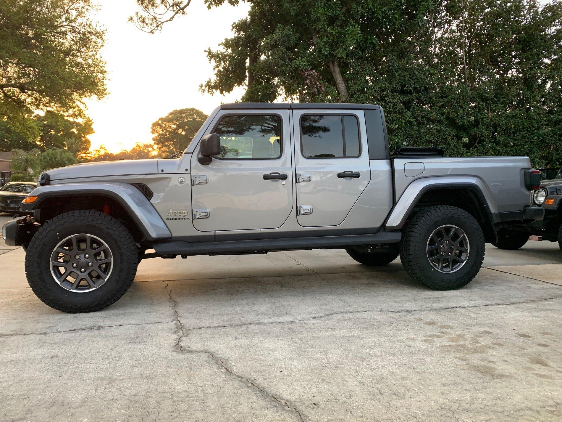

Did you replace any bolts or nuts at the same time? Just want to make sure I have all the hardware handy.
Nope. Everything else was reused. I bought both the front end links and lower control arms from the Mopar 2” kit.
