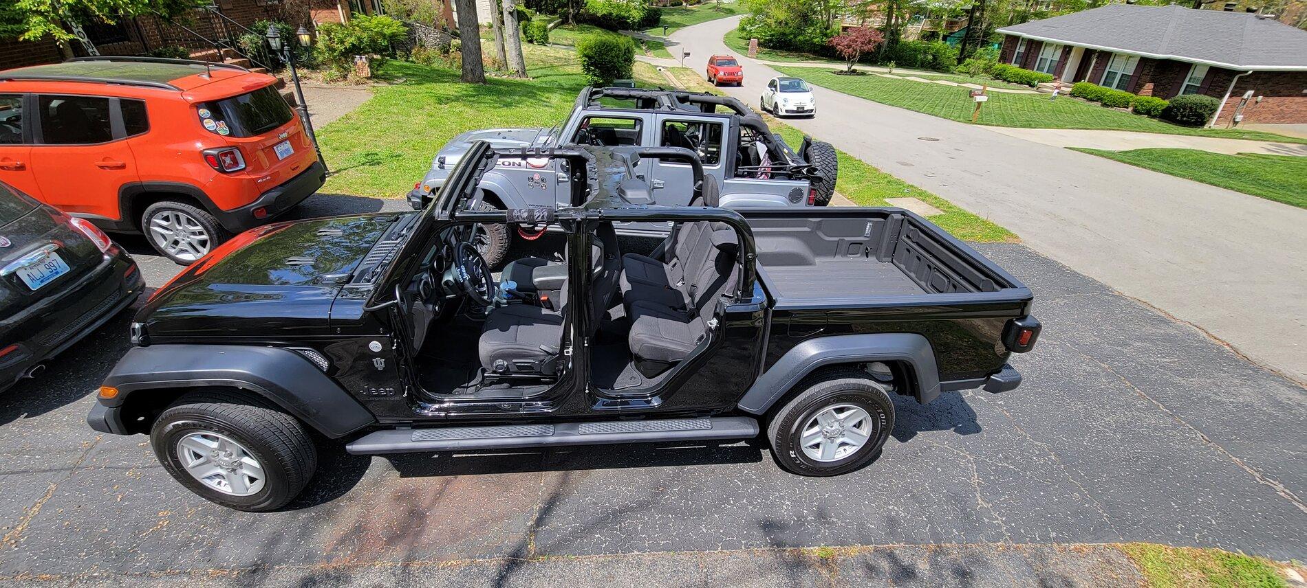

I installed this kit. No problems, the instructions are a bit lacking, but it's a pretty easy lift to install so it wasn't a big deal.
Some advice: make sure you loosen the upper/lower control arms on the frame and axle, especially in the rear axle. This will drop the axle enough to slide the spacers in.
