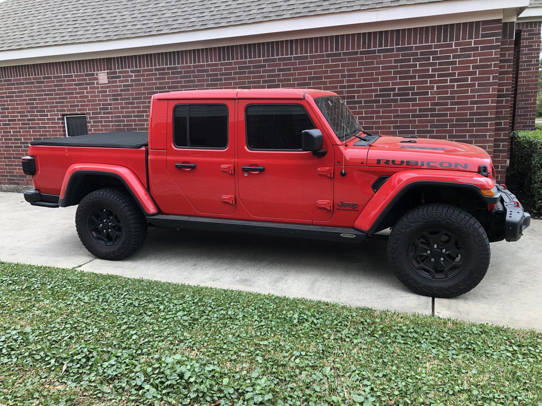

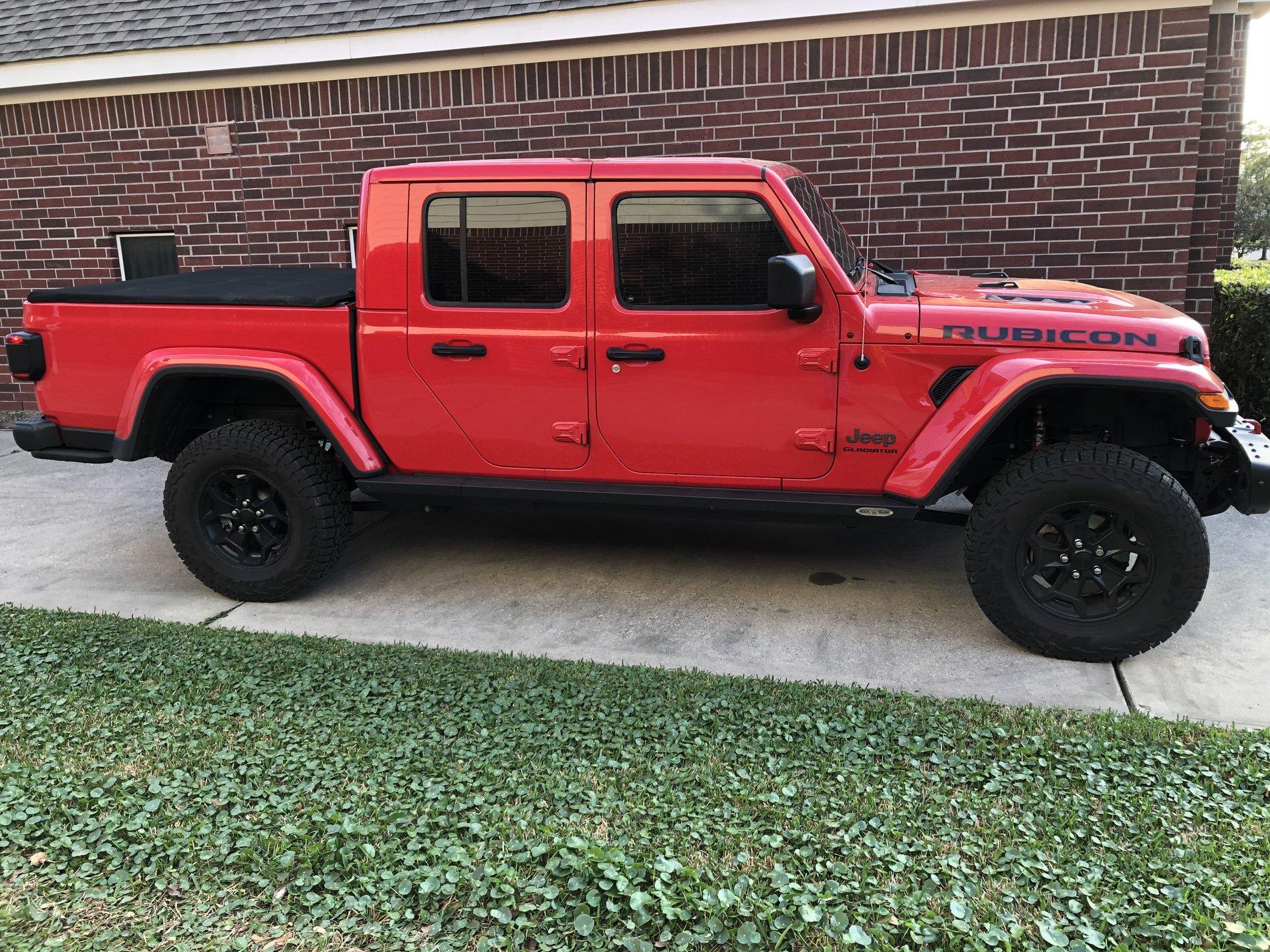

I went with the AEV spacer kit. I like it just fine. I have the AEV 3.5” DS on my JKUR and love it. I really don’t need more spring on the JTR. It has the articulation I need. The spacers raise the belly enough for me. The JK needed more lift, so the full kit was needed. I like my JT Rubi springs and shocks and didn’t like the idea of tossing them.. I’m happy with the choice. Good luck with yours.
Before and after shots with stock tires and wheels. Bigger tires coming when I spot the next good sale.
Sorry to dig this up. Is the AEV kit 2” front and rear?
‘I did not measure closely. It seems very even to me. I was after an even 2” to give a bit of clearance for 37” BFGs. I was not wanting to adjust the rake. This kit gave me what I wanted.
