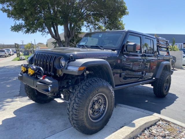

Is there a concern as far as safety/functionality goes with the AEV dual sport lift on 33s? Is the only issue less clearance and looking like tiny tires? The goal would to be eventually put 35s or 37s on but can I do the lift with 33s until then without problems?
No issue at all with running stock sized tires. Some say it looks good, some say otherwise. Personally, I plan on running this lift with the stock tires for as long as possible. I have 37s for the dirt but I want to retain the amazing fuel economy this diesel is getting me (27.5+ average) so it wouldn't make sense to drive on 37s all the time. So for me when I want to go play I'll just swap wheels and tires then come home and swap back.

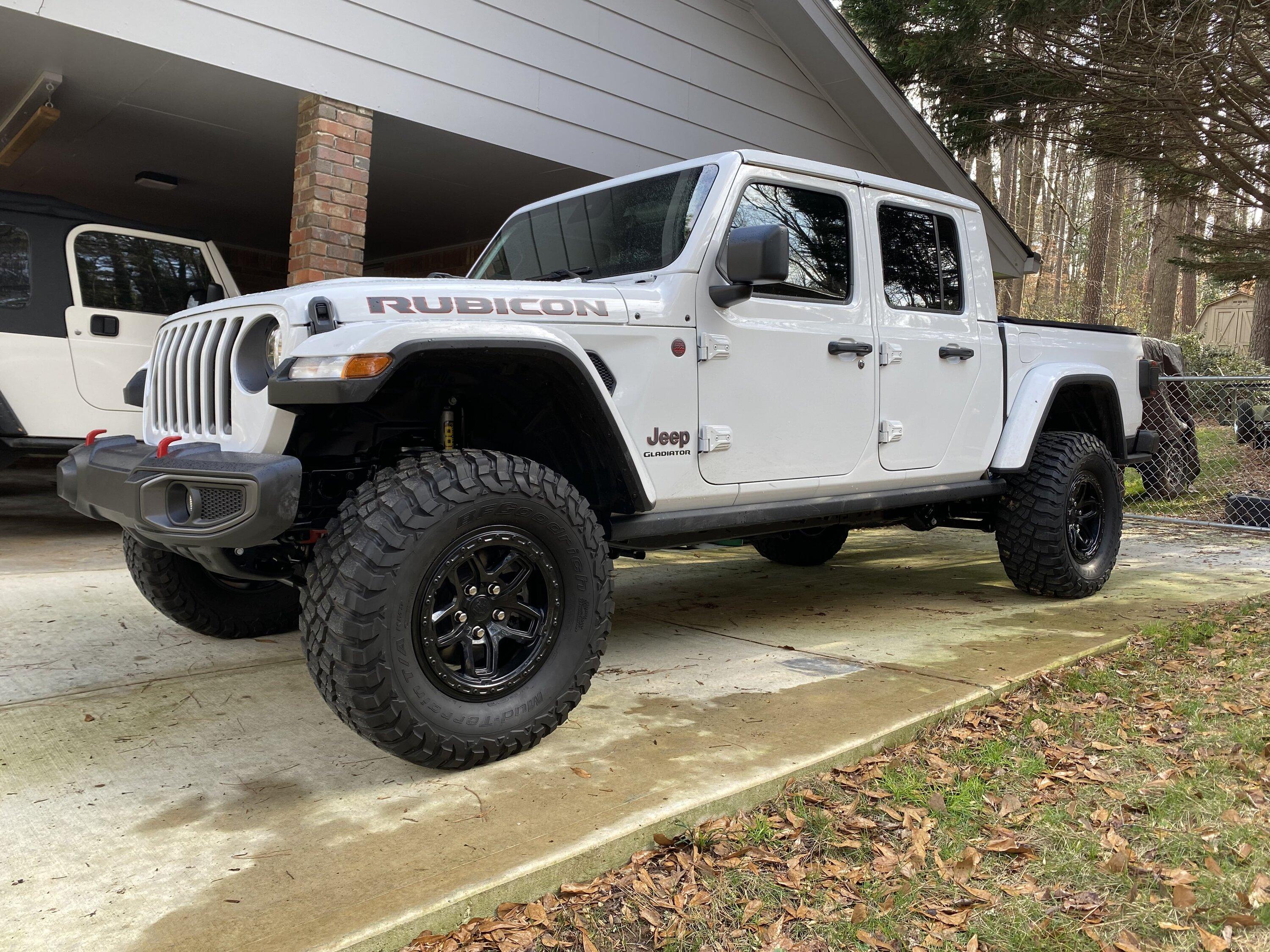

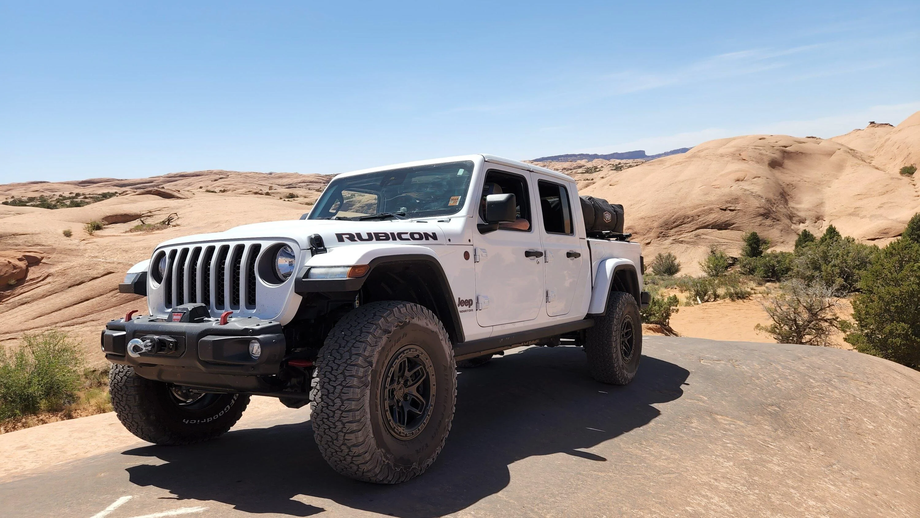

So far I enjoy my AEV kit. Yes, there is more rake to it, but towing or hauling anything in the bed helps that out and doesn't make it nose high when doing so. And I have not had any issues yet with having rake and making it over obstacles, lol. Here are two pics with a Rubicon with the 2.5" DualSport lift. One with 35s and one with the final 37s:
Jeep Gladiator 2" mopar lift vs 2.5" AEV Dual Sport IMG_2988
Jeep Gladiator 2" mopar lift vs 2.5" AEV Dual Sport 20220608_143648
On a sport model I think the 33s would look a little small. 35s might fit the bill nicely and be a sweet spot with the lower flares. 37s may have some rubbing issues where you may have to adjust bump stops. I know fully flexed out my fronts clear the rubicon flares, but not by much.
You said the AEV has a rake but in this picture it looks pretty level to me.
