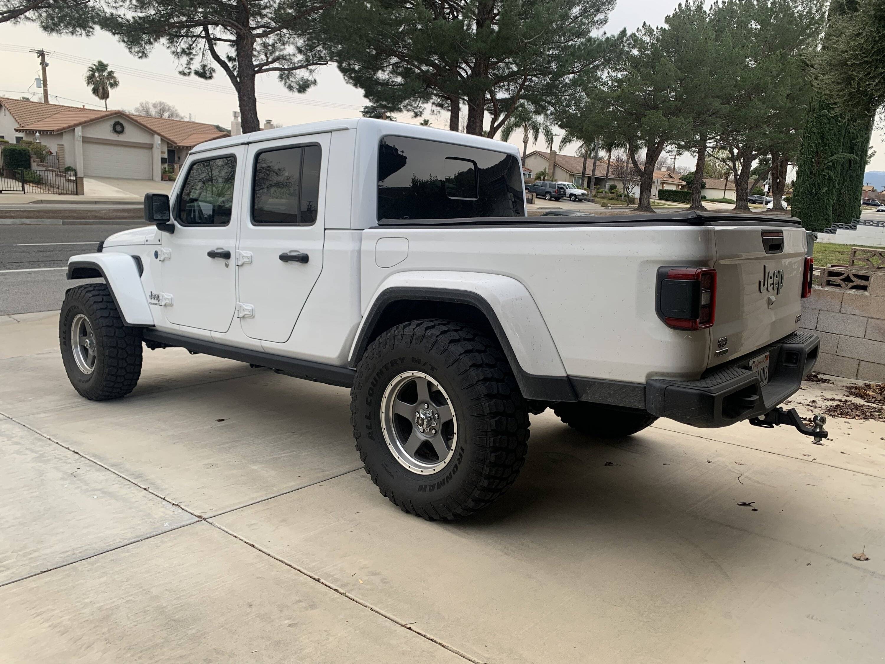

I bought a cheapie off Amazon for something like 78 bucks. Came with spacers, hardware, sway bar links, and shock extensions. For the rear I bought a set of 3/4” spacers and nothing else. I think they were 28 bucks. Does everything those expensive ones do for 100 bucks and I run 37s all day on an Overland.
Jeep Gladiator AEV 2" Spacer lift VS TeraFlex 2.5" Spacer lift B942C707-5463-4124-99BD-F212F5ACD294

I gained exactly 2.5” in front and 3/4” in rear… they’re just spacers. Spacers don’t lie, if they measure 4” tall you’re gonna get 4” lift.

I’m actually changing all of it very soon, but only because I want more lift. I’m going with a 4” full suspension kit with control arms and all that good stuff.
As far as rust goes, I’m in Southern California so hard to say, but we did have some pretty solid rainfall this season and I’ve had no issues with that. As for the spacers themselves, I believe they’re polymer so naturally that’s not going to rust.

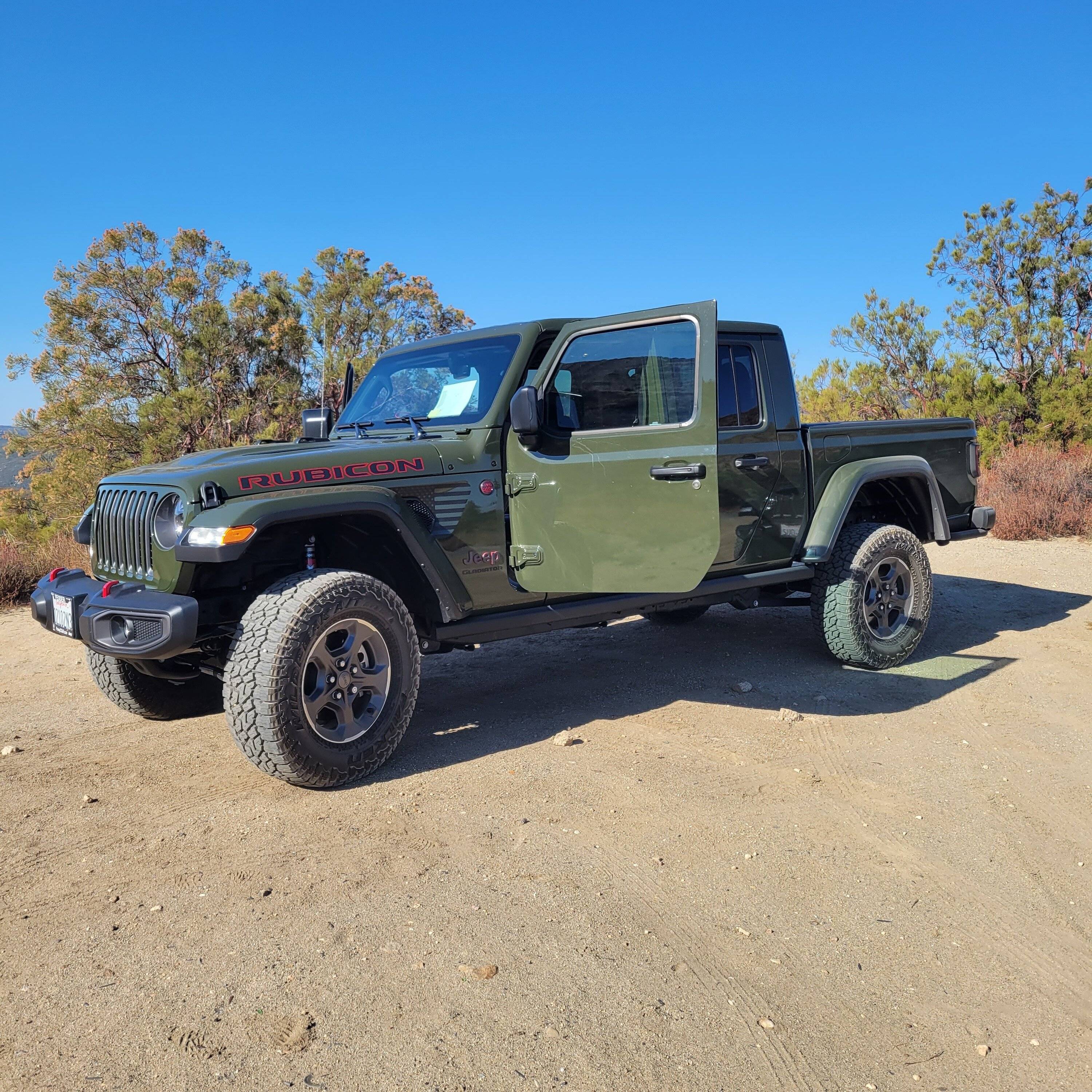

I put the Teraflex spacer lift on my 2008 JKU Sahara. and did not have any issues and liked the ride. I have installed the AEV spacer lift on my 2022 JT Rubicon and love it. No changes in ride. The AEV is the more expensive of the two but am happy as hell with the quality of the product. I took the Rubi to the dealer and had them re-torque the UCA/LCA's to spec outlined in the AEV kit.
Jeep Gladiator AEV 2" Spacer lift VS TeraFlex 2.5" Spacer lift Rubi 1
