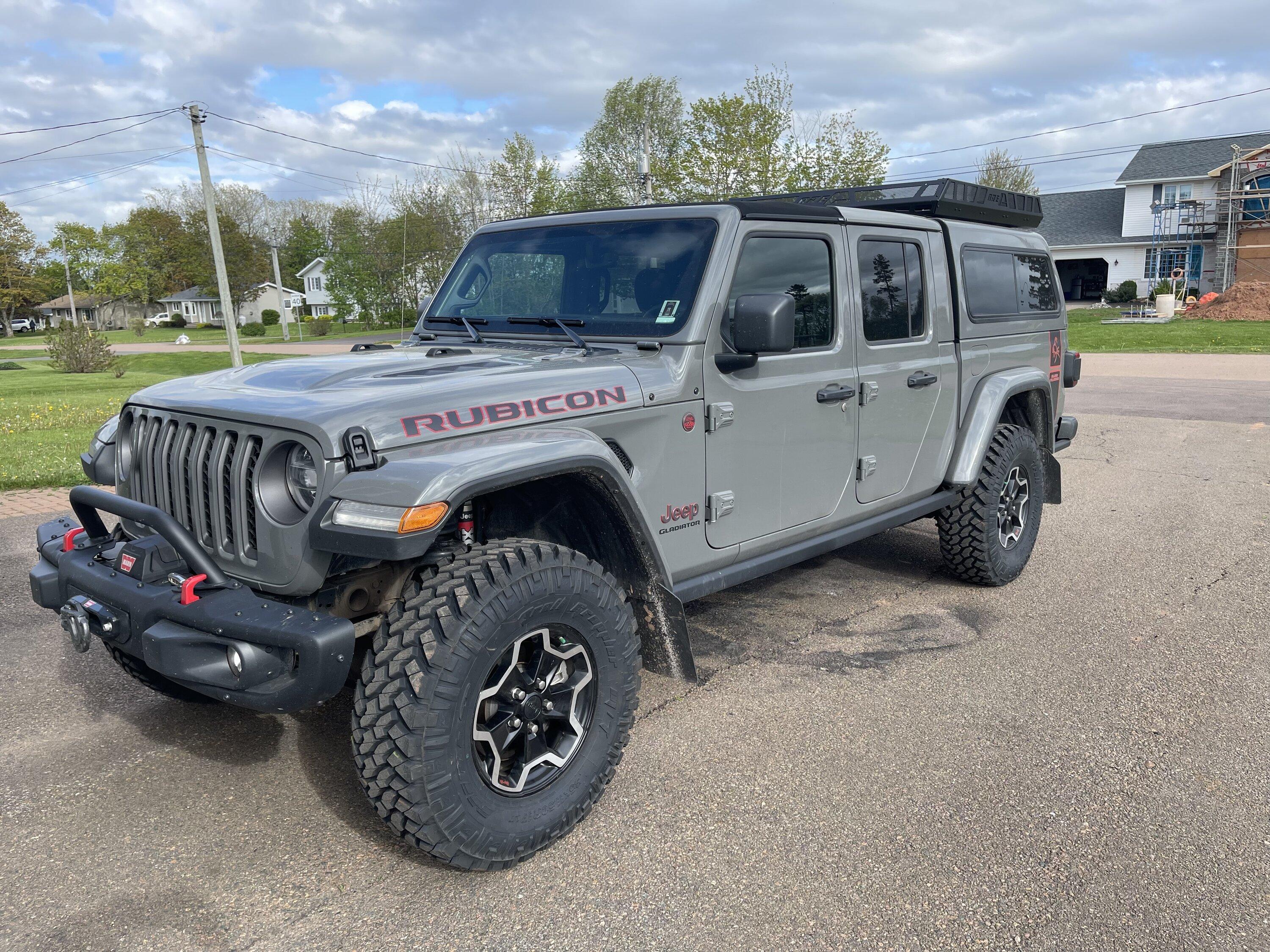

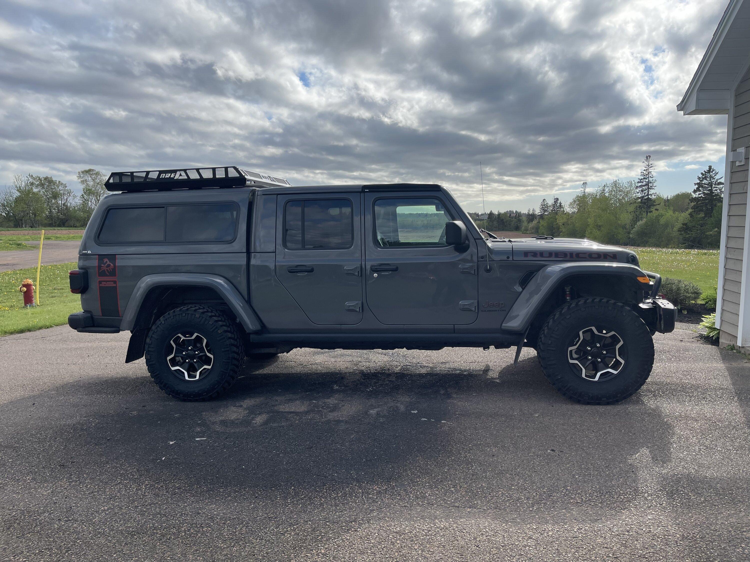

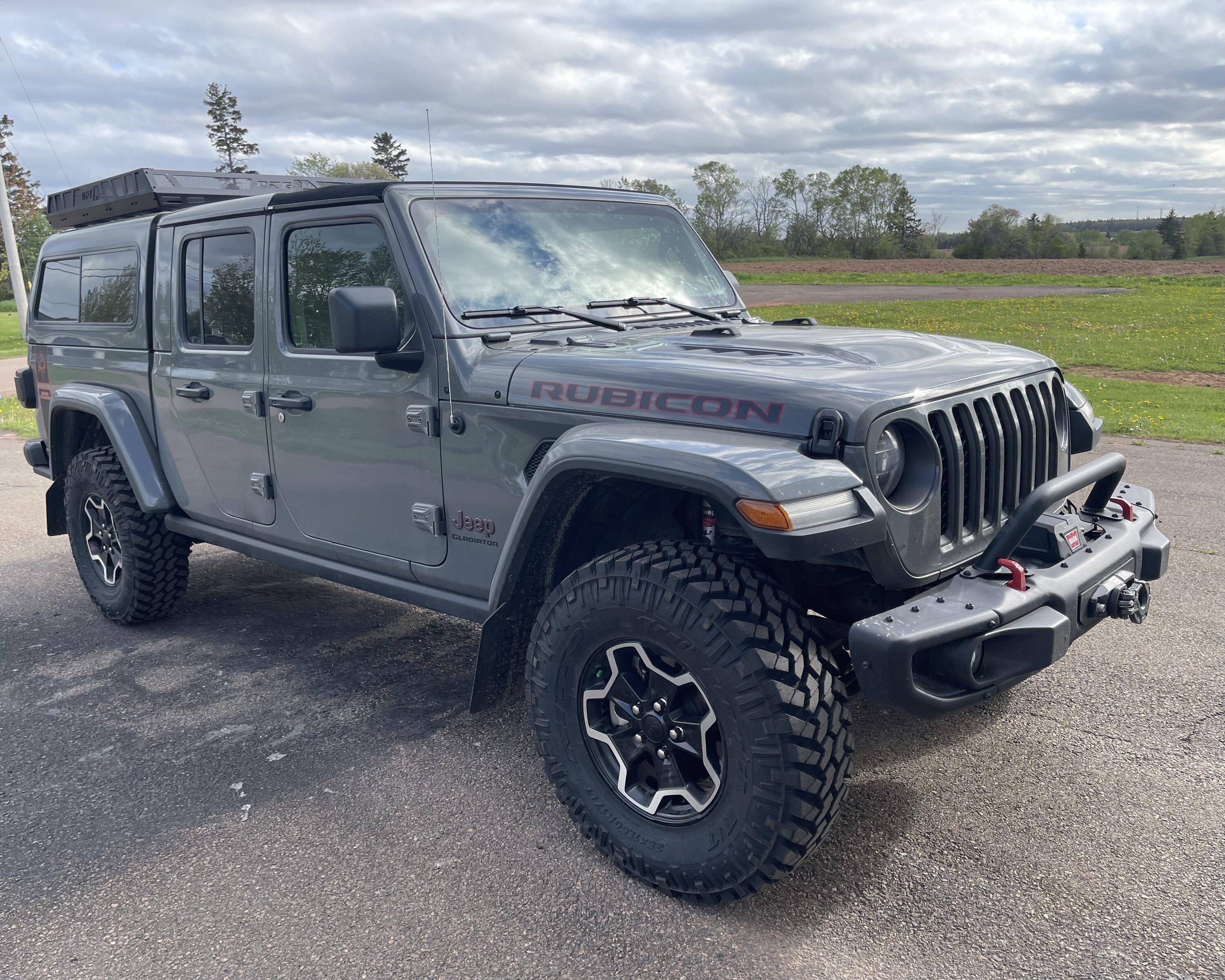

No brackets, I went with the Mopar lift lower control arms. Preferred that option. No wander at all. I did replace the front damper for the fox unit when I first got the jeep.
So you have the MOPAR lower control arms, but the AEV trac bar brackets and AEV 2" springs?
I have the
AEV 2” Lift
Mopar Lower Control
Rubicon Express adj front and rear track Bars
Fox Steering Damper

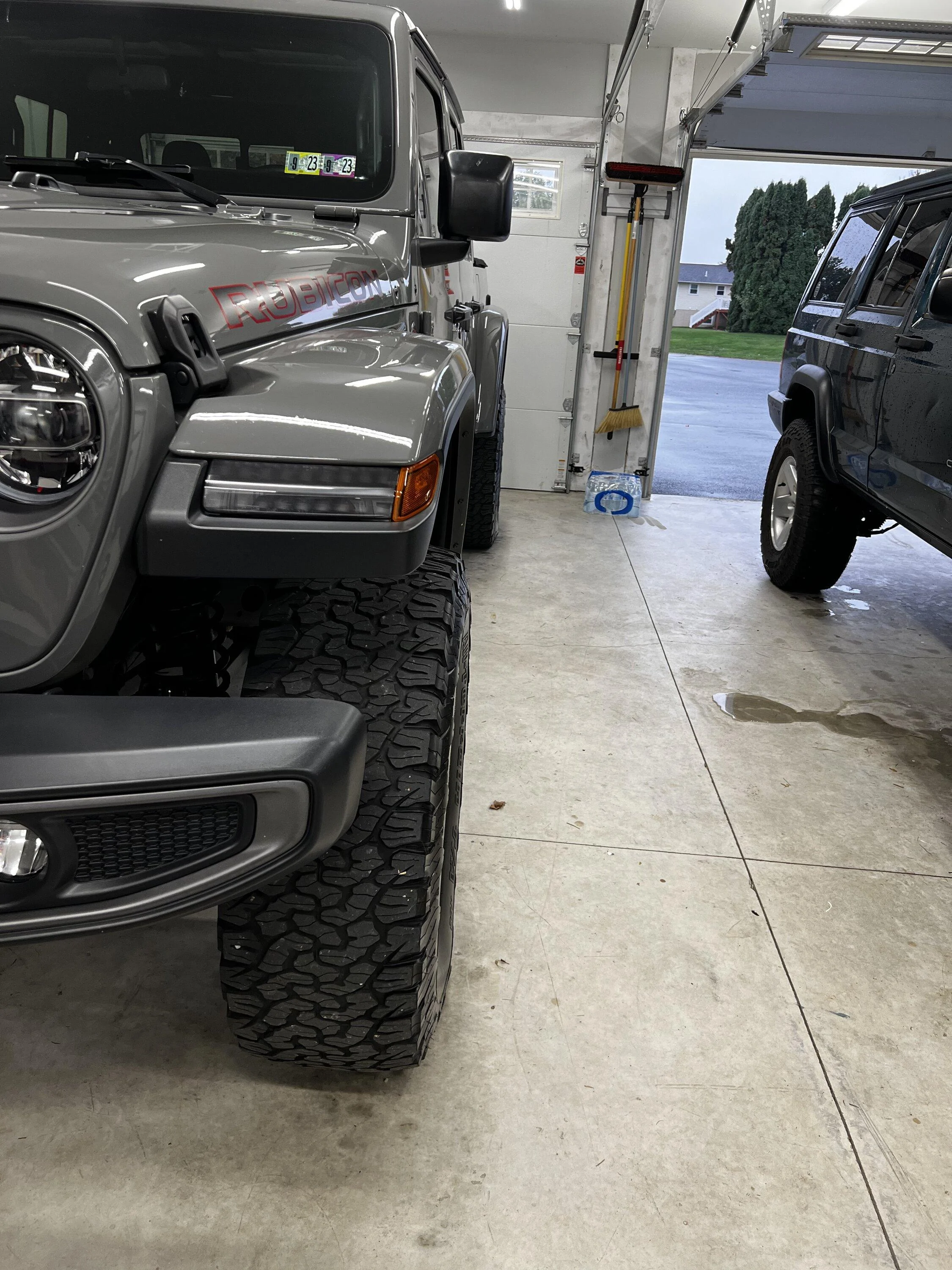

I just put the Mopar lift lowers on. I have a’22 sport and I put a full Rubi suspension on it. I have the Teraflex 1” spacer up front to eliminate the rake. I put 275/75’s on it. Debating wether or not another 2” will make the tires look small. Most likely yes. Was just curious if you‘ve had any problems with driveline, track or anything like that. Thanks for the info!

It drives great! No drive line problems at all. I actually wanted to keep the factory rake, that’s why I went 2” all around. I have new wheels in my garage…been waiting 8 weeks for the 37” Nitro’s to get here!

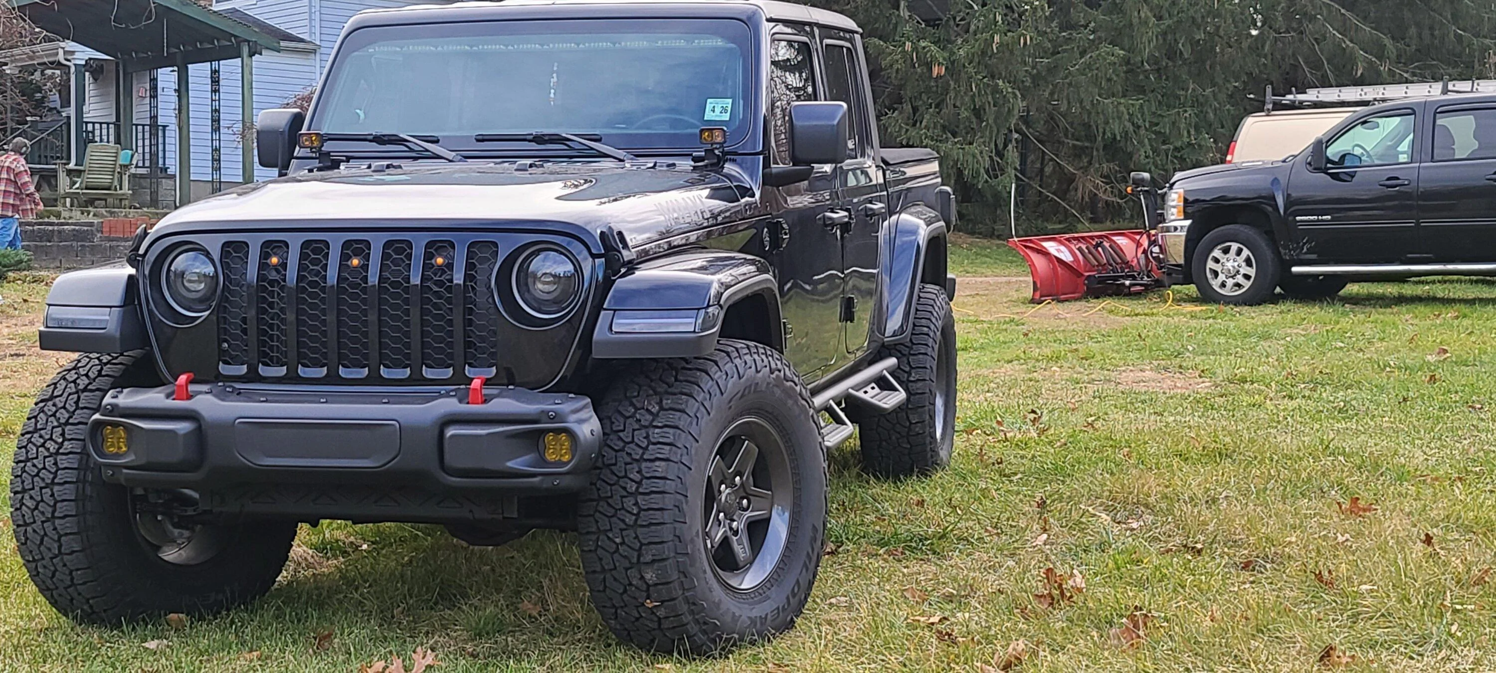

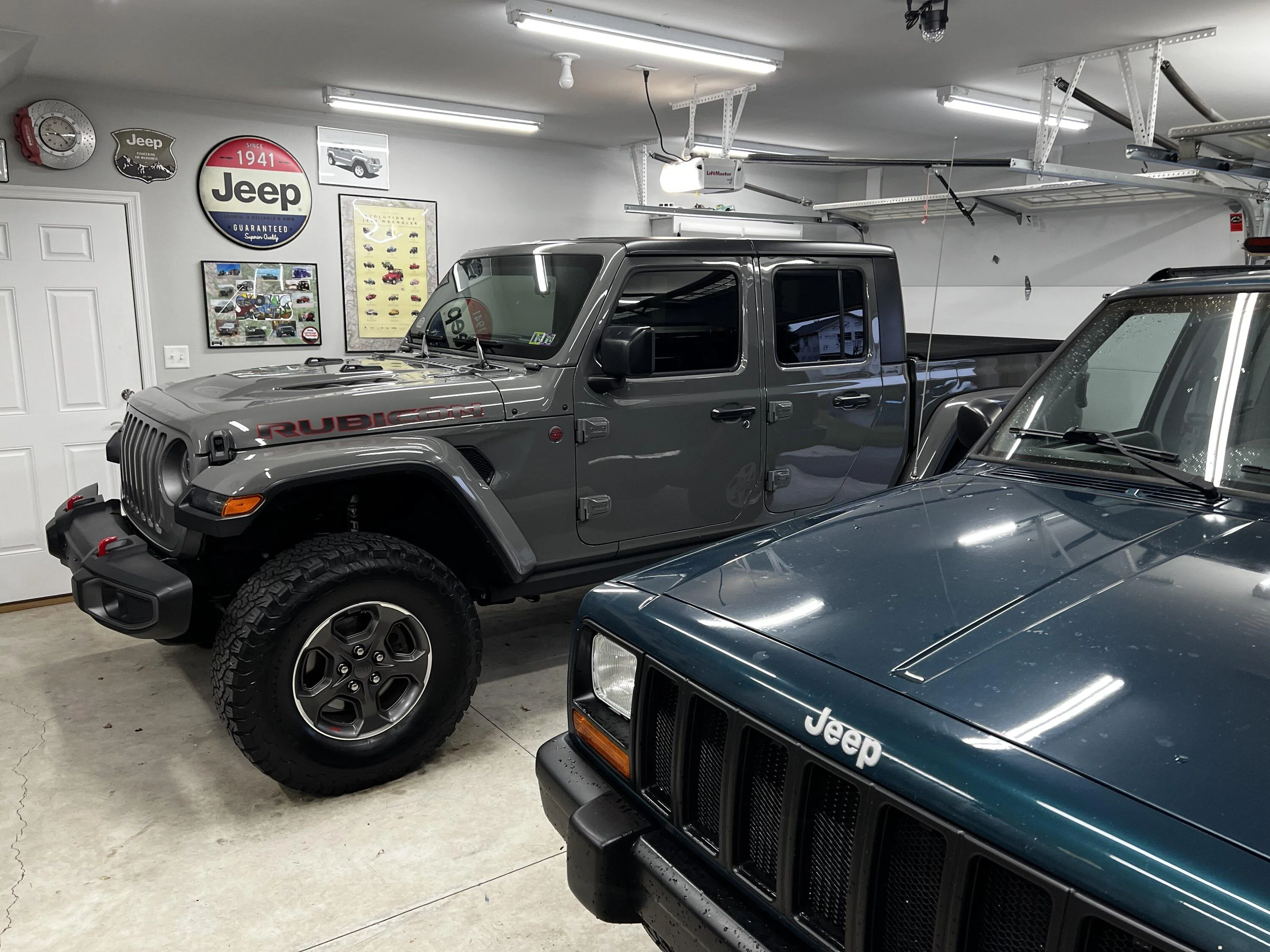

Jeep Gladiator Rubicon AEV 2” Spacer Lift on 35s 20211204_145339
Jeep Gladiator Rubicon AEV 2” Spacer Lift on 35s 20211204_150301

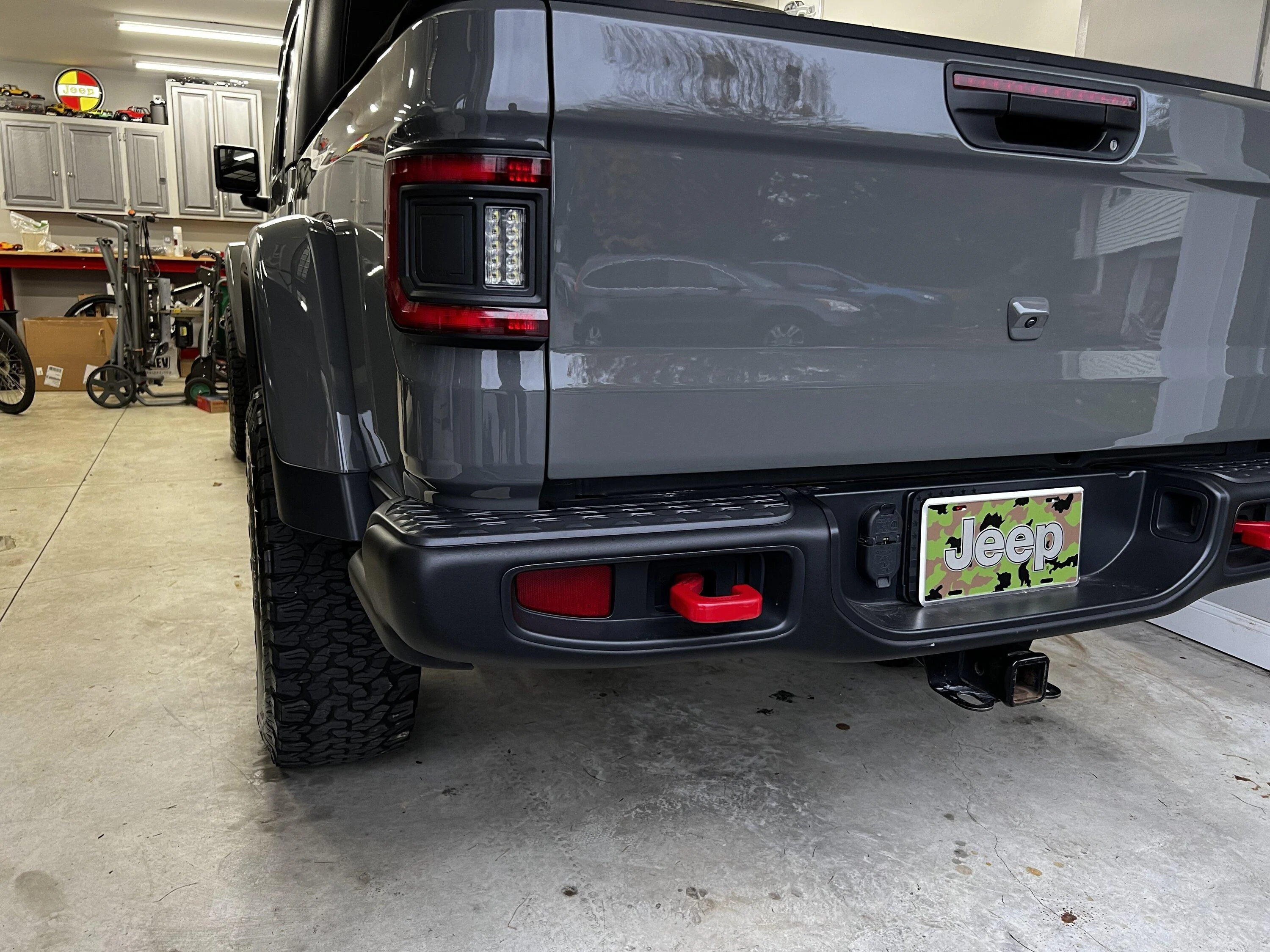

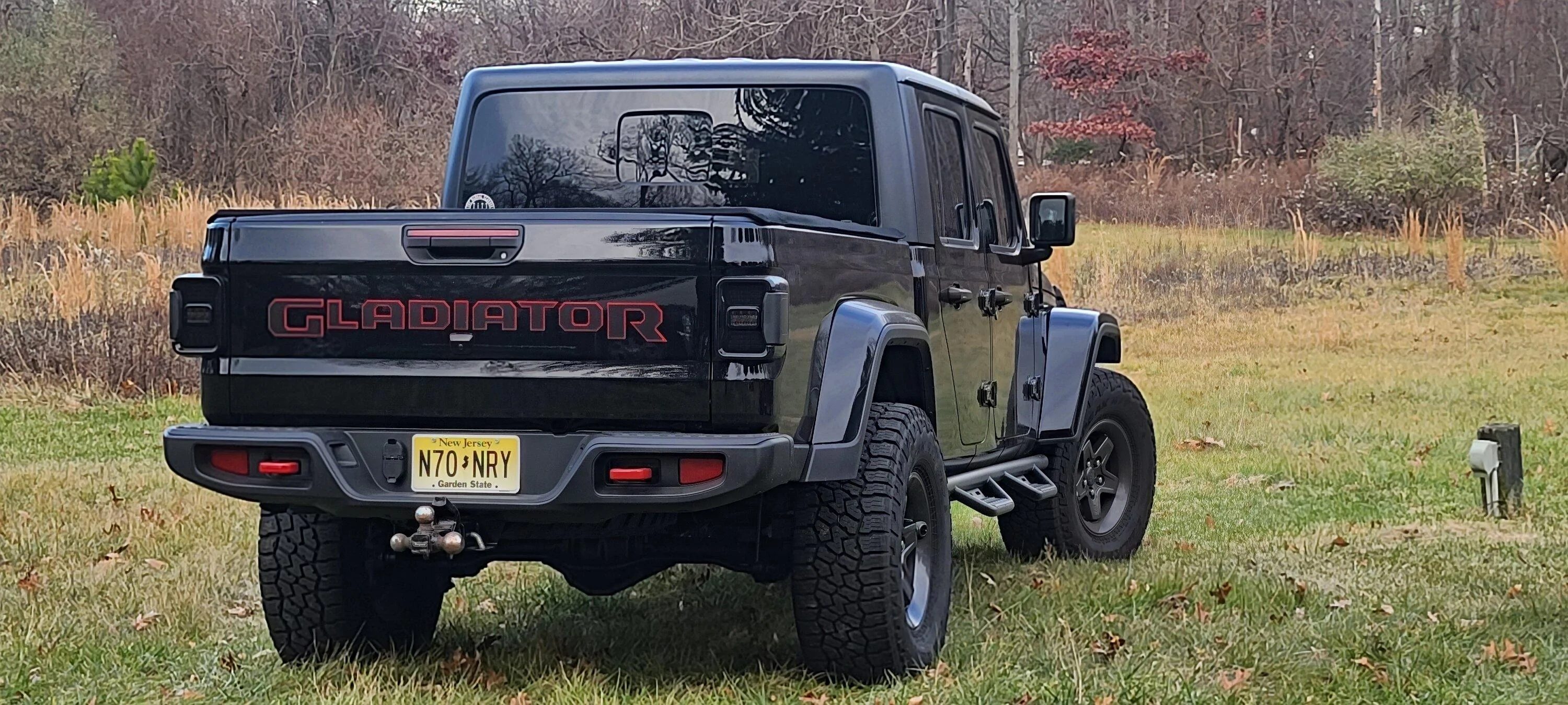

2 inch aev spacer running 35x12.5x17. No issues. Running rubicon shocks with the shock extensions provided. Added a teraflex front track back because the front axle did shift a bit.
