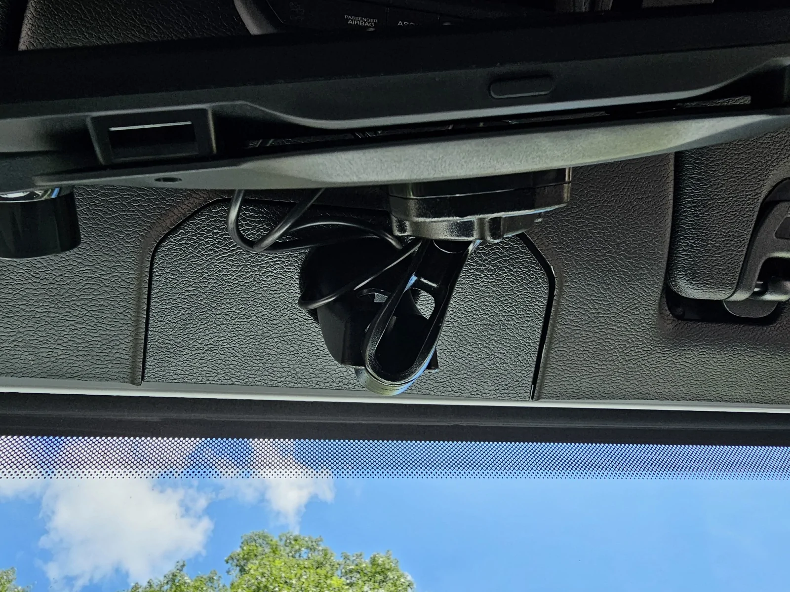

Do you have such an animal available? Looking for a plug and play kit for the mirror which works with the factory visors? Maybe the factory rear camera? Plug and play to the factory wiring? Must I modify every single part of the system?

They don't make a Gladiator specific or ready kit. They will try to sell the G900 Triple, but it's not an ideal fitment and interferes with the visors. Your best fitment is going to be the G930, but it's only a two camera system and doesn't utilize the newest cameras with USB-C connections. It still works great though. IMO this is the best fitting option. You'll need:
G930 Mirror
Hardwire kit
Type #1 OEM mount for the G930
Type #179 OEM mount for the G900
Wolfbox doesn't make a OEM mount for the G930 to fit a Gladiator, so you have to combine parts from two kits. (which is stupid IMO since it's literally marketed as an option for vehicles that need a smaller mirror, but then that doesn't help sell their flagship G900 Triple model. Thats a rant for another time)
You'll take the mirror mount plate from the #1 kit, and pair it with the arm from the #179 kit.
The G930 will still get in the way of the drivers visor, but you can mitigate this by either installing washers to lower the arm base, or if you're handy with a file you can clock the arm towards the passenger side like I did in this photo. I can take more photos of what I did if needed.
G930 Mirror
Hardwire kit
I would love to see more pics of this
TIA CapnCking
TIA CapnCking
Sorry, just seeing this now. I'll get some more pics and post em up. I also need to do a write up on how I added a trailer connector to run a camera on my camper.
